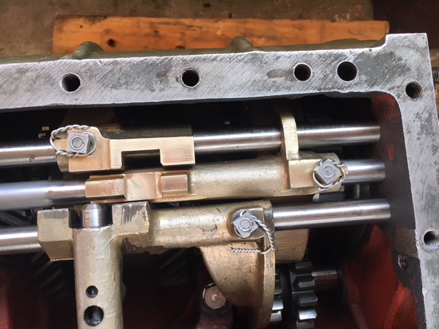

Consider drilling and safety wiring all your drain plugs--diff, engine, transmission. It is mandatory on race cars for a good reason and there will be one less thing to obsess about!
OK, I can't for the life of me see how you can safety wire the diff and gearbox plugs; they're recessed and if you drill you'd likely go through threads. I've never heard of one backing out, as I believe they're pipe threads and you can torque them down pretty tight.
Bob--
There is enough thickness on the face of a plug to through-drill a small hole in at an angle into which you can insert the wire. Some plugs stand a bit proud of the surface of the housing and they are easiest. For those that go flush when tightened it may be necessary to drill two angled holes so they meet and allow the wire to be passed through. Finding a place to anchor the wire is easy and on diffs I use an oval or oversized washer near the plug and drill a hole through that.
Needless to say, drilling out the plugs should be done with them off the car....
Probably not necessary on a street car; at least, I don't lose any sleep over them falling out. Presume you use stainless wire? What thickness of wire do the tracks specify?
Bob--
It's probably not necessary on a track car either but it is what it is. I have never seen a spec for either size or type of wire--just that all drain plugs must be "wired"--nor have I ever seen a tech inspector get under a car to check, though engine sup drains are usually easy to see from above. Personally I enjoy the exercise.
I built this engine for a guy that races, and asked him to send me the engine specs out of the rule book__I didn't want to inadvertently get him in trouble...
You know, just to present a visual aid to Michael's suggestion!
