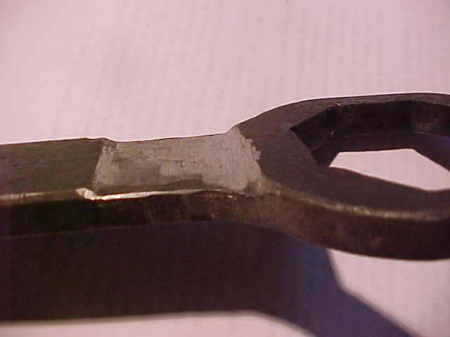

anthony, how thick of stuff, and what kind steel did you use to make this professionalylooking : made tool I am impressed /ubbthreads/images/graemlins/thumbsup.gif
stinky, i used a full 1/4" mild steel,i bought a spare nut from a local vender to use as a template and in the event i buggered up the one that was on the car id have it on hand, the wrench worked so well i was later able to return the nut to the vender $32.00- the reason i used a full 1/4" was so i could make a relief on one side to get it to fit nice and snug to the axle see attc.after tracing the nut onto the metal i drilled holes all around the perimiter just inside the the trace lines then used a dremel with carbide diskes to cut through (use eye protection) then hand filled to exact size, heated with torch till almost a red glow and dropped it into a metal bucket containing cold water in an attemt to temper the metal, it sounds and is labor intensive but i just wanted to do it and ill always have it to remind me of my dear friend keoke. /ubbthreads/images/graemlins/grin.gif

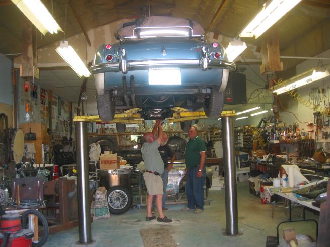

having two heads,four hands, and at least two feet in there while flailing away inside the fender well with a lump hammer.
[/ QUOTE ]
Unless they are Marion Brantly and Bill Bolton. See pic /ubbthreads/images/graemlins/devilgrin.gif
