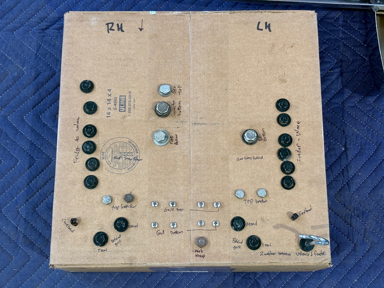

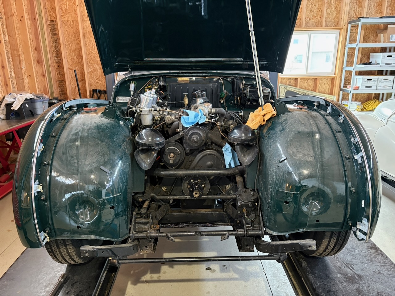

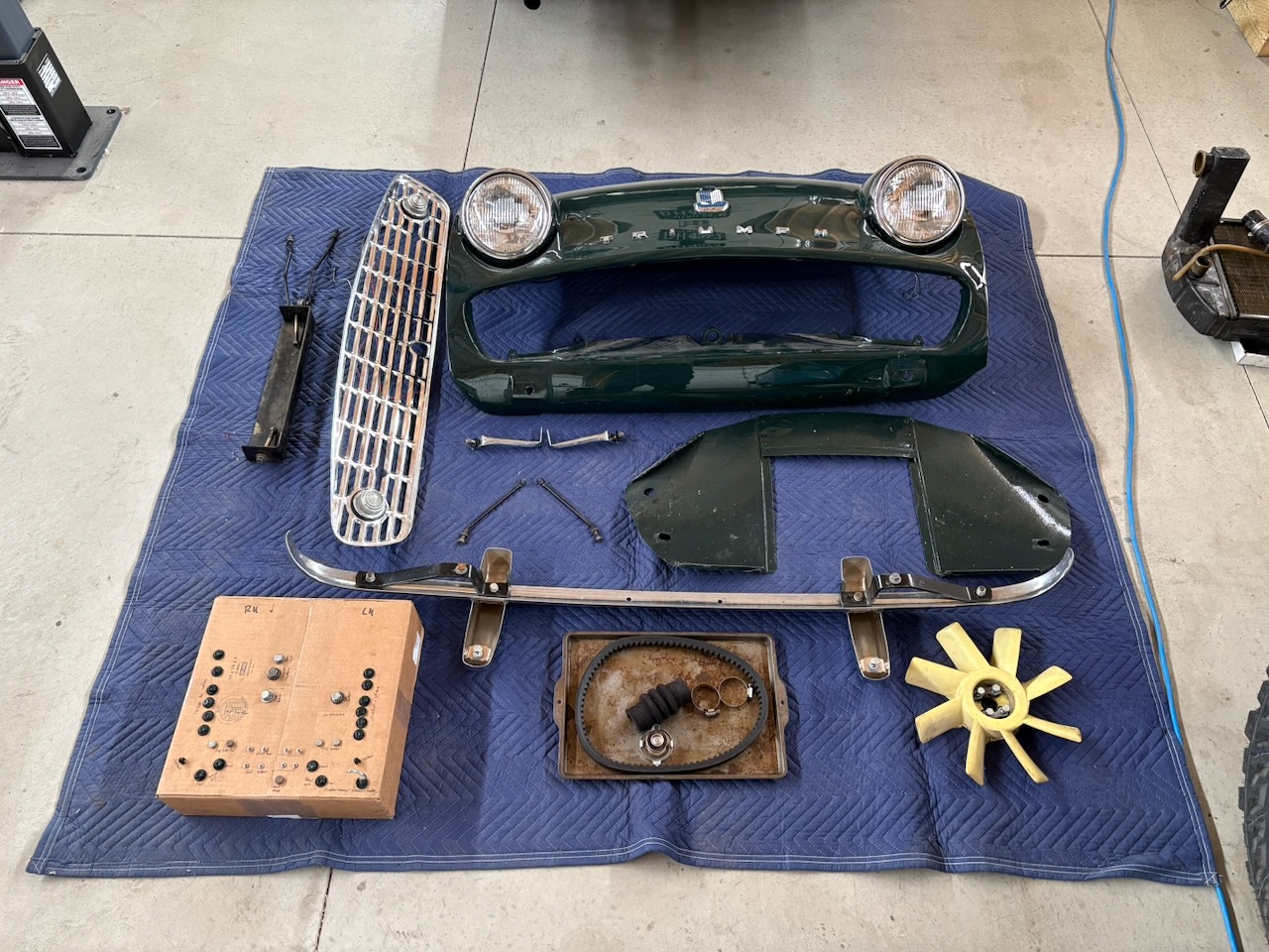

When I bought my TR3A I knew the radiator needed to be replaced. Finally had some time and was able to get the front valance off with the help of a local friend and Triumph guy. I've got a new Wizard radiator and Macy's Garage hurricane fan in hand, and will order new radiator hoses and a new fan belt.
What else should I look at while the car is like this? Car was restored 10ish years ago (quite well) and has been used lightly since. I know I need to work on the brakes (they pull to one side, can't remember though which side), but what else is worth digging into while it's more accessible? I certainly don't want to pull that valence regularly!

I did the same project last year with a new rad and had done the Macy Fan prior to that. I agree with Hamish, perfect time to check your steering box. Also great time for a detailed cleaning of the engine bay. Car looks very good and your parts, bolts, placement shows you are a detail person. Well done.

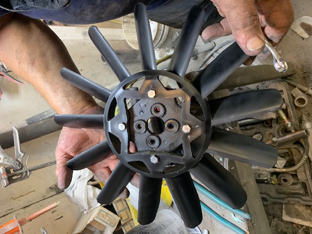

I hate electric AM fans. A tr3 has a marginal amount of watts to spare and this is IMHO
not a good idea. I have converted dozens of Tr3's to Tr7 blade fans over the years and it is the
easy ,cheap, and super effective. Why add potential problems in a spot so hard to access???
The risk with an alloy rad and the 13 blade is overcooling if the thermostat is bad/incorrect.

Do you have a link to the process of fabricating that TR7 fan modification? Are those rubber grommets readily available? Karl

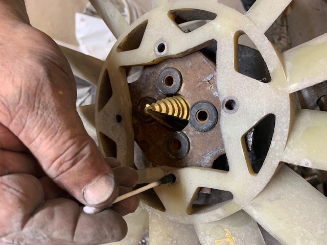

That yellow fan looks like a TR6 fan. Was it mounted backwards to gain clearance?
No idea — I assume that was installed when the car was restored. It will be replaced with the Macy’s Garage hurricane fan. That’s an improved mechanical fan, I’m not switching to an electric fan at this point.

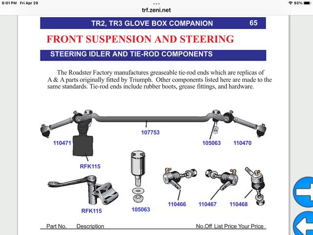

What is a silentbloc? Learning all sorts of new things with this TR3 that’s for sure.

Those are the pivoting bushings that attach the steering drag link to the gearbox arm on one side and the idler arm on the other. When they wear out they will cause all kinds of steering play.

Silentblocs, 105063 from our friends at TRF.
