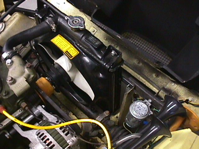

But I do have a picture of the Geo rad, everybody is welcome to come over and see it on my computer or in my car cause I can't figure out how to post a picture.
You found it, heh. not in the quick reply, in the regular reply.
could you please measure it? (approx) It looks as though it sits higher than a regular rad. Is this so? How is that for hood clearance?
Looks like the same height from here. Look at the water hose.

Top hose inlet is drivers left so u have to o-clock the thermo housing. The bottom outlet is too far inboard and might need surgery or a "s" hose.

No mods at all. Direct drop in with a L brackets (Ok there are the mods)
Stock downflow hose fits perfect, cross flow upper hose fits perfect but you do need the later t/stat cover that points left but that is a direct bolt on too.
Fits, works, cheap at the junk yard and comes with an electric fan.
I did mine for $25.
