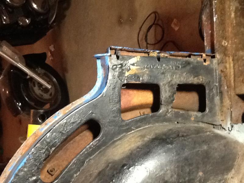

Yes those decisions are difficult. I could have purchased a real nice taken apart project car for 5K that sat since the 70 ties, but reality set in what a pain. Anyways, I cannot tell from your pictures yet how your sills are. The sill does not look too bad under the door. Is that one picture the front of the sill next to the A post on the driver side foot well with the A post missing the bottom 2 inches? If so, leave the front clip on there until you know for sure the condition of the sills. And maybe post a picture of the inside sill by the foot well. The section where the posts are on the sill is significant also because the A & B post get welded to the sill there. I guess you could patch the top of the sill there if you have good meat down further. How is the trunk section on the car?

The sill between the "A" and "B" post for most part is solid, rust is forming where the outer sill rotted away and crap collected, and under the rear fender, the sill is rotted away for most parts, I'm starting to lean towards a inner and outer sill replacement, as for the trunk floor there is some rust/rot thru it but I'm not sure as to what extent that is yet, not looking there just yet.

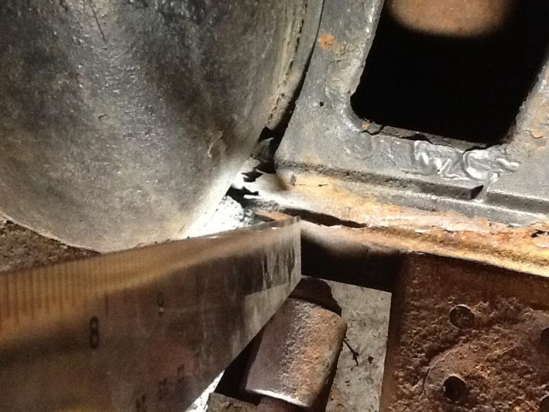

Waiting to hear back on my offer on some inner sills, I've started to some more fitting/welding. Now on to some more questions, the inner quarter does the panel go down and under the floor?,welded to the sill? On top of the floor? With what I have left I can not tell, and I can't find a good picture of one.
The ruler is pointing at some rusted metal that looks like it's part of the inner quarter or some previous repair not sure which. Or is it the floor pan? Or????

The floor is tacked to the inside of the inner sill.
The inner quarter laps over the floor and is spot welded to the top of the floor. So, to replace the floor you have to pry the bottom of the quarter panel up, and the fold it back down once the floor is in.
Awesome, that's what I thought, pried it up and out of the way, now I'm trying to get the replacement floor into place. It's fitting better now that I've done a tiny bit of trimming. I won a set of sill on ebay, so they are on there way up. It's now just how much fitting will I have to do!
