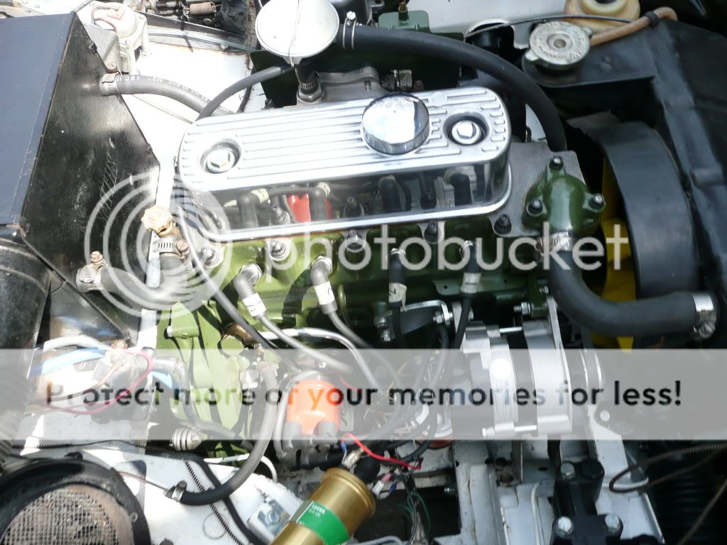

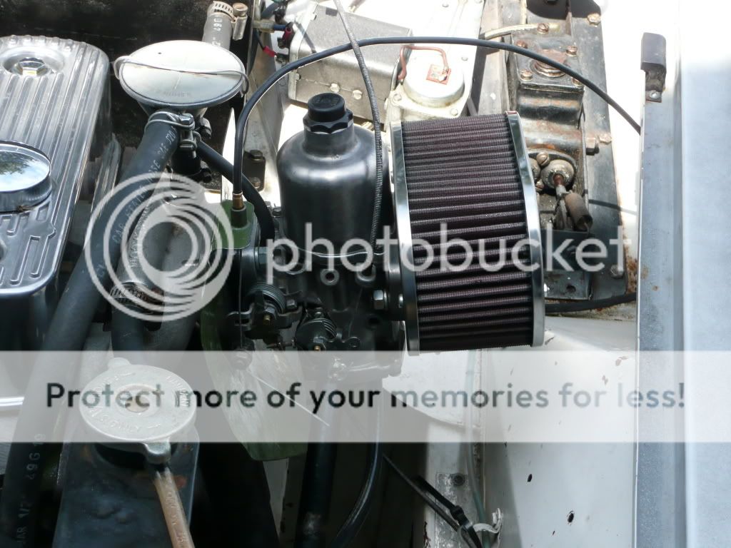

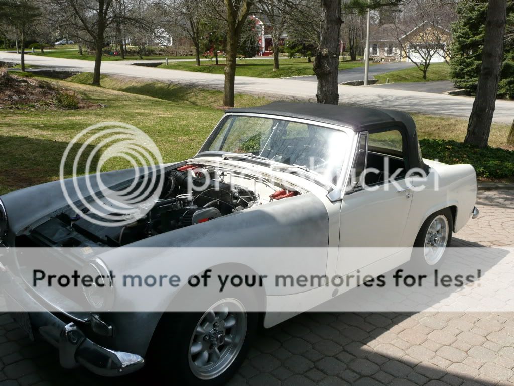

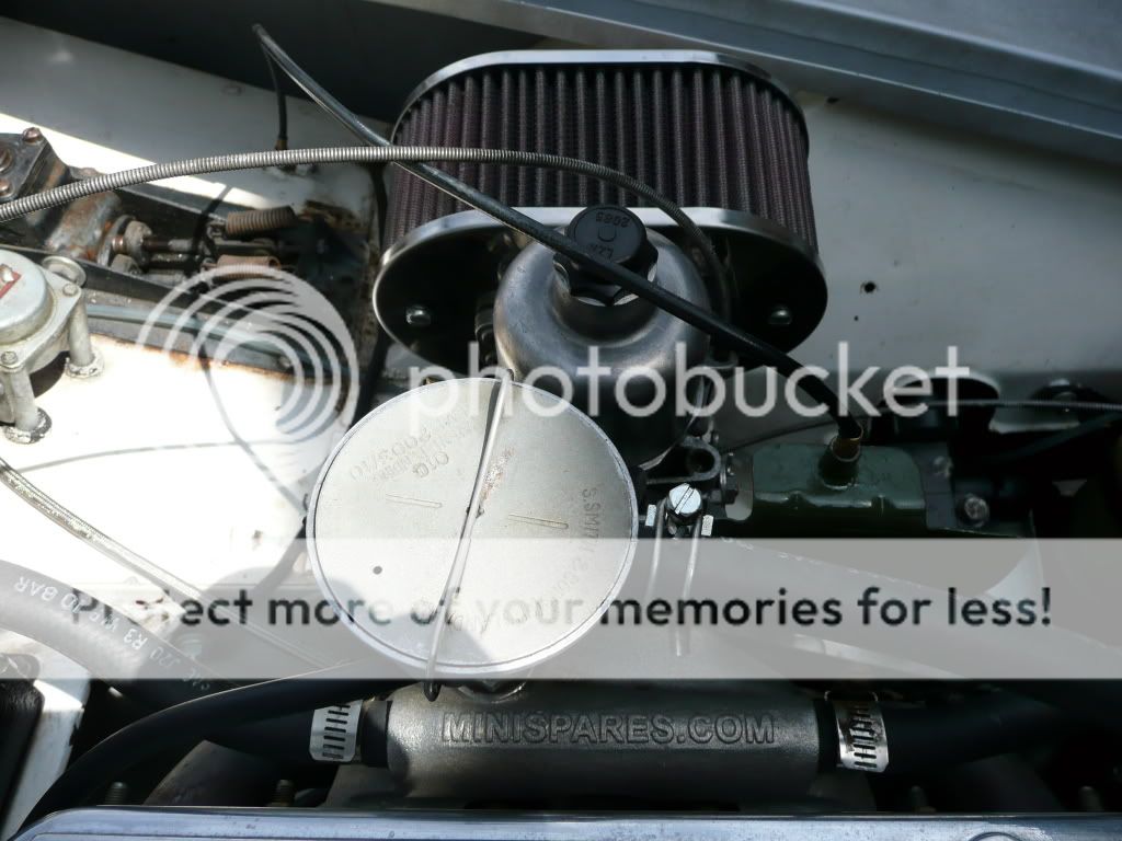

I vote for the HIF44, I searched and searched info on the HIF44 and after about 20 hours of reading, the HIF44 was by far the preferred carburetor. I wanted easy tuning and excellent performance. I am not rich but money was not part of my decsion. I just wanted something simple; it seems the others work slightly better if you are racing or very good at tuning. Someday I may change, only because I think the Webber looks hot. My HIF 44 is a little boring.
Here are some photos of my HIF44 & LBC today.
Cheers Phil
https://i188.photobucket.com/albums/z234/ECAM_2007/P1020164.jpg
https://i188.photobucket.com/albums/z234/ECAM_2007/P1020167.jpg
https://i188.photobucket.com/albums/z234/ECAM_2007/P1020168.jpg
https://i188.photobucket.com/albums/z234/ECAM_2007/P1020172.jpg
That does look very appealing! What does the complete shopping list run for new parts?
The fact that there are cast parts with '.com' written on them inside old cars makes me smile.
I presume you reused your old heat shield?
I found the carb and intake for sale at my local mini classic dealer, not the manifold he normaly has around.It was all on his junk shelf. I purchased the pair and really wish I had bought the HIF44 new as it is almost new after spending too much rebuilding it. If you can do it buy the carb new. The heat shield is just cut down from the twin SU’s, looks ok, when I get to painting my car I am going to make something nicer.
Just three parts
carb,intake,air filter
Phil

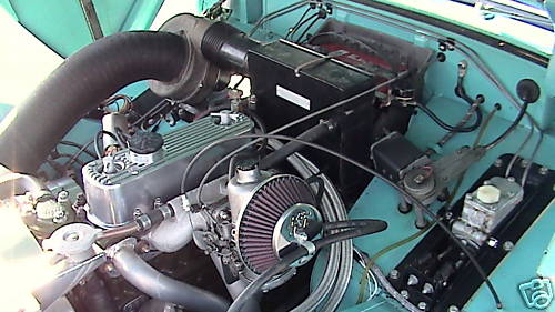

I love the 38DGAS I use on my '72 land Cruiser. Dependable
as all get out. Working great for more than 20 years without a rebuild. I use an electric choke so I can use the truck's choke cable as a hand throttle. Great carb. I once had a 124 Spyder that also had a Weber. Worked great too.
That said, the HIF6 on my BE is da bomb! Very responsive.
I love the sound of that thing sucking air through a K&N above 5000 rpm. :cooler:
