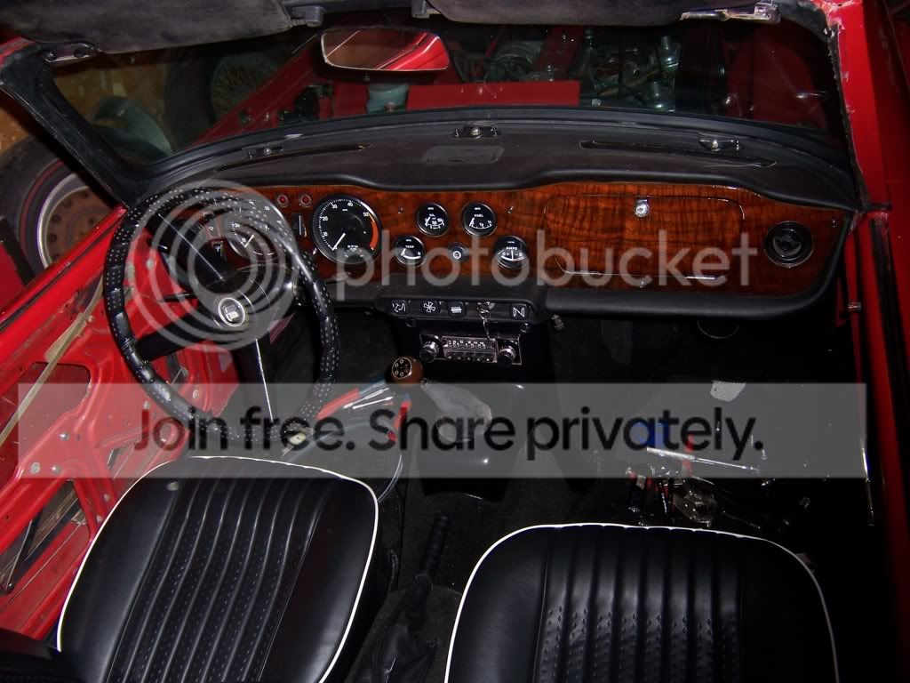

I have made good progress on the TR250 and have some pics, couldn't get any good body shots in the garage, will try to post tommorrow. My electrical question is this, the ammeter seems to be working right, but I don't see any current draw from the starter, lights, horn etc. all make it dip--do I have it wired wrong or is the starter pre-ammeter in the wiring system, so doesn't show a draw, everything works on the car now except the battery won't charge, have a new external voltage regulator on the way.
The shifter console, sprayed with shiny vynil spray, does not match the crash pads (new), any thoughts on a fix, I don't want to spray everything else with vtnil spray, anyway to dull down the shifter console.
Pics below:

Very nice looking. I see that you have a wiper motor like the TR4A's. I had assumed that the TR250 had the newer round wiper motor like the TR6.
Scott
The rectangular wiper motor is listed as original for the 250 in the Piggot original book, the TR250 is not just a tarted up TR4A on with TR6 mechanicals, there is a mix of stuff under there, and a very few things unique to the 250.
The dash was finished by stripping off the old varnish or shellac or whatever it is, a mild cleaning and very light sanding, and then a refinish with clear polyurethane. It got much darker than stock finish I guess from aging.
