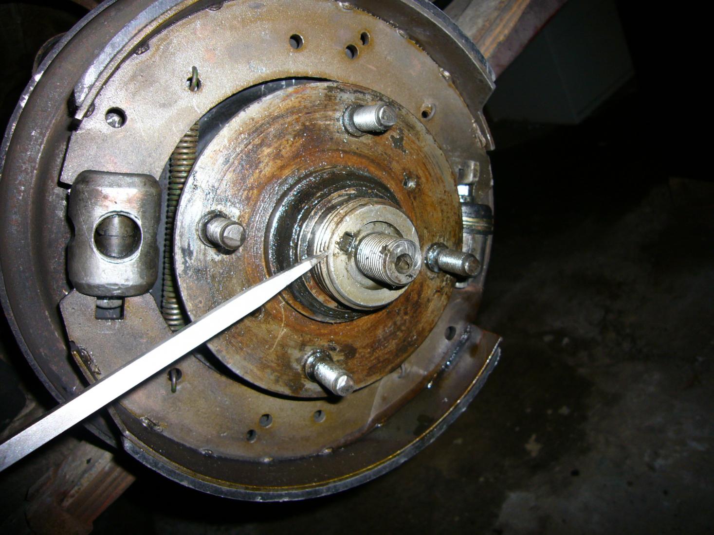

Problem: I am trying to remove the hubs so I can pull out the rear axle assembly. After taking off the brake drum, the manual says to remove a washer and a tapered collar. It also says that if you put a screwdriver in a cut in "the ring," the collar will expand and come off. So it says.
I can't see a washer. Could have been forgotten by a previous owner. But I also can't see where the "tapered collar" comes off the axle. It looks like one solid piece. And I have fiddled with a screwdriver in the "cut" that I think they mean, but short of prying the **** out of it and bending metal, I can't see or feel what they mean. It seems like one solid chunk, although I do expect things to stick together after 50 years. I've tried penetrating oil and some cautious tapping with a wooden mallet, but no go.
Attached is a photo of the situation, with my screwdriver pointing to the "cut in the ring" -- I think. (It's a huge file, but came out very small at this point ....)
This is not an auspicious start to the project. Any suggestions are most welcome.
Okay Talon :smile:
You need to remove the bolts (6 ?) that thread into the hub from the back side of the hub. The hub and a axle will slide out together. To separate the hub from the axle can be a difficult. Very Large press and lots of heat. You can go to Moss Motors web site and find an exploded view of the hub /axle assembly.
good luck
First of all, I suspect you're reading the wrong part of the manual. That's the later "Girling" axle (so-called because it has Girling brakes, not because Girling made the axle). Those hubs are mounted with "locking" tapers that take God's own specially-made puller to get them off without ruining everything (and sometimes not even then).
If you just want to service the diff, then it is much easier to remove the 6 bolts behind the brake plate, and slide the halfshaft out with the hub & bearing housing still attached to it. Keep track of the shims, they are important (although you'll want to check the clearances anyway when you reassemble). If you don't want to disassemble the hydraulics, then use one of the bolts plus a nut that you'll have to supply, to hold the brake backing plate in place. As you can see, I also put a piece of plastic over the end, to help keep crud out of the axle tube:

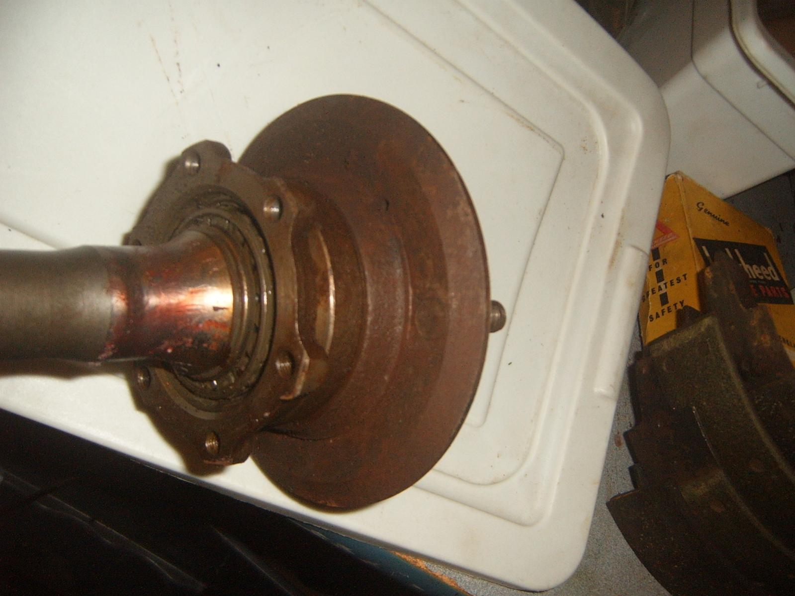

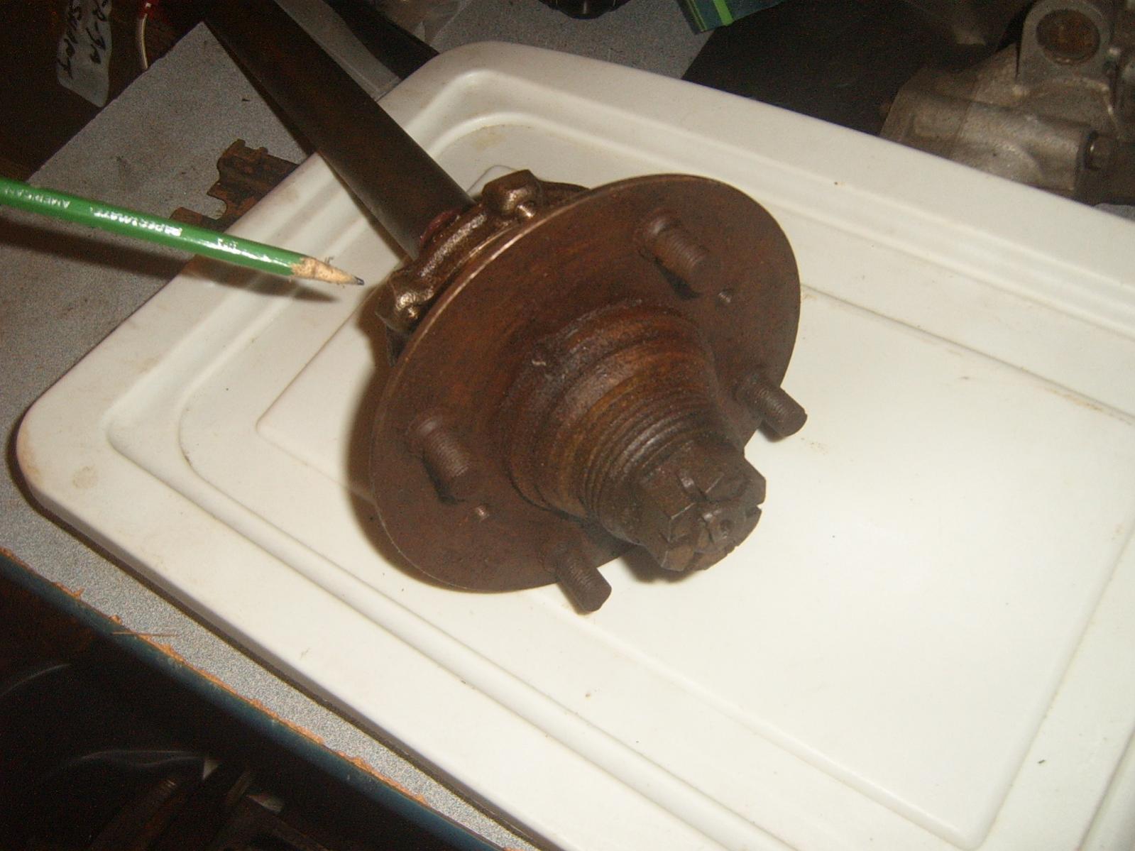

What Randall said. A while back I took apart a 3A diff that was headed to the scrapyard. I need the center part for a TR6 diff rebuild and saved the half shafts as spares for my 3A. This forum has saved me countless hours of frustration, so here is a shot of what you will be puling out. The pencil is pointing to one of the 6 bolts Randall is referring to. Hope it helps - Good Luck!
