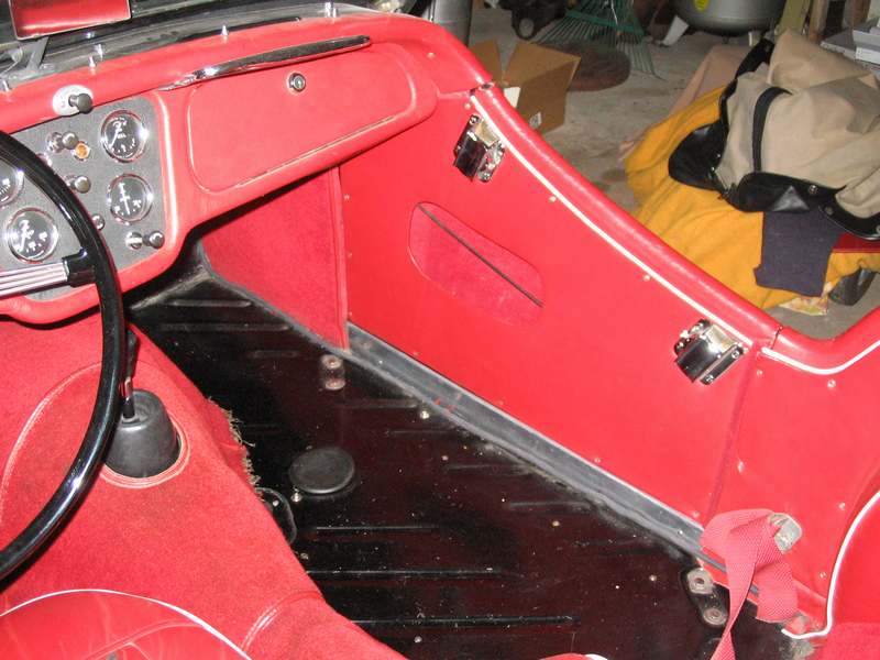

Here ia a photo of the interior floor pans taken in 2008, 18 years after I restored my 1958 TR3A (body off) and the 2-pack paint I used is still as good as it was in 1990.

My TR3A looks the same under the car as well after 20 years and 103,000 miles with ordinary car paint.
