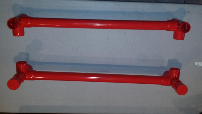

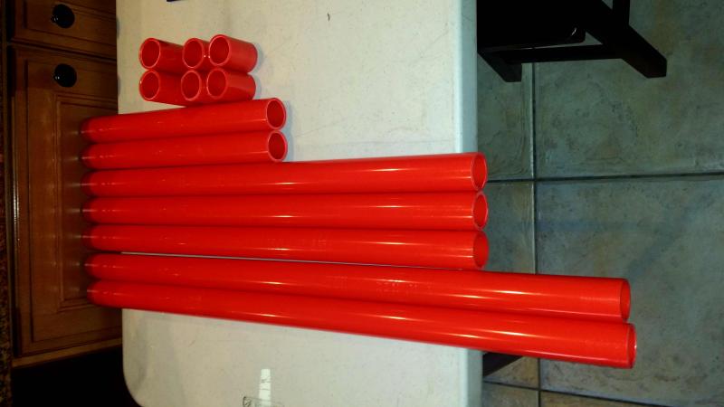

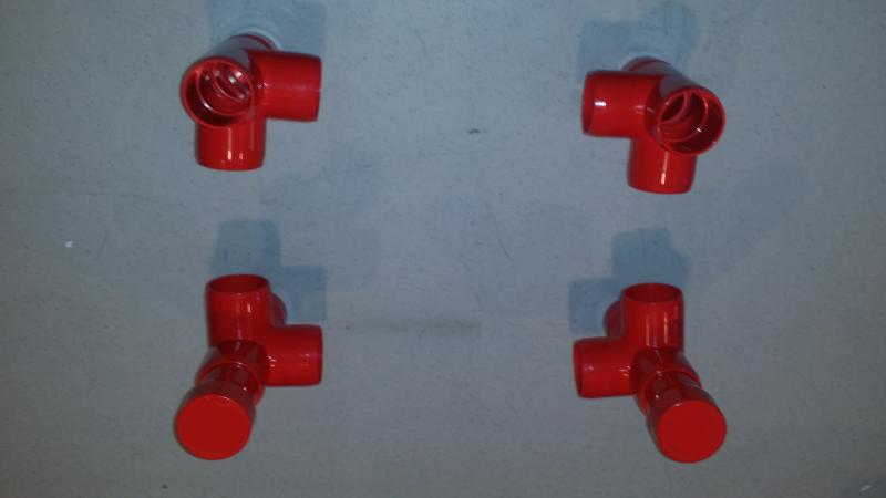

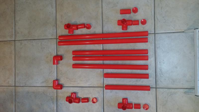

Sorry for the delayed response - good intentions, but life got in the way. I elected to use 1-1/4" Furniture Grade Schedule 40 PVC. I did this for two reasons; 1) there seemed to be more fittings readily available, 2) it just looks a lot better. I bought all the material on-line from Home Depot. Below is the list of material I bought , as I previously stated the material was 1-1/4" PVC
4 - 60" lengths
2 - 90 degree elbows (sold in packs of 4)
6 - Flat Caps (sold in in packs of 10)
4 - Four way Tees
My cut list is as follows
2 - 32" lengths - Uprights
3 - 26 -1/2" lengths - Cross Members
2 - 15-1/2" lengths - Cross Members
2 - 3-1/2" lengths - Pegs
4 - 2" lengths - Legs
When the job was completed my three year old grandson said, "Nice Rack" ;) Car guy in training

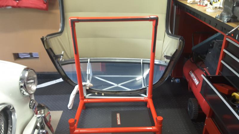

That is very cool! I think I may make one for my Spitfire hard top! Have you considered adding some foam padding to the places that will contact the top?
Basil -
Thanks for the suggestion, the deed is done. Amazing how little of the surface area comes in contact with the rack. Just a bit of the metal trim at the bottom of the rear window and the very top of the hardtop, yet it sets securely in the rack.
