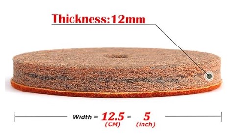

I have them, I don’t like them. They take forever, compared to the next option – Sponge Fiber Diamond Polishing Pads (search “Sponge Fiber Diamond Polishing Pad” on Amazon) Picture 3 below.
I like these because the “sponge” fibers wick up a bit of water so they stay wet a lot better. The water caries cerium oxide up into the pad, which keeps it from all immediately depositing on the front of your pants. Instead, it flies off slowly – same amount on your belt buckle, but it takes longer.
In my experience, the sponge pads cut a heck of a lot faster than the solid pads.
