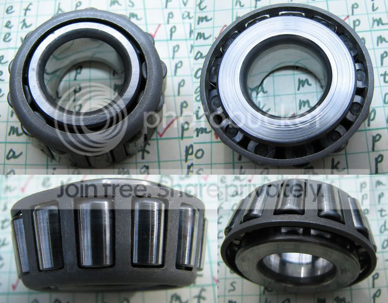

As advised, I retorqued the wheel bearing nut to 10 ft lbs then backed off 1/2 flat to insert the split pin. No more wobble!!
Here's some shots of the no-name wheel bearing, cleaned up. Superficially looks OK - no pitting, discoloration. Spins just fine. However, looking close there are scuff marks.
I'm thinking about greasing it up and putting it back in and placing an order for the Timken Bearing kit from TRF and replacing all of the bearings.
Cheers,
Adrian
TS58325
Yup, the rollers are discolored. That means the wear is also transferred to the races.
When you put any tapered roller bearing back in, make sure you have the grease packed between the inner and outer cages between the rollers. You can get an inexpensive packer that works with grease guns, or you can pack it by hand, which is usually lengthier, but more fulfilling.

Ron,
Thanks for the post - advice noted.
Does that mean I should be replacing the races as well. (Don't know why I'm asking that)
Seems BPNW are the only supplier of the races.
They have a neat thing whereby you can ask a question of any part they stock - let's see if they reply - I've asked for the name of the manufacturer of the bearing.
Cheers,
Adrian
TS58325
Yes Adrian.
Always replace the bearings and races as a set. They will come as a set and should be replaced as such.
