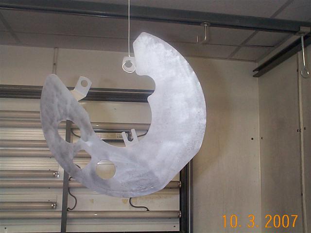

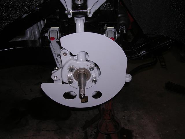

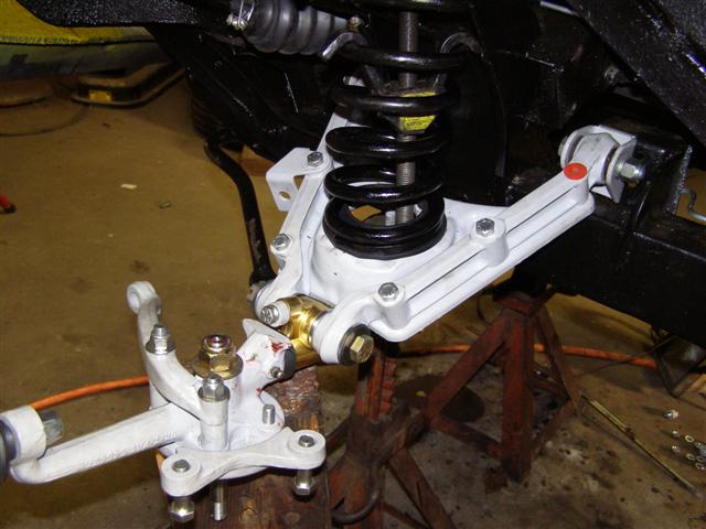

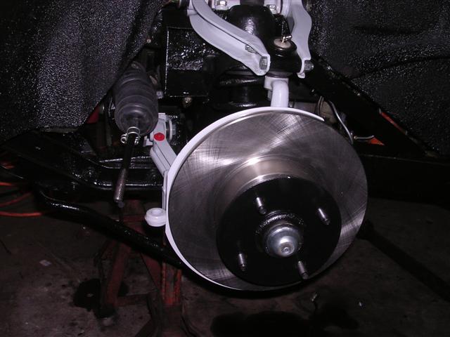

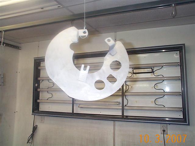

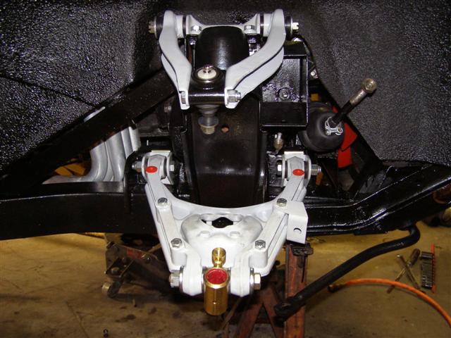

Look at these pics of the plates and how it all ends up together.

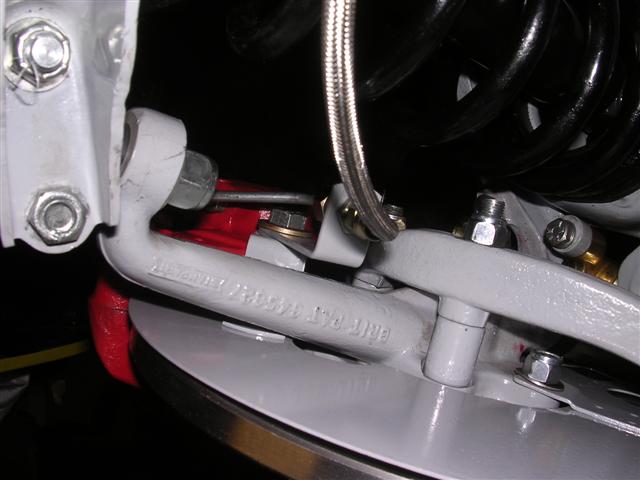

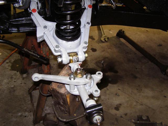

I agree. Here are a few more shots of what's hidden in there, how the plate is attached and that ball joint and trunnion definitely need to be checked.

Paul, I' never thought of you as a slacker, but:
Picture #1 shows wheel grease behind the lower right nut
Picture #1 shows the cotter pin in upper left to be crossed, not wrapped back around nut
Picture #2 shows a black tie wrap or worse oil dripping down the front of the jack stand
Picture #3 is unclear, (I can't find anything)
Picture #4 shows the red wheel grease still there and a set of the funkiest looking stands and jacks I've ever seen.
Clean up your act, man. That is a disgrace!

Brosky
Tsk, tsk, tsk!!! Shame on me. Good observations too.
Well, these were part of the "assembly pics" and sometimes grease gets where it shouldn't be. I assure you that was all cleaned before it went home.
Remember that the car wasn't completely back together so loose bolts are also showing.
Now for the cotter pins. Those are indeed incorrect at that time, BUT, after the entire chassis was assembled I drove the car for about 50 miles over all types of bumpy and winding roads. Then I brought it back in and we re-torqued every nut and bolt on the chassis. New cotter pins were installed properly at that time and everything was wiped down before I beat the snowstorm home that day.
