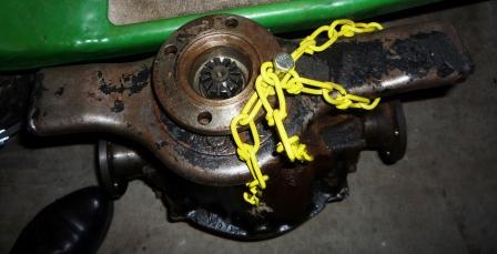

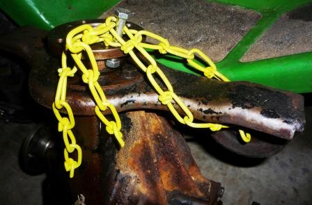

When I replaced my pinion seal and had to re-torque the nut, I used chain and a bolt..... I wrapped the chain around the axle and inserted a bolt through the chain, and one of the holes on the flange. This kept the flange from turning as I tightened the nut. Let me know if you need a better description.
I need a better description.
This should help....
<span style="font-style: italic">edit: I wrapped chain over the front housing of the diff... not the axle</span>

And this...

OK that helps a lot! thanks
Happy to help JP. This is what worked for me and I'm sure there are other ways to accomplish it. I like this method since it does not leave teeth marks from a BF wrench!

I made a mistake on my original post. After going through my records, I found that I replaced the bearings and seals on the sides for the axles, but only the seal for the pinion. I figured I needed to replace the side bearings since one axle was broken when I bought the car. In retrospect I know I should have just rebuilt the whole rear end. I can't undo my mistake. The worst case scenario as I see it now is I will have to rebuild the rear end if just tightening doesn't work. So, I made the tool based on the article from Trevor's hyperlink. (I was having difficulty trying the pipe wrench without damaging anything.) I will be going out to the garage shortly, I figure I have nothing to lose at this point. I spoke to a local guy who works on British cars, and he thinks I have a solid spacer. He was busy and I didn't have time to ask, but I would like to know: 1) How do you know what kind of spacer this has without pulling it apart? 2)If it is solid, why should it matter if I just tighten it to original specs?

I would not use a pipe wrench on the flange, as it will knurl up the edge, maybe interfering with u-joint companion flange fit, and I would never use on bolt at an angle through the pinion flange to a piece of kid's swingset chain.
If the chain doesn't fail at 175 pounds, and whack you in the skull, the bolt's gonna snap and poke you in the eye, or at least the angled bolt will enlongate and curl the edge of the hole.
