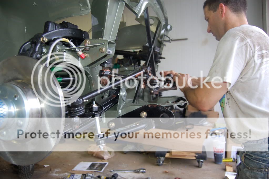

pictures of front disk conversion?
Rich, unless I'm very mistaken, you need to shim the rotor to move it away from the inner pad. Shimming the caliper will move the inner pad closer to the rotor. I don't know where to get 0.010 shim washers, but somebody else probably does. I wonder if the inner pad could be milled to take off .010.

I got a reply from AHSpares and they are sending the shims gratis. Thanks for the photo of the brake line. I figured it out from your comments as well as searching Randy's Photo gallery.
