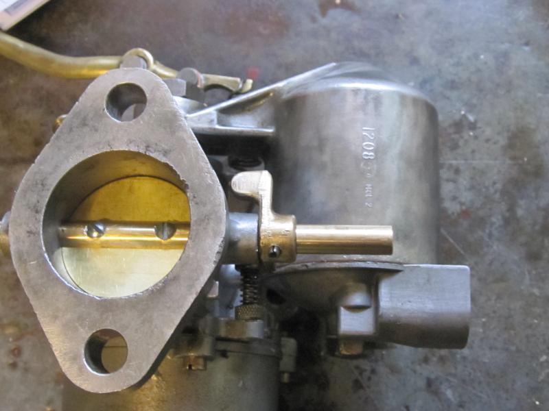

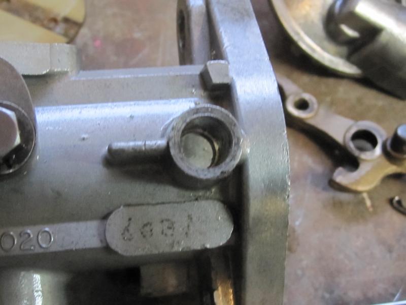

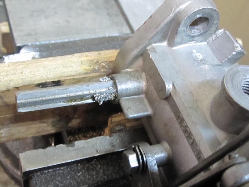

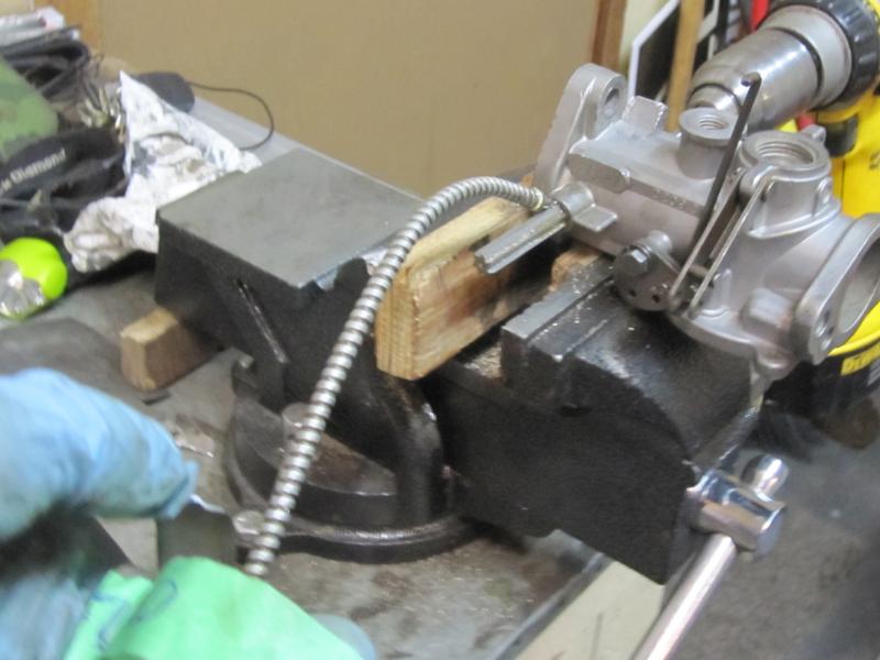

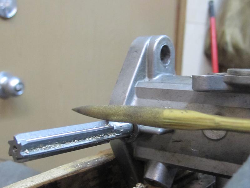

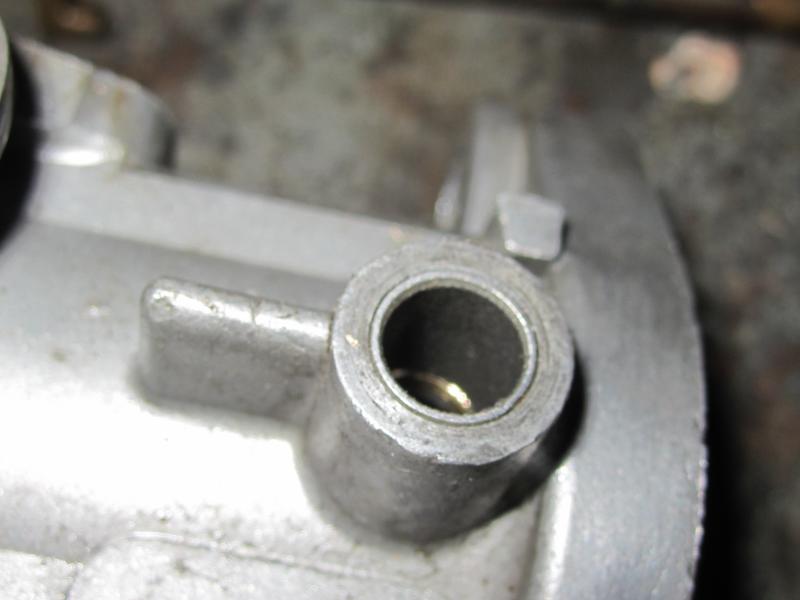

I posted about this a few days ago but thought a few pics might be helpful. This worked so well that I am still happy about it. No need for that expensive tool; an inexpensive $20 tool did the job well. Hope this helps someone else without lots of fancy equipment.
The chucking reamer worked very well using the existing throttle shaft bore as a guide. The shaft on the Grizzly reamer is exactly 5/16" diameter, which is perfect for running in the worn existing bore, while cutting a new 3/8" hole with the reamer. The key was to sharpen the reverse end of the flutes to turn them into cutting teeth; it is not intended to work that way, but it does work well when sharpened at that end. Also, one does not want to go all the way through; only go far enough so that the new bushing will fit completely into the hole. Then one can use the rest of the orignal 5/16" bore to act as a guide for the other side. Don't insert the new teflon coated bushings until both sides are reamed out.
The important thing is that the 100-6 now purrs like a kitten, without air leakage at the throttle shafts, and no leaks noted. The new throttle shafts, butterflies, bushings, jets, and jet sealing parts in the master rebuild kit did come in useful. A number of the other parts in the kit did not fit the H4 carbs. I guess that is what one gets with universal kits.

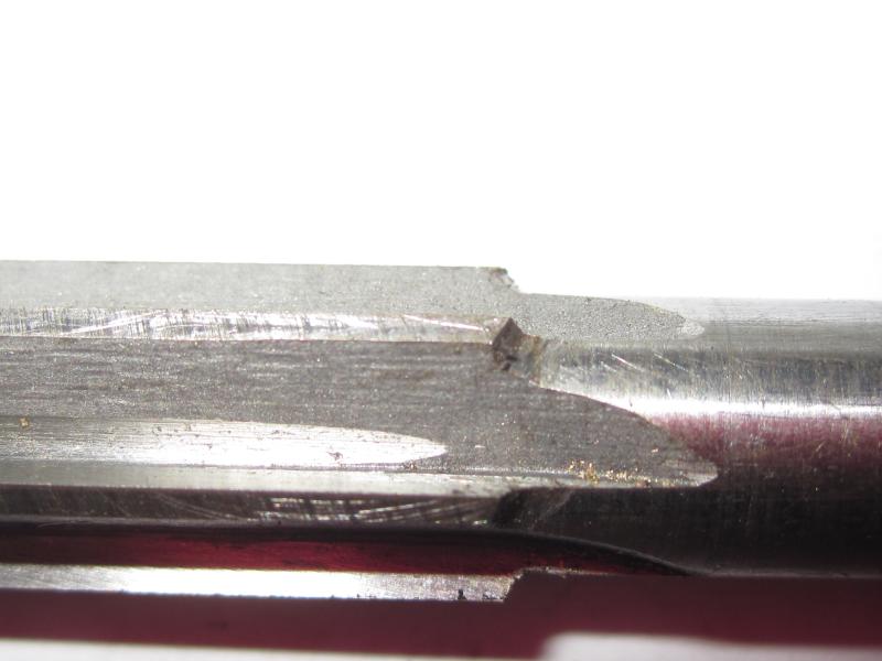

Could you show a close up of how you filed the back of the reamer so it would act as a cutter. Thanks and have a good day!
John
Here is a picture of the filed rear edge of the reamer, as well as a picture of the label on the reamer package. The hardness of the metal on this reamer is not the best, so it required resharpening a few times to do the four holes.

I would like to share my "lessons learned" to assist anyone else encouraged to attempt this repair:
1. The correct reamers are on Ebay. Less than $30, including shipping.
2. I sharpened the back edge of each flute using a Dremel with a 3/4 inch (carborundum?) cut-off wheel. Easy!
3. Reamed out the first bushing by hand in 25 minutes. BORING! Used a cordless drill on the next 5 bushings; 2 minutes each.
4. Wrapped electrical tape around the reamer to mark my intended depth. This proved unnecessary.
5. Each existing bushing would break loose in it's housing after all but the last 1-2 mm was reamed out.
6. Since this remnant was spinning with the reamer, it would no longer cut. This acted as an automatic depth gauge.
7. A small punch carefully tapped out the bushing remnants.
8. Place the new bushing and use it for a guide to ream out the opposing side.
9. The reamer shaft worked well to guide the new bushing into proper alignment.
10. A drop of Blue Locktite secured each new bushing.
11. SU-sourced bushings are steel with a Teflon-coated interior. Oilite brand bronze bushings are available for under $1 each.
Good luck. This should result in a consistent idle and improved performance.
