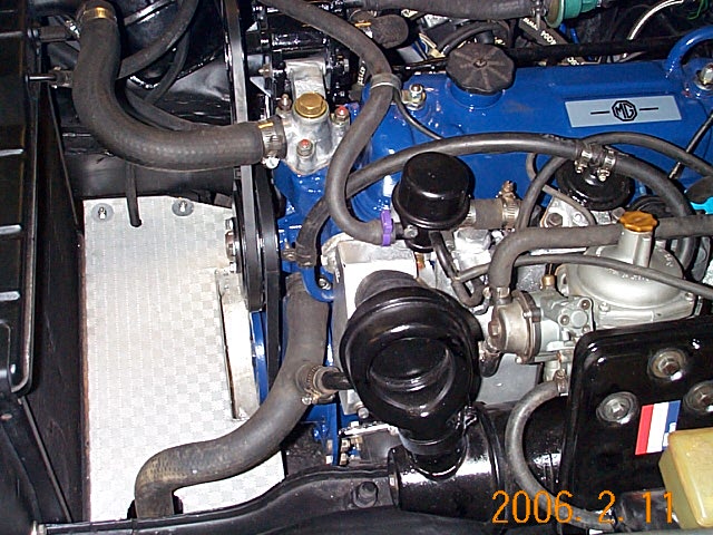

Though a real nice job, there are some personal touches in that compartment (& I like some of them); however, somebody wants to know what's not stock:
1. Obvious: engine color, mud shield, engine compartment color
2. thermostat color should match engine - in this case black
3. Missing a decal on the valve cover
4. Missing the loop on the oil cap that attaches it to the valve cover
5. Some hose clamps
6. The vacuum line from distributor is routed incorrectly (though probably better than original)
7. Gulp valve should be natural anodized color, not black
8. Carb heat shield & preheat items should be natral anodized color, not silver
9. Decal on air cleaner is incorrectly mounted
10. Oil breather hose (oil seperator to carb) should be a 1-piece unit
11. Brake booster vacuum line incorrectly mounted & routed
12. Depending on year, fuel line should go to rear of carb, not front
13. Gulp valv to air pump hose incorrectly routed
14. Check valve should be natural anodized color
15. Clamp to air temp regulator should be natural anodized, not black
...& I might have missed a few things that I would see if I were judging the car in person at a show
...again, I'm not knocking what's a beautiful job, I'm just pointing out what's not original to help somebody who might be trying to make there's original....heck, I wish most of my engine compartments were so nice!
hummm...That is one clean engine compartment... although I' am really not a big fan of the blue, i know it just a personal thing but as I've gotten more serious in the hobby I prefer to keep things as original as possible....Actually I will be stripping down the engine compartment in my 58 MGA to repaint the black the original dark red(don't know what possessed me to paint it silver)....
On a related note Tremclad makes a color thats very close to the original dark red(ealier cars, before Leyland cheaped out and painted everything black)...I've got about 15 cans of it stashed in the basement in case they ever stop making it.....it's become vital in my TC resto.
Hi Tony,
thanks for the feedback, some of the items I was aware of and others not. Most of the list are items that I have repositioned or routed as was. The brake booster line I cannot see in the pic. Anyway thanks for the list it gives me some things to work on.
Cheers Ric
Hey, Ric - I like the rerouting of the distributor line...mine is always getting burned where the factory put it...I might steal that idea from you!
Maybe I missed it... What color is the outside of the car?
I routed my distributer vacuum line around the back of the valve cover....it goes through a small clamp attached to one of the bolts for the water choke spout (now a blanking plate on mine). Hides it nicely on mine, since it's manifold connection is on the rear runner of the DCOE mainfold.
Black body, and I say again. A fine fine looking engine room. You should be rightfully proud to show it off.
I thought it was black. And the fuel line on mine goes in at the front outside of the carb too. I even have a few original hose clamps! Probably a few original hoses! I have all the hose clamps that have been replaced on mine though in the trunk.

Understands, I wasn't knocking the work - its exceptionally clean...just answering somebody's question
have fun in the UK...we're going over Jun-July
aye, thanks for answering the question, Tony. I like the look of the engine bay too. But learning what's truly a stock engine compartment is what prompted me to ask the question.
