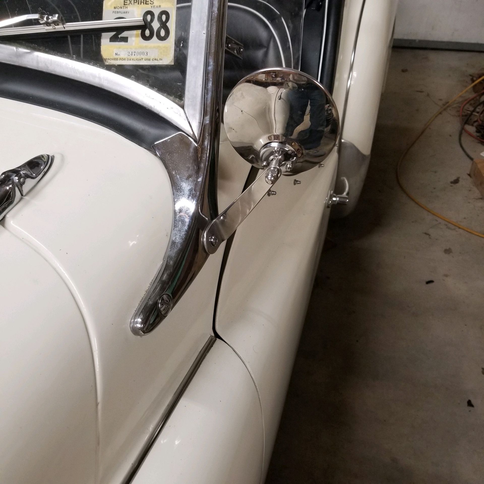

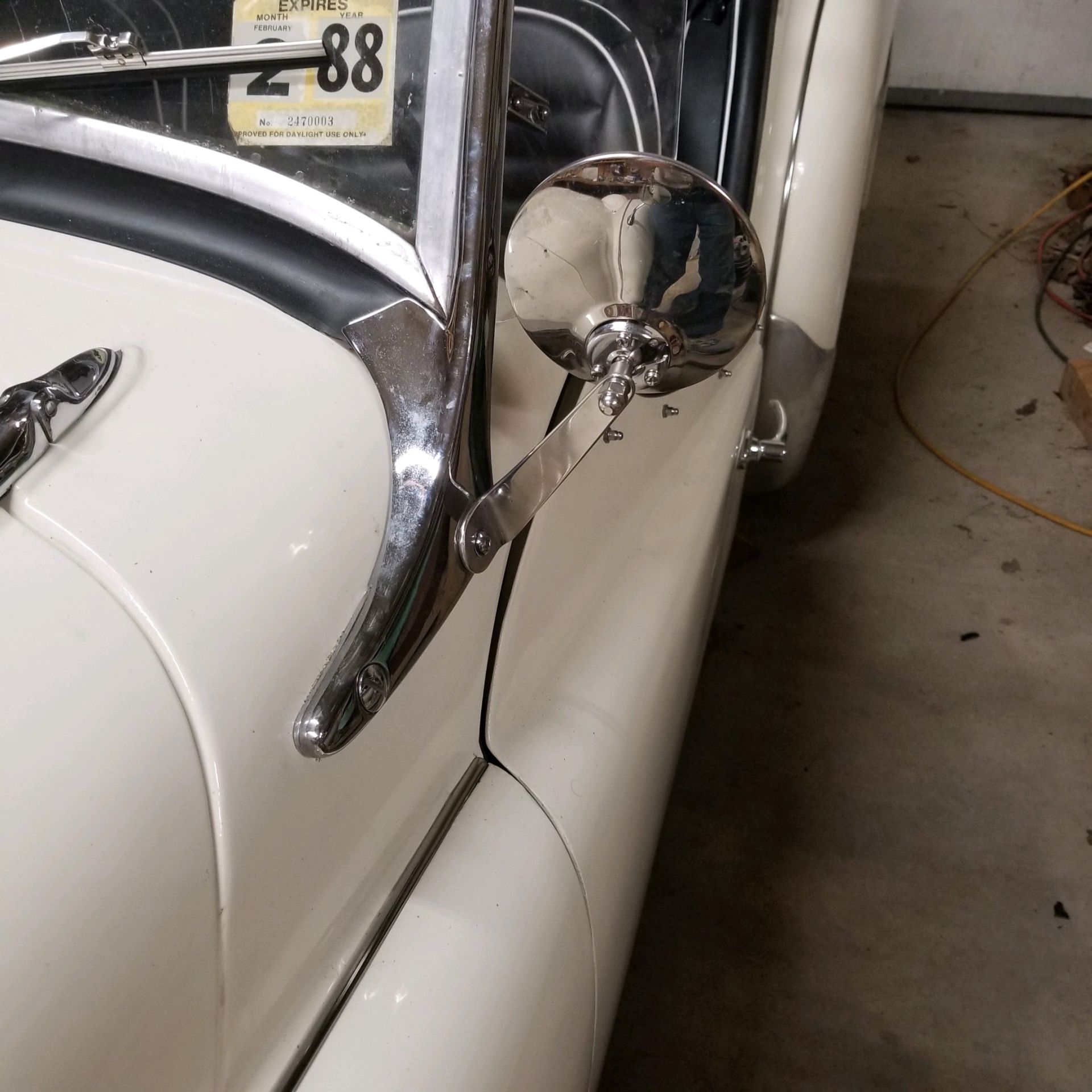

Made a mirror mount that goes n the windscreen stanchion. It works well and I can adjust it as I drive if I have to. It is also a convex mirror which helps a great deal. The mirror on the wing is flat so it has a very small field of view.

Made a mirror mount that goes n the windscreen stanchion. It works well and I can adjust it as I drive if I have to. It is also a convex mirror which helps a great deal. The mirror on the wing is flat so it has a very small field of view.View attachment 68174
David
Is that a self tapping screw holding the mirror bracket to the stanchion? I'm wondering if that setup would work on the passenger side because of the angle of site? I think I saw where someone had mounted a Harley Davidson mirror to the stanchion....have you ever seen that?

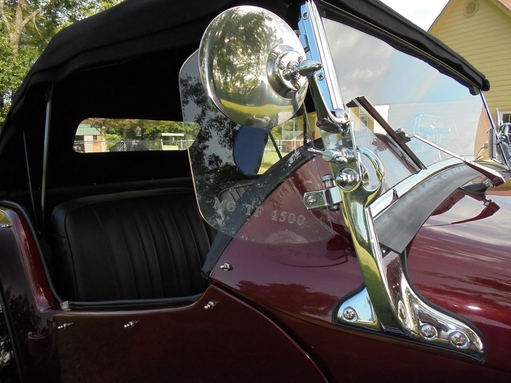

I refused to install fender mirrors on my TF since it never had them and I didn't want to drill holes in my perfect fenders. So I bought a pair of these from Moss and love them! If the windscreen is down, they can be rotated and still used. PJ
It is a Chrome Button head socket cap screw that matches the Stanchion mounting nut. I bought a pack of 10 from Mc Master Carr. Works great. Bent up the SS bracket from some material I had in the shop.

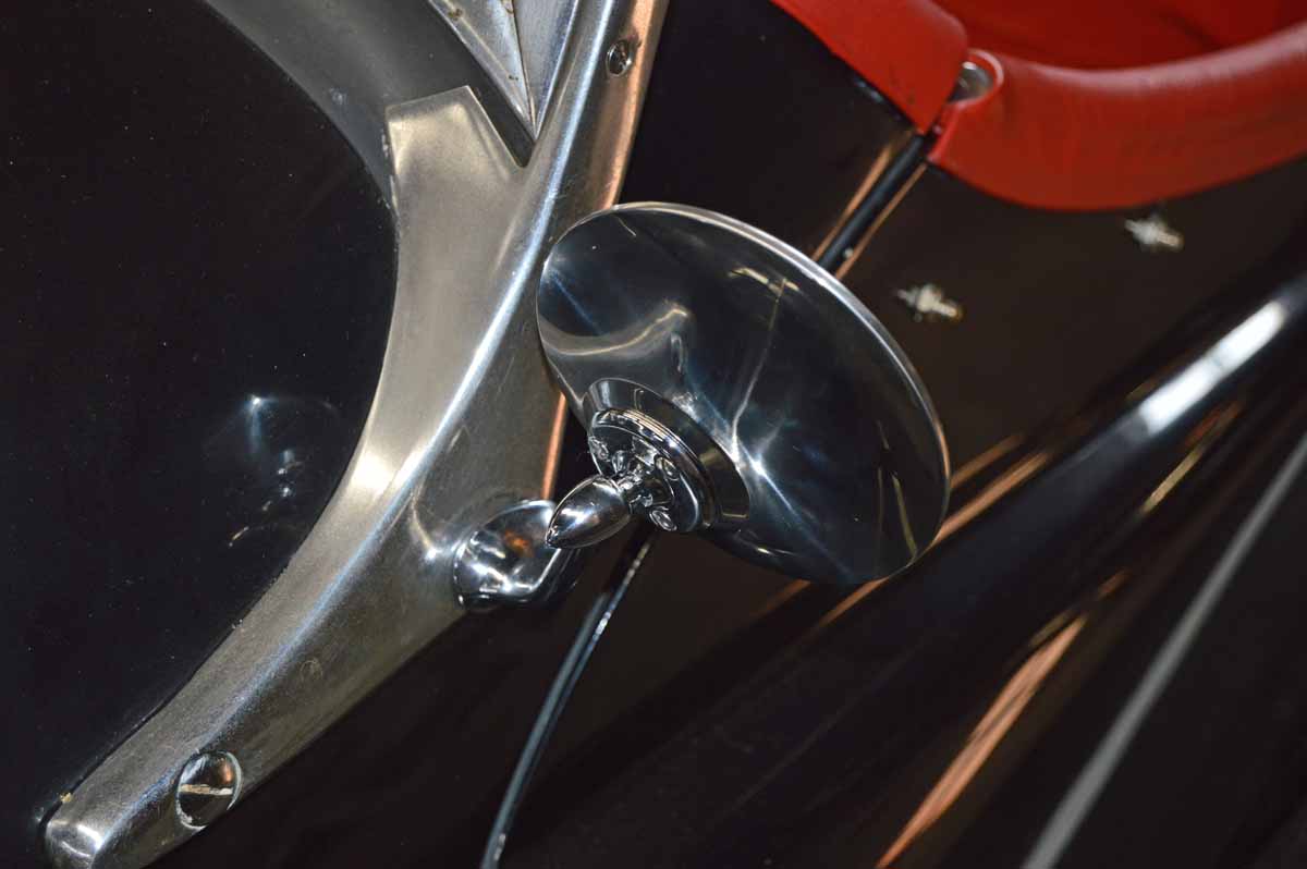

Here’s my solution, which I spotted on an MGA on the web. I used one existing hole, and drilled and tapped another (using a BA tap), plus some extra strong clear epoxy. I really like the results!

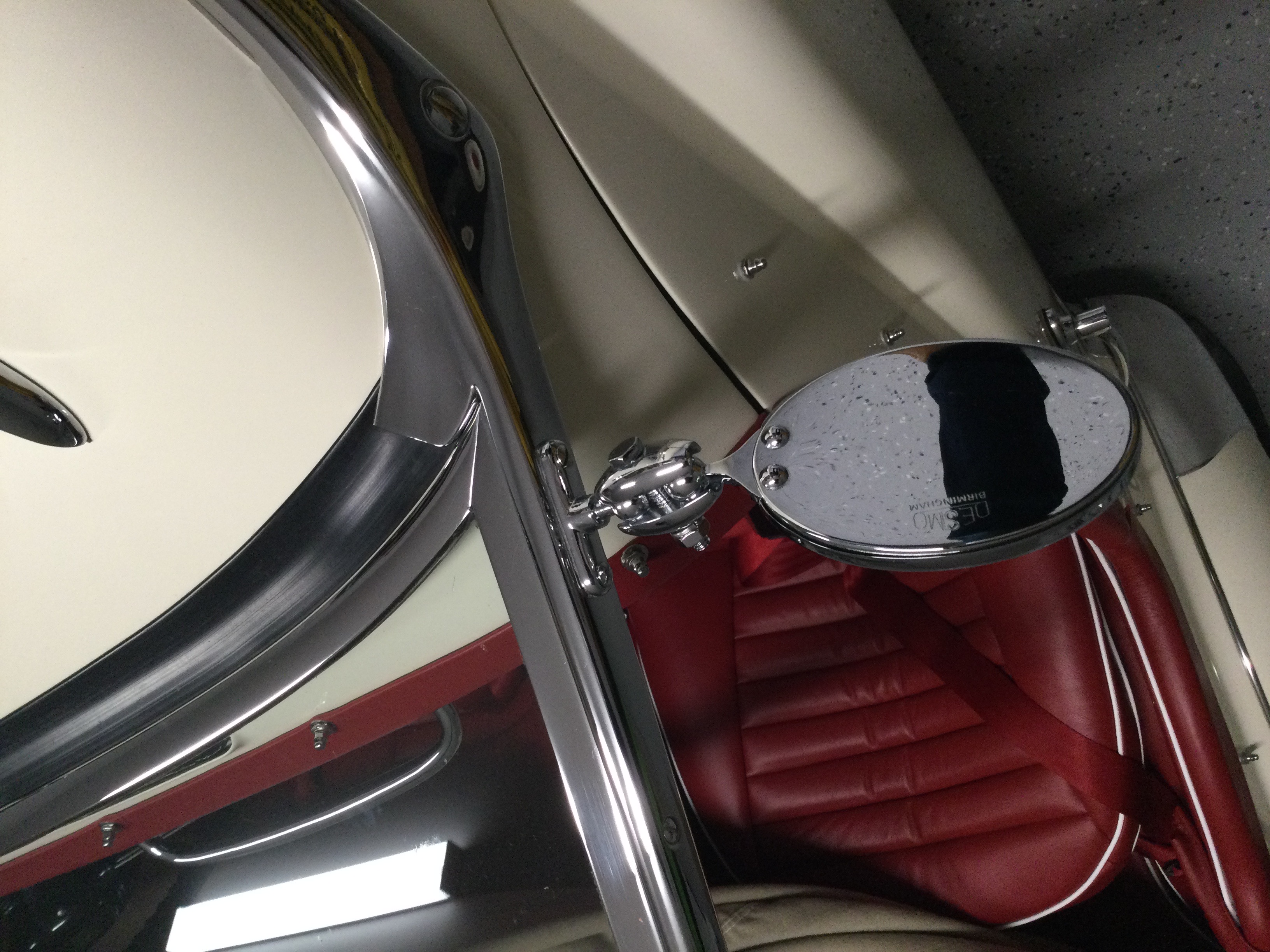

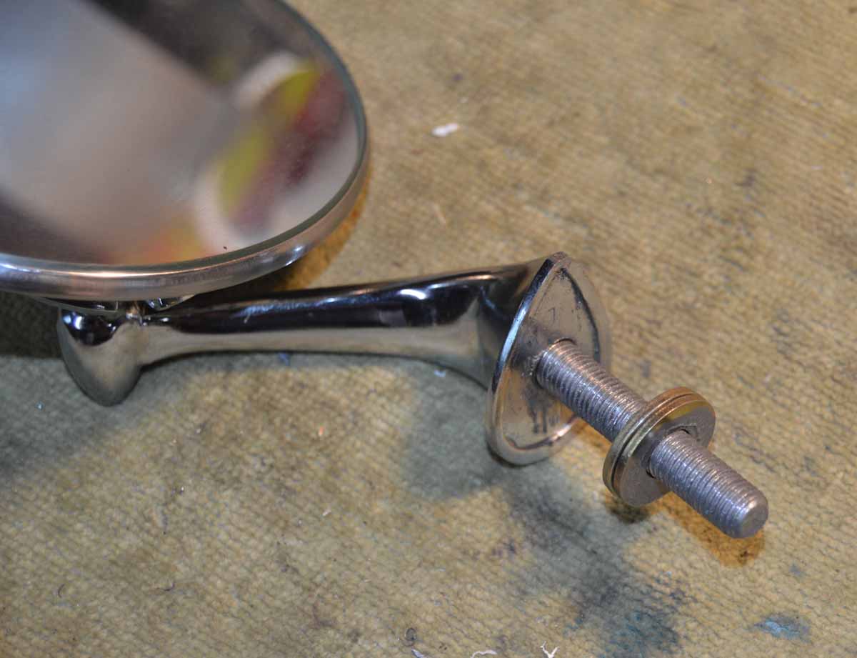

I used one of the fender mirrors. The stud on the original mirror is too short, so I cut it off, drilled and threaded a 5/16"-24 hole and screwed in a stud long enough to screw into the one of the stanchion holes. This will only work with the non-dzus stanchions. I still have both fender mirrors, and unless I bump into them, they stay put. Both fender mirrors are convex and the stanchion mirror is flat. That gives me a great view to the sides.

That looks like a great way to solve the problem. It dosn't look like the wind wings would fit after that mod though? Guess a person just goes for one or the other.
I was never a fan of the wind wings, so the thought of the mirror interfering hadn't crossed my mind. I suppose the mirror could be mounted in the front screw hole of the stanchion. That might work.
