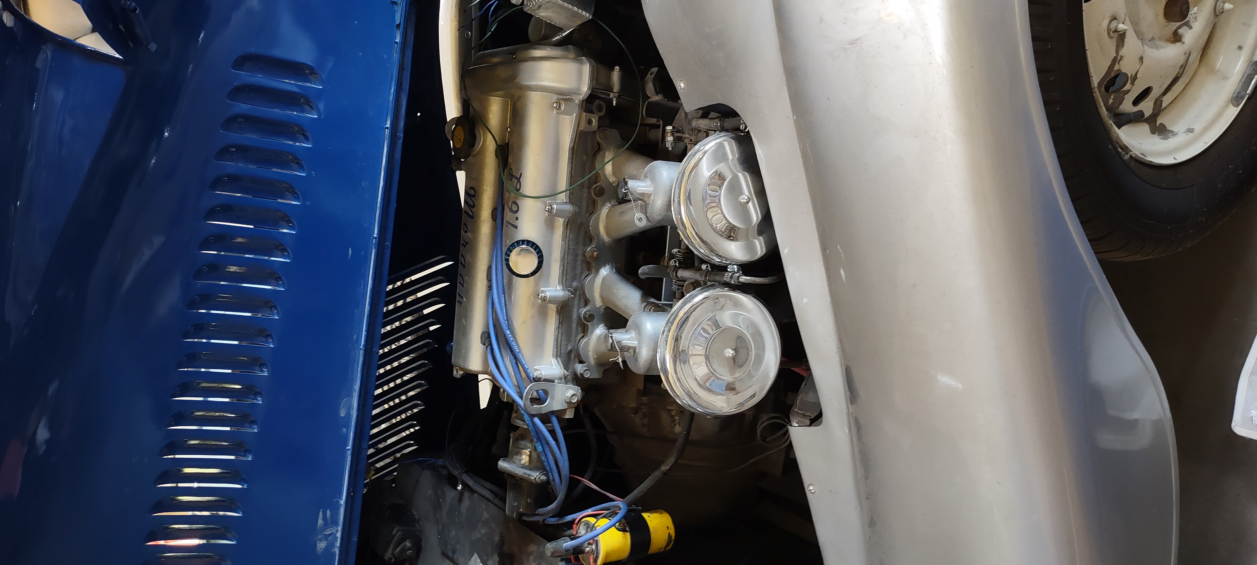

The Miata motor did roar to life finally after fighting some bad (brand new ) wiring. Still
a few more circuits to sort out but there is light at the end of the tunnel.
Lucas switches not with standing......
Mad dog

Thats a nice looking set up, Glad you got your wiring sorted, I m using the original MX5 loom, although the bits not needed stripped out,
Body back on but needed to adjust the steering column quite a lot due to it being too close to the windscreen, if i just dropped the column at the business end it made it reduce leg clearance making it difficult to get in and out,
The nice new chrome and wood steering wheel i bought had to be cut up made into a 12" and re wooded, this solved a lot of clearance problems.
Getting too cold and damp now to do a lot to the panther, will be getting wrapped up for winter in the next couple of weeks.
