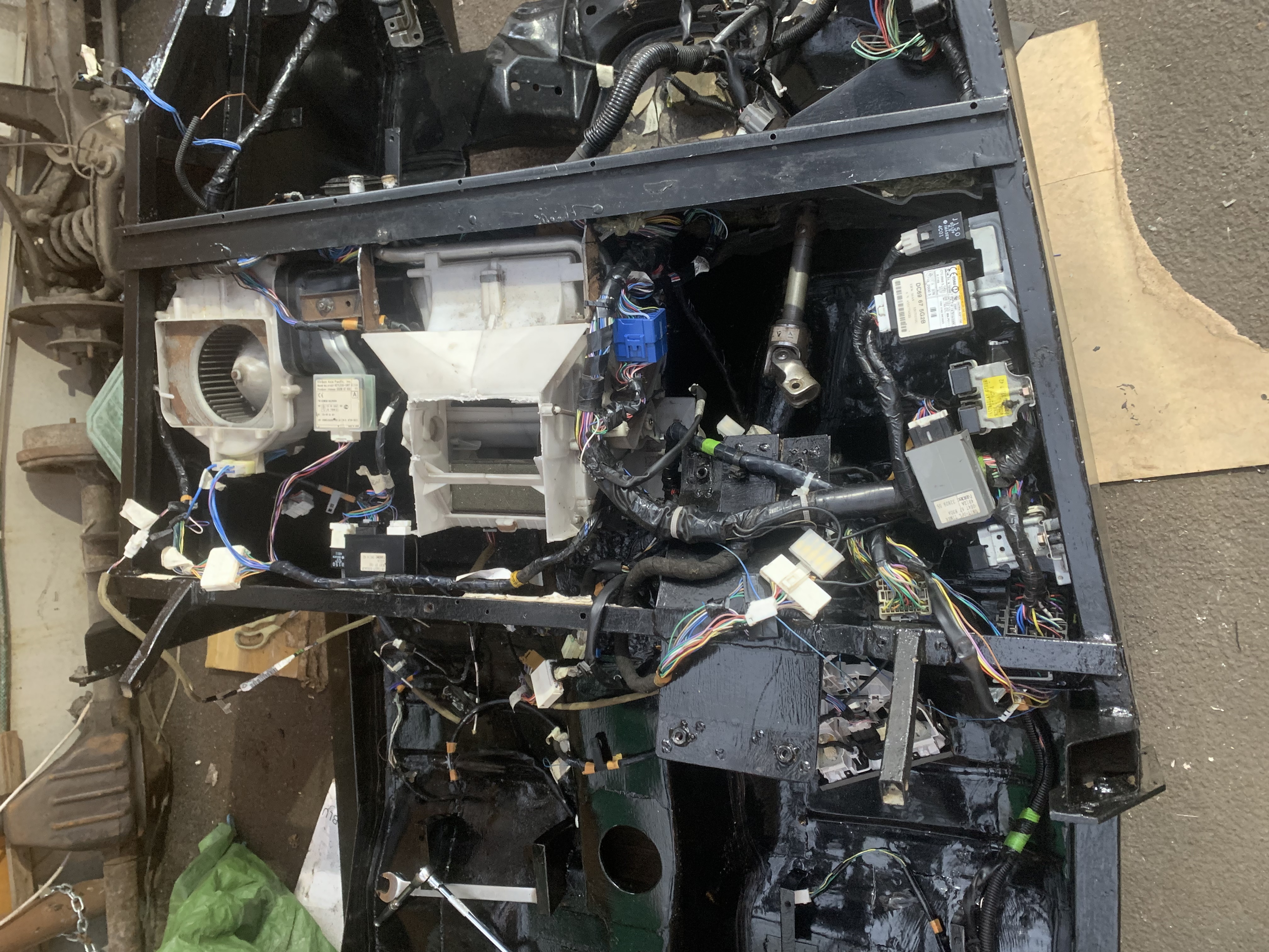

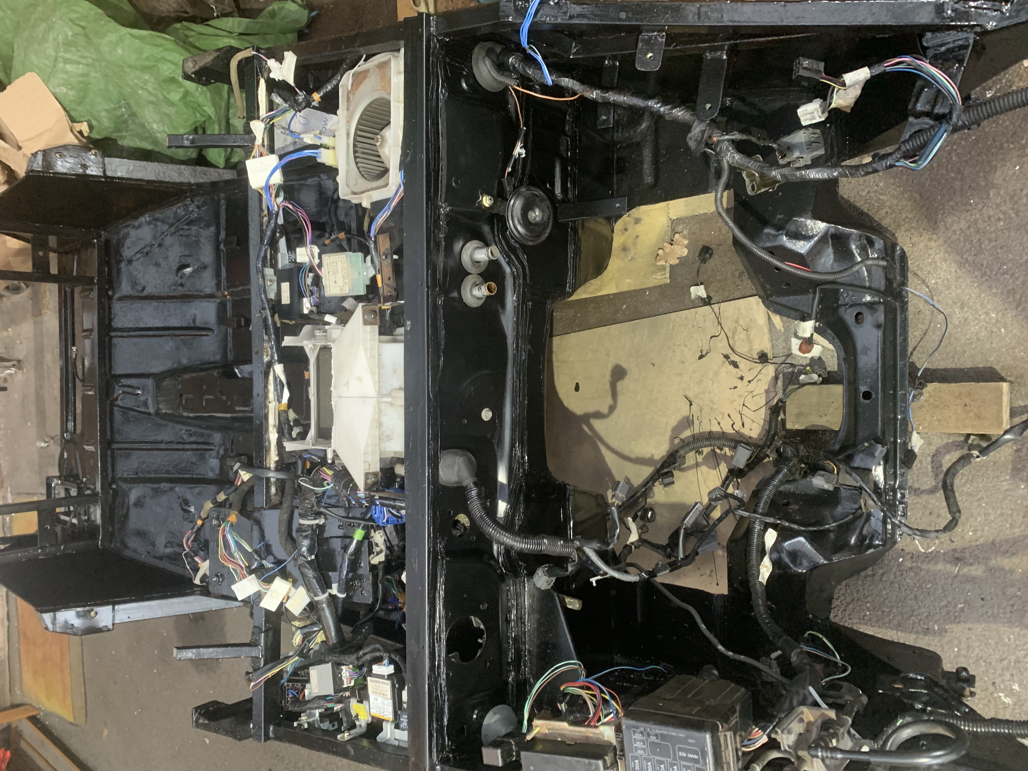

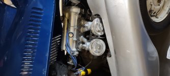

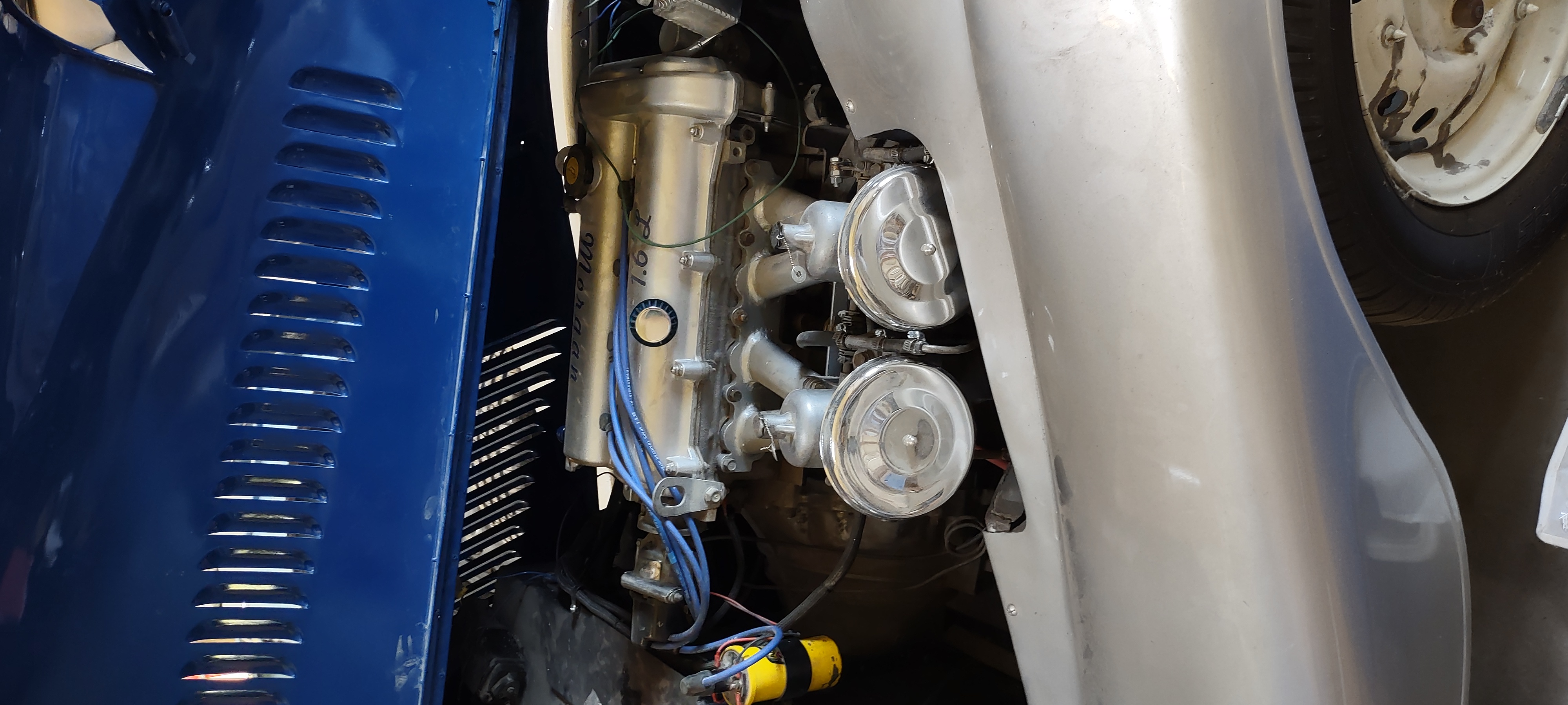

Wiring loom going in and there's a lot of. Heater box and blower motor. Fuse box and relays bolted in. Fuel lines from tank to engine bay. Battery cable from boot to engine bay

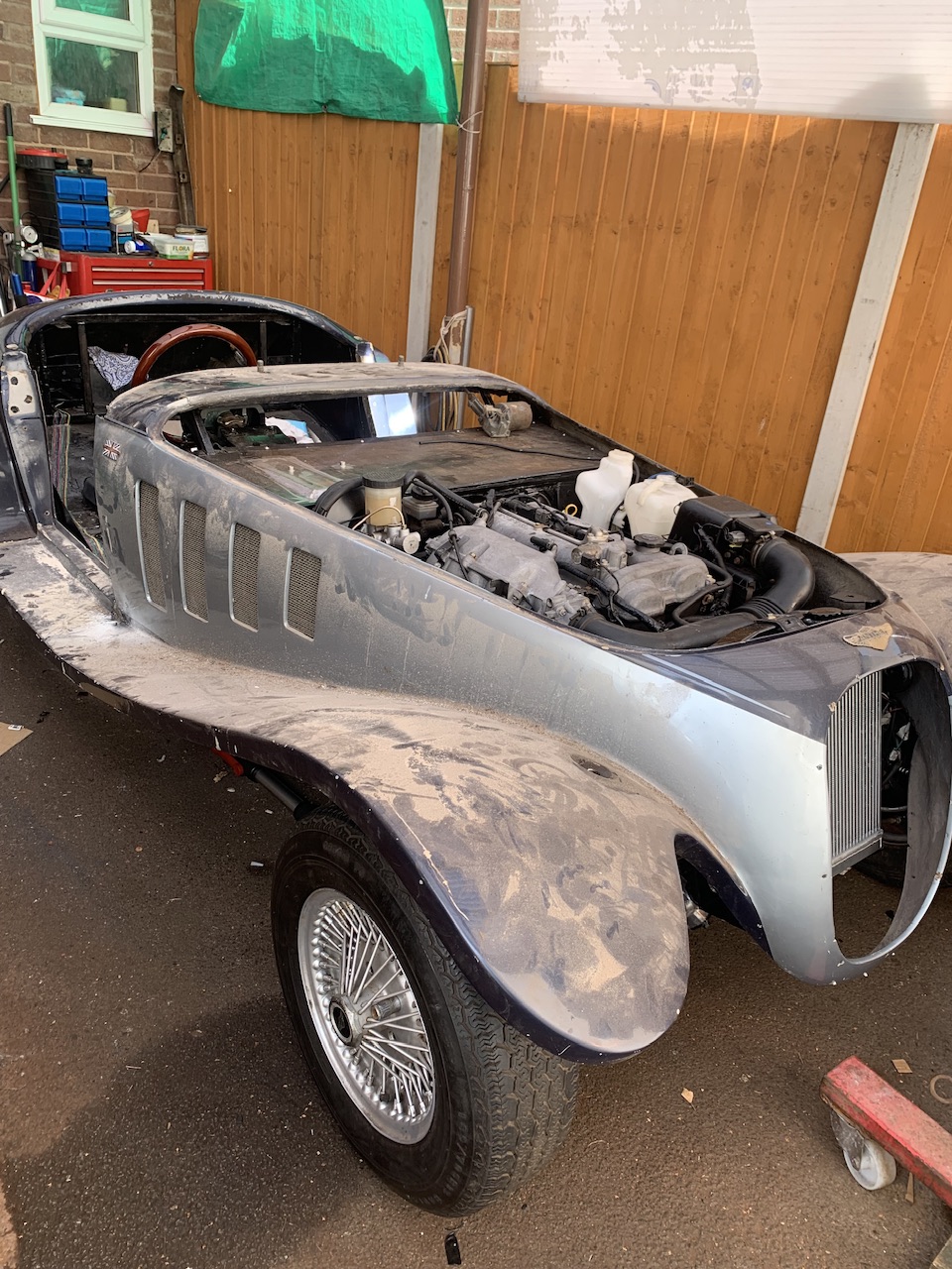

After the gearstick relocation mod the engine was cleaned with some aluminium acid and it almost slipped back in the tub, truth be told, im hopping thats the last time,
fits like it belongs there, steering column fitted in ready for the rack, front suspension subframe all stripped cleaned up and refitted.

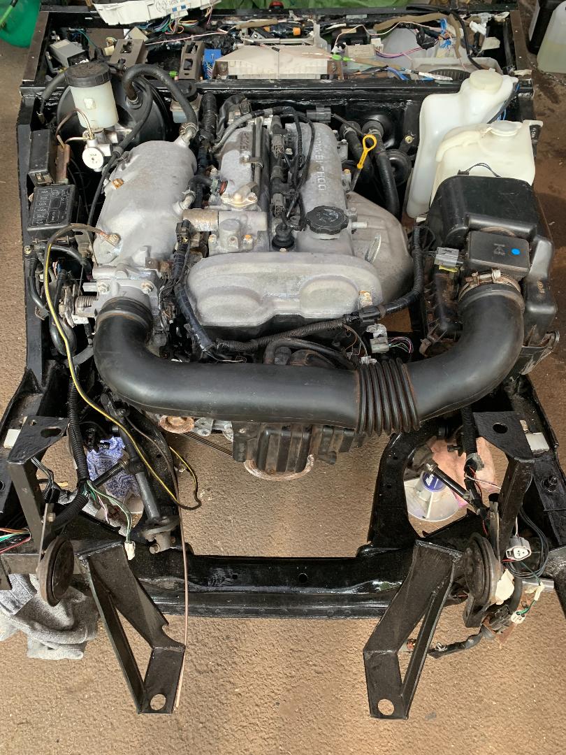

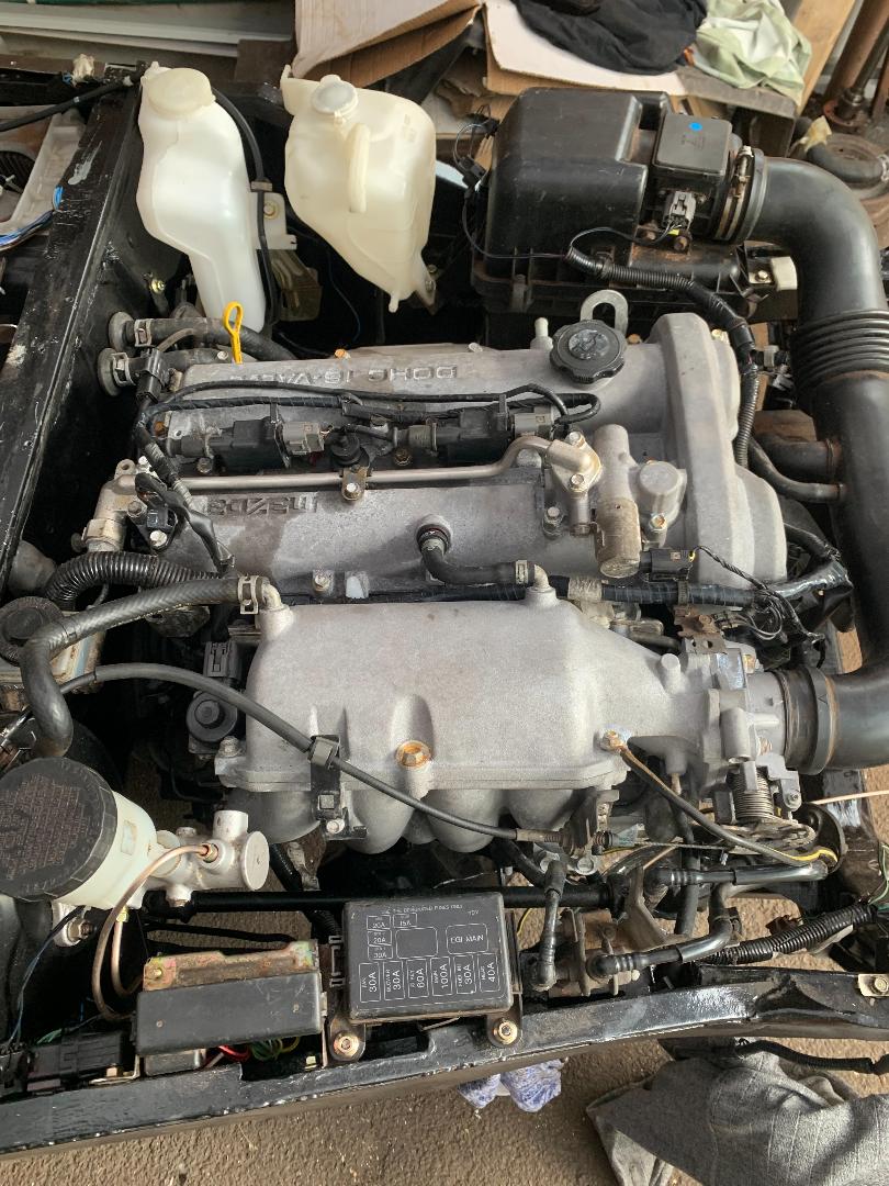

engine is now all connected up and turns on the key.

That's great looking work, it looks right at home in the engine bay.
Can you reach the oil filter from the bottom? It doesn't look like you have much clearance from the top.
There is faff all room to get down the drivers (right) side, needed to unbolt the fuse box to fit the starter wires, but access is much better from underneath so future servicing should not be a problem, new cambelt and water pump will be fitted before the rad goes in.

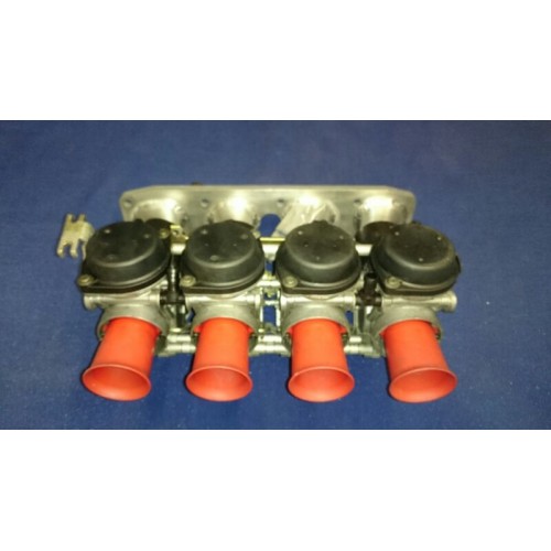

Some here in the Uk do a motor bike carb conversion with four carbs, saves a little room and makes them go like $hit of a stick.
