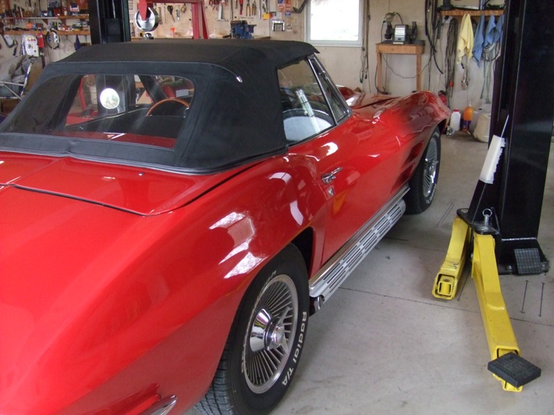

So then it comes down to regional cost. Here is an example that shock me and probably will shock just about everyone else. This shocked me because I have painted many, many cars and I do this as a hobby but I would not have given this minimum price that this guy got. Especially for a red paint colour. Red auto paint is the most expensive paint you can buy. So here is a picture of a '63 Vette that I just put a new rear suspension under for this guy. I know this car and I had it about 3 years ago where I put a front suspension under it. I the interim while in his garage, something fell off the roof rafters and cracked the back deck. He took it to a local 'production' body shop because he had insurance money. The whole body showed its age and it had cracks in traditional places. While at the production shop, he asked "How much to paint the whole car" instead of just the repair and spot and blending of the repair. When he told me that they did the whole car for $2000. I just about fell over. Very, Very reasonable in my opinion, especially for a fibre glass car.

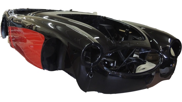

I am in the middle of a body off restoration, which included new chassis. But separating the body work cost from the paint work cost, left about $7000 for full two-tone paint (parts and labor).

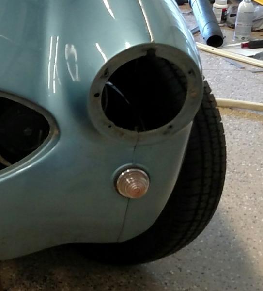

My car finally goes to the paint shop next week. I've removed everything in preparation including the beading above and below the front blinkers. It was plastic and painted over. I've seen cars with it painted and others with chrome. What is the proper method?
What a pain removing the chrome beading on the front & rear fenders.
I'm not looking forward to reinstalling them, any suggestions for making it easier?

Cessna, If you have not already done so, in order to reinstall the beads, you will have to loosen the bolts joining the fenders to the shrouds. As you will find out, some of those bolts are next to impossible to access. Just loosen them enough to create a little space to slip the tabs on the back of the beads into place.
Most people seem to prefer installing the beads after the paint job is complete. The risk with that method is scratching the paint with the extremely sharp and sometimes uncooperative metal tabs; definitely not a job to do alone. On the last car that I did, I fitted the beads into place before painting, leaving the beads a bit high so that paint could go into the gap between the fenders and shrouds. Then, after buffing, I pushed the beads down into place, bent the tabs over, and tightened the fasteners. That seemed to work OK - pros and cons.
John Turney
If you put the beads on after painting, cover the tabs with tape and put it on the edges of the fenders first for protection.
Rob Glasgow
If you are installing new beads and they come covered in black vinyl wrapping, make sure you remove the vinyl before installing. I didn't and was very sorry.

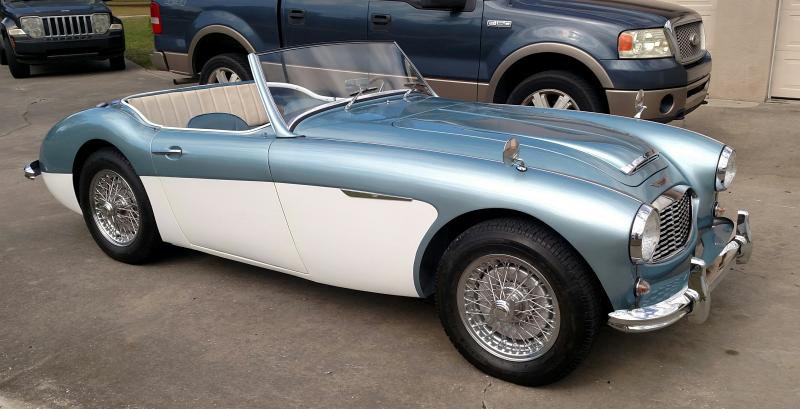

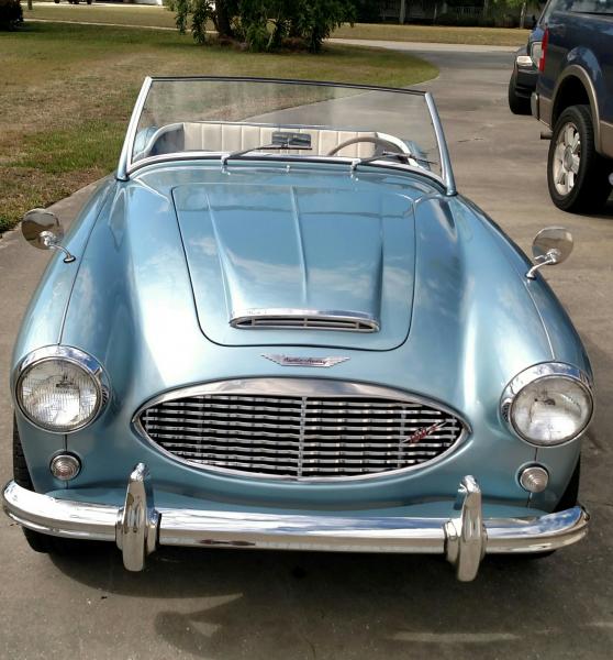

Well after 6 weeks in the paint shop I finally got my car back and the exterior put back together. Overall I'm very pleased and it looks awesome in the sunlight 10 ft away. But will admit under a fluorescent light looking up close you can see some flaws in the paint, but they are minor and you really have to be looking for them. For $1800 I guess can't expect it to be show car flawless.
I told the shop to paint it the same color blue and let them determine the paint codes. The shade of blue looks great but after reading the label off the left over paint can it reads Aston Martin Islay Blue. Likely when they ordered the paint they got Austin and Aston confused, I'm guilty of it myself in the past. If I had never seen the paint label I would have never known the difference since it looks like Healey Blue to me.
Now onto redoing the seats and panels.
