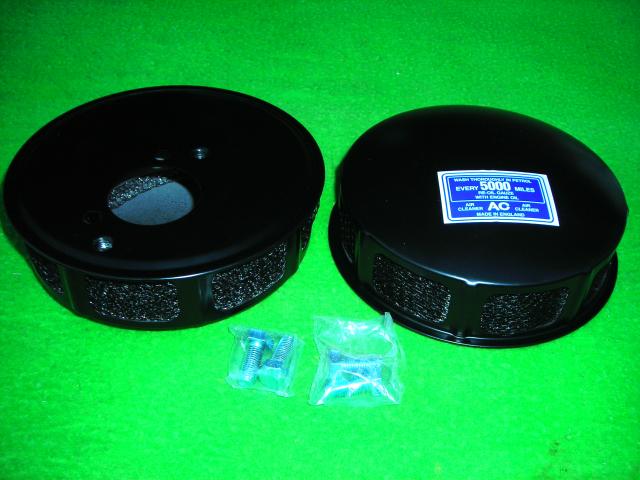

MGTF1250Dave
JP,
Mine I would describe as a satin black finish, but that my be due mostly to age of the paint. I've seen others that have a more glossy black finish, but not a high shine, mirror finish. Here is a photo I found:

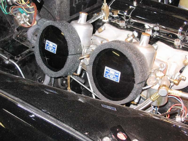

Geo Hahn
I use some foam koozies on my stock filters to improve filtration a bit:
Better than the stock filter alone, no idea how they would compare to the K&N. Neither (koozie or K&N) are going to be as effective at filtration as a paper filter.
Don Elliott
Mine are the original filters that came new on my 1958 TR3A. I had them sprayed glossy black in 1989 and here they are 20 years later. I never lost a point at any VTR or TRA concours event.
Like George, I bought a foam filter at Sears for my wet/dry vacuum for my garage and cut it to give me 4 pieces as shown to improve the filtering effect. I oil them with Amsoil Foam Filter Oil. Only takes a second to pull them off at a concours event.
