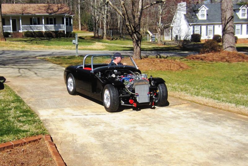

Ya know BlueMax, Alan, just took a spin in his Frogeye. Not finished, but close. He last drove it
41 years ago. These suckers get in the blood and there is no cure. Frogitis. Lovely illness.

My first outing!! Your not far behind ME!!
But a lovely illness they are! :wink-new:
Congrats on that first drive! That's got to feel good.

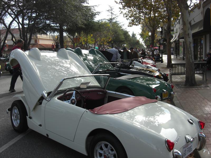

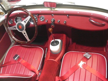

It is a great combo....my old 60FROG was originally OEW with a black interior......but when I built it up, I had to add more zing....so I changed to a red interior. Although the sprite never came with a red tonneau, that is what I ordered from AHSpares. I used Moss carpets and AH Spares seat covers and foamsCIMG2580a.JPGCIMG2033.jpg.
Moss has said that they have since fixed the fit with the rear wheel wells. I ordered extra carpet to extend it all the way back, and also extra seat material to do the interior cards. MacGreger has a good color fit on his door seals. Here are some pictures of my old build...if you haven't been bored to death by them by now. Bill, AKA 59Diamond, has 60frog now and is taking great care of her! I added a set of Haps wheels as I wanted more zing! The steering wheel is from Moss.
Scott in CA
I got samples from every vendor imaginable for carpet and vinyl. AHSpares was by far the best match for vinyl and hardura to the original Cherry Red interior. Got my seat covers, panels and boot hardura material from them. For carpet Stock Interiors (815 Red) had the best color match to the AHSpares vinyl.
