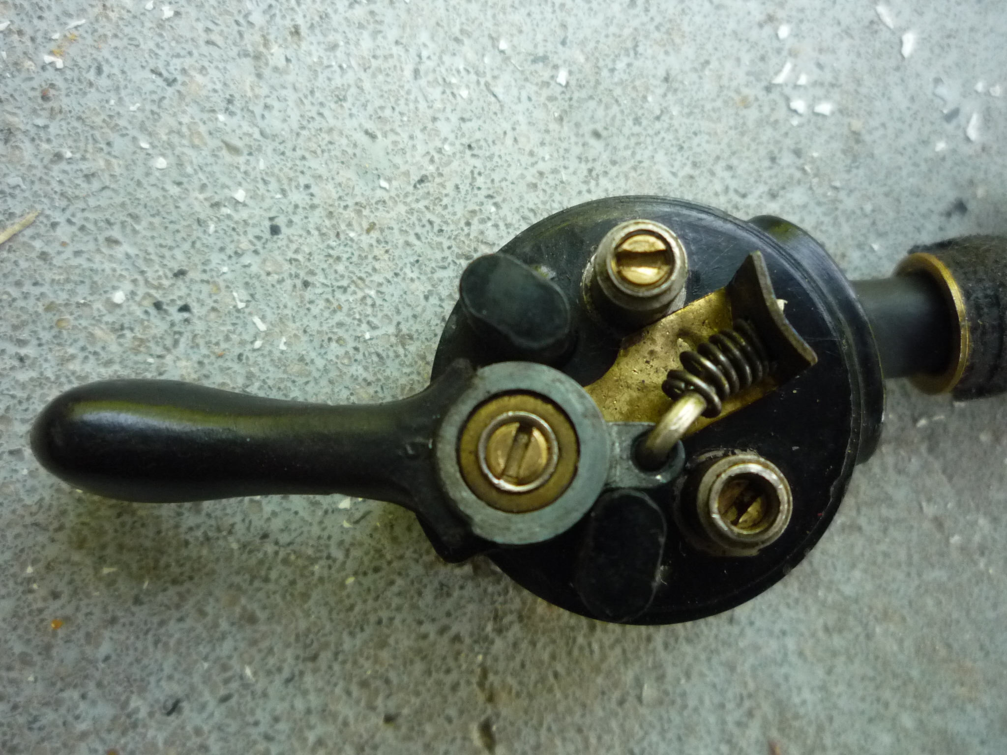

Ok I think I am seeing things a little clearer. The remote start is not going to work because it does not stay on and there is a chance my other switch will work if the switch stays closed. Has anyone taken apart an original switch? They are interesting inside with a spring in the middle between two poles with a brass plate that slides back and forth between the poles. I just cannot see how to make mine work. It is like the switch needs a 3rd wire or something. I really would like to fix this one.
Sounds like I need to get a new switch before I can do much testing. I could use a house hood light switch to see if the solenoid does its job and I guess there is an adjustment on the solenoid also; heck i am not sure if it works yet. I appreciate all the help, I think there is smoke coming out my ears.

Steve, I had a problem with the OD switch sticking so dismantled, cleaned out gunk, and reassembled with a thin coating of dielectric grease. I have a picture of the insides after that was done. The spring provides an over-center mechanism to assure quick, positive contact with no 'bouncing' of the contact.
Jeff

Hey thanks you guys. I do need to drive this car more and John thanks for the heads up on the OD. Tropic 6 do you remember how the wires fit in the switch? It looks like the center position is for off, and top and bottom are on. BUT it looks like there are 3 places to put the wires? The original switch I have looks just like yours. Now I think mine might work again.

Steve, Internals of that type were also used on dash headlight 'Main - Dip' switches on some cars (MG TC/TD for one). All 3 terminals were needed for that, but only 2 are used for an overdrive set-up. The center terminal connects to the relay ground, one other terminal goes to the gearbox cover switch(es), and one terminal is not used. When connected it provides a ground to close the relay contacts to power the solenoid - as long as a cover switch is closed. I can get a picture in a week when I can get to my stored pictures.

Thanks Jeff I think my switch is hooked up wrong and a picture would help. I do not remember a ground on the relay. Would that be a case ground? I do remember some switches using a ground to complete a circuit somewhere; I think it was some wipers or something.
