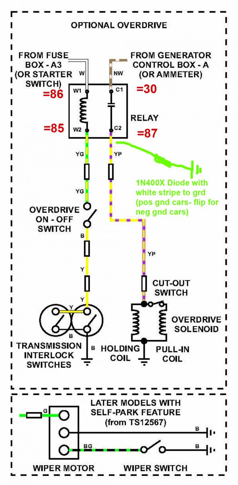

I have it wired the way John suggested which is the same as the book. The picture looks simple.

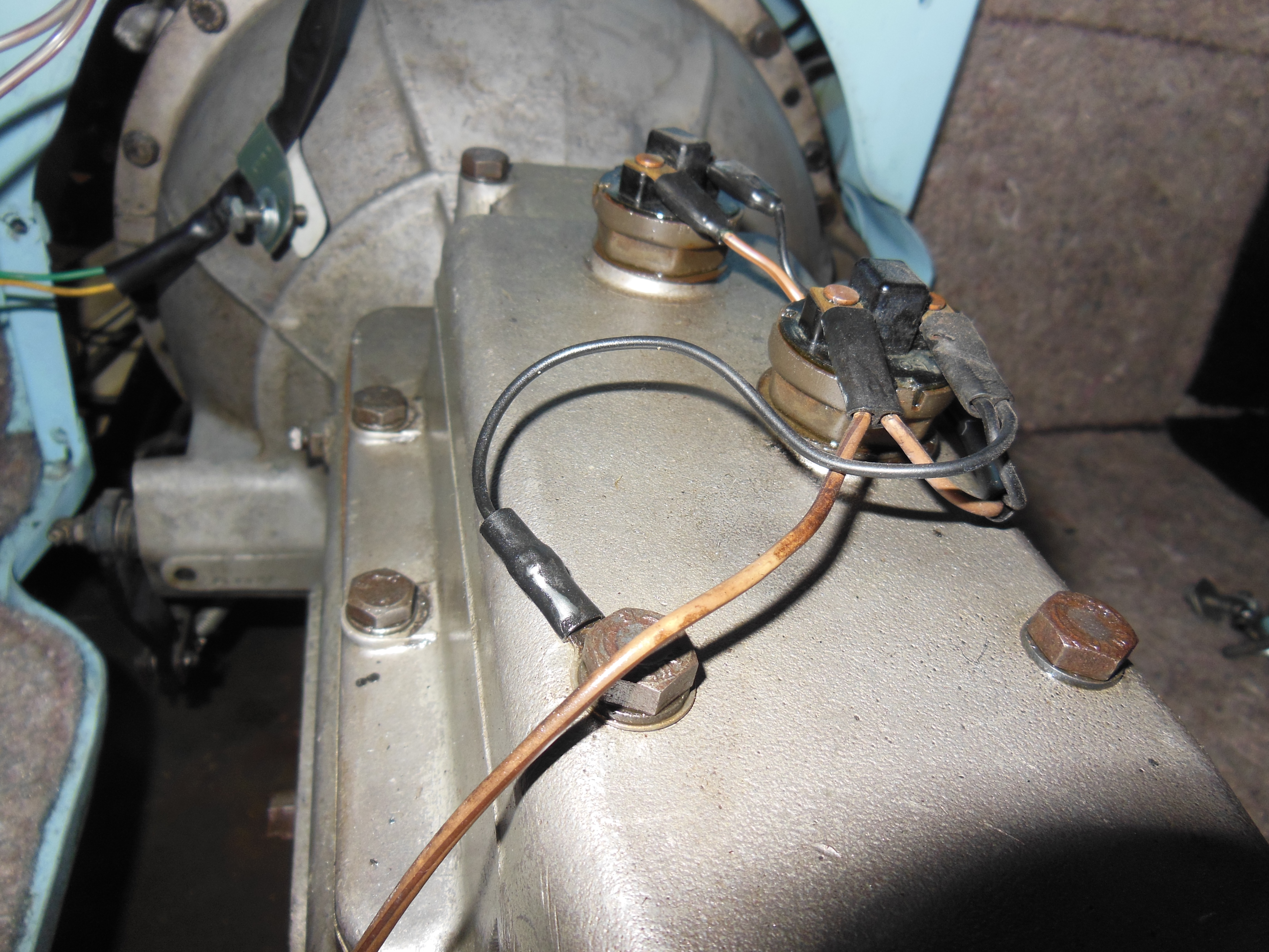

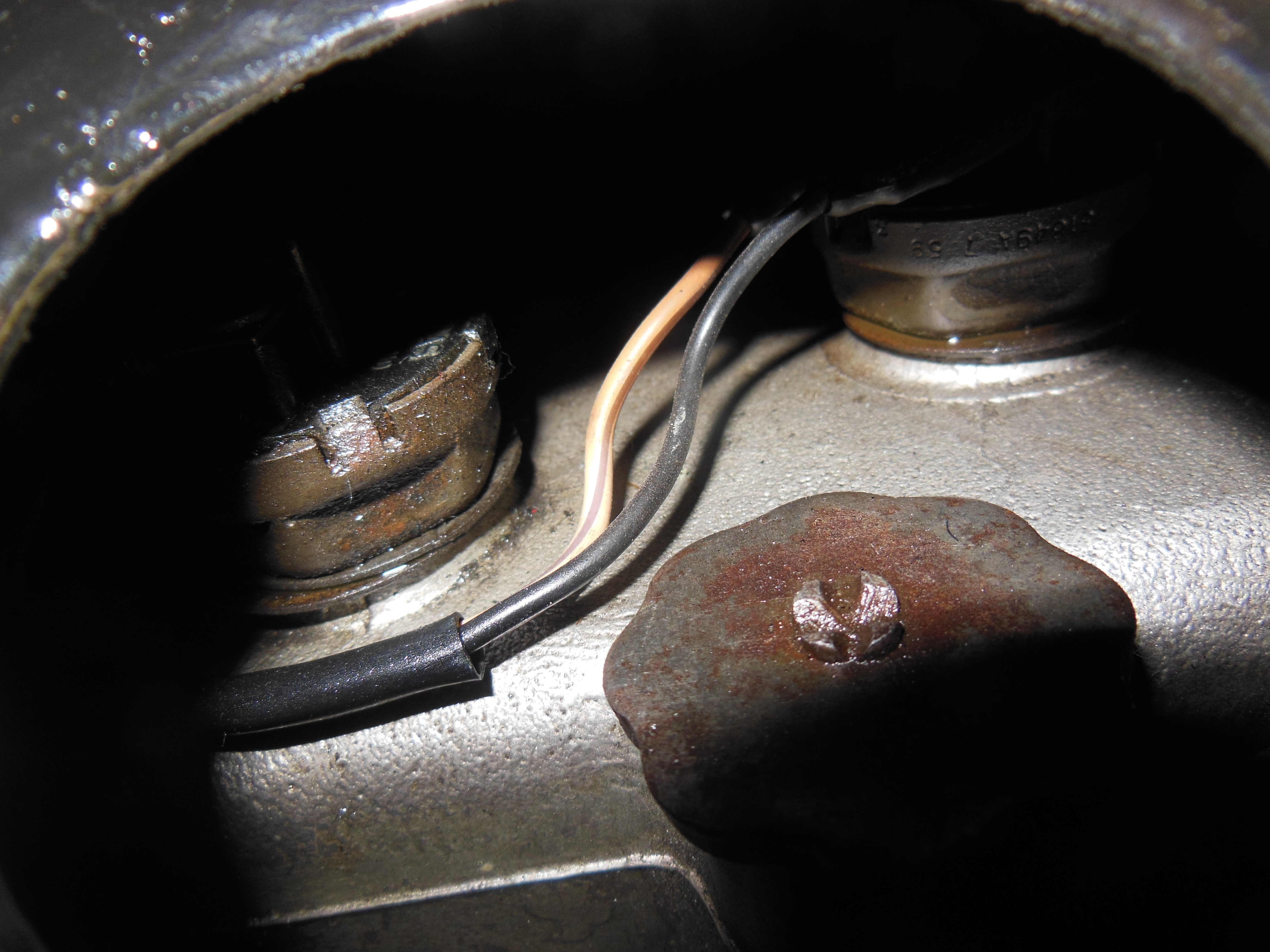

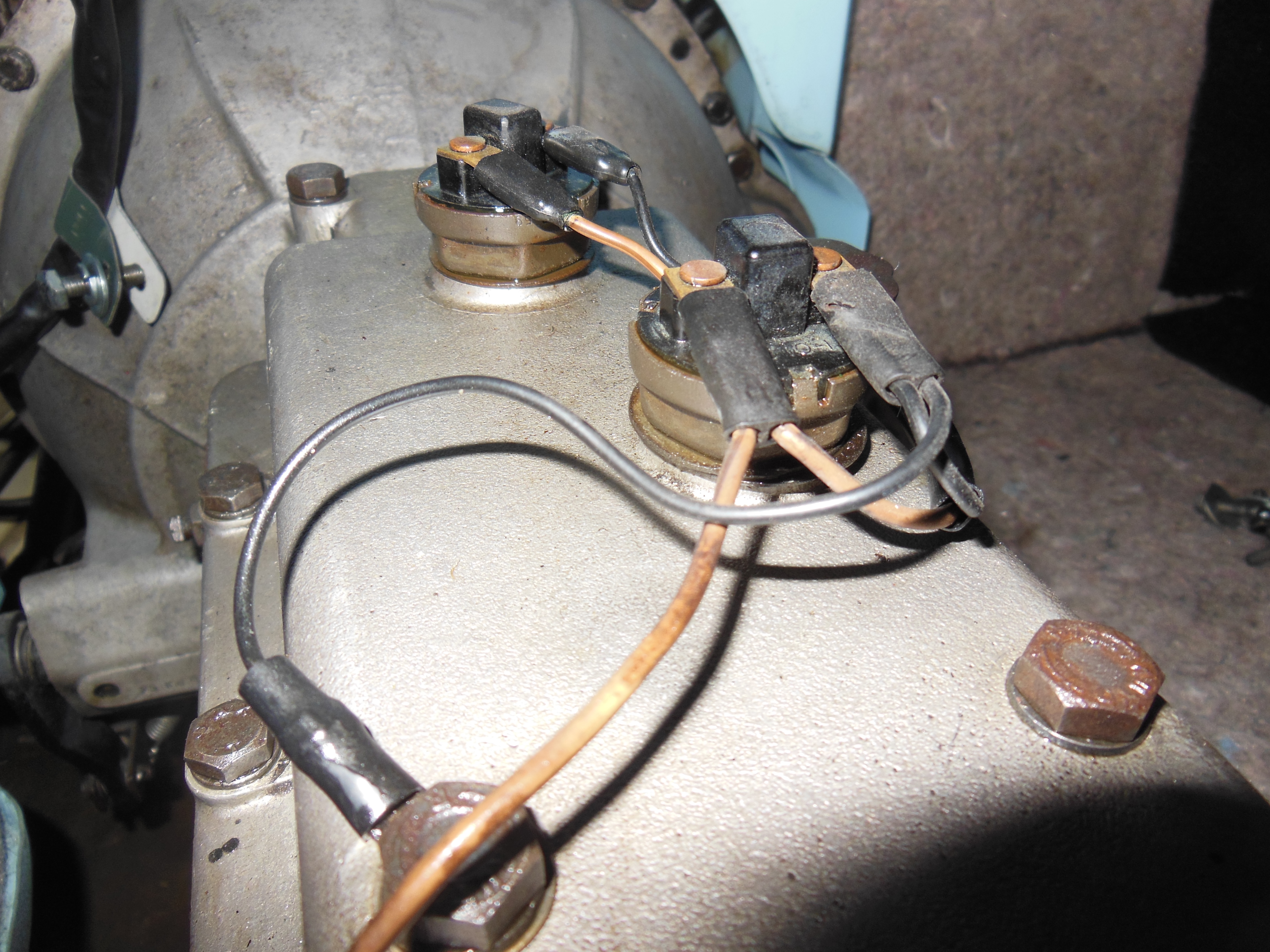

I took a picture through the oil fill on the tranny cover to help me see the wire for the trans switches. I think have everything correct
I have nothing at the dash switch plus I am not sure what all is needed to make the OD function. Should I be getting a click at the relay? Perhaps the lockout switches are causing the problem. Anyways I guess it is time to remove the tunnel.

I'm going to respond by memory. I ought to know, because I just went thru all this. Here are my thoughts (and I'm assuming your wire colors match the wiring diagram for a TR4-4A):
1) If you crossed the wires (the yellow, and yellow/purple), you likely burned a wire badly enough that you'll need to rebuild that part of your wiring harness. That's what happened to me. But if you did, it's highly likely everything else is fine. It seems Triumphs burn up lots of wires, but manage to confine the damage. I doubt your burned anything up. It's obvious. I thought I'd driven through someone's bonfire;
2) The yellow purple to the Solenoid can easily slip out if the bullet slide is loose, and mine did that, too. So, you're right. There's no way to fix that even with Hobbit hands unless the tunnel comes off. Without a good connection there, you'll have nothing;
3) The yellow wires each go to one pole of the switches. Those wires, once the dash switch is activated, receive power from the black wire of the dash switch that leads into them. I believe your other dash switch wire will be yellow/green, and that's the wire that leads to pole W-2 of the relay where it receives power to deliver to each yellow wire which, as stated, leads to the top cover switches. Be sure your harness has ground wires leading to the other terminal of each top cover switch and to a secure ground on the cover;
4) Double check the wires at the relay;
5) When testing the solenoid, I make sure the ignition key is on and the shifter in 2nd or 3rd, whether or not the shifter makes any difference;
6) Regardless of wire colors on your setup, make sure the dash switch gets power from W-2 (yellow/green) when the ignition is on. For me, that means that the yellow/green wire sends power to the black wire on the switch which, again, then leads to the two yellow wires leading to each top cover switch;

Further to my last post, I looked at your photo above, left. I'm not familiar with your car, but for mine, the lead to the top cover switches is yellow, and yours appears to have a brown or purple stripe. That would be wrong on my car. The yellow/purple goes to the solenoid. Solid yellow to the top switches. In fact, your own diagram is showing solid yellow to the top switches. Maybe you do have this wired incorrectly. Sorry if perhaps you already explained this.

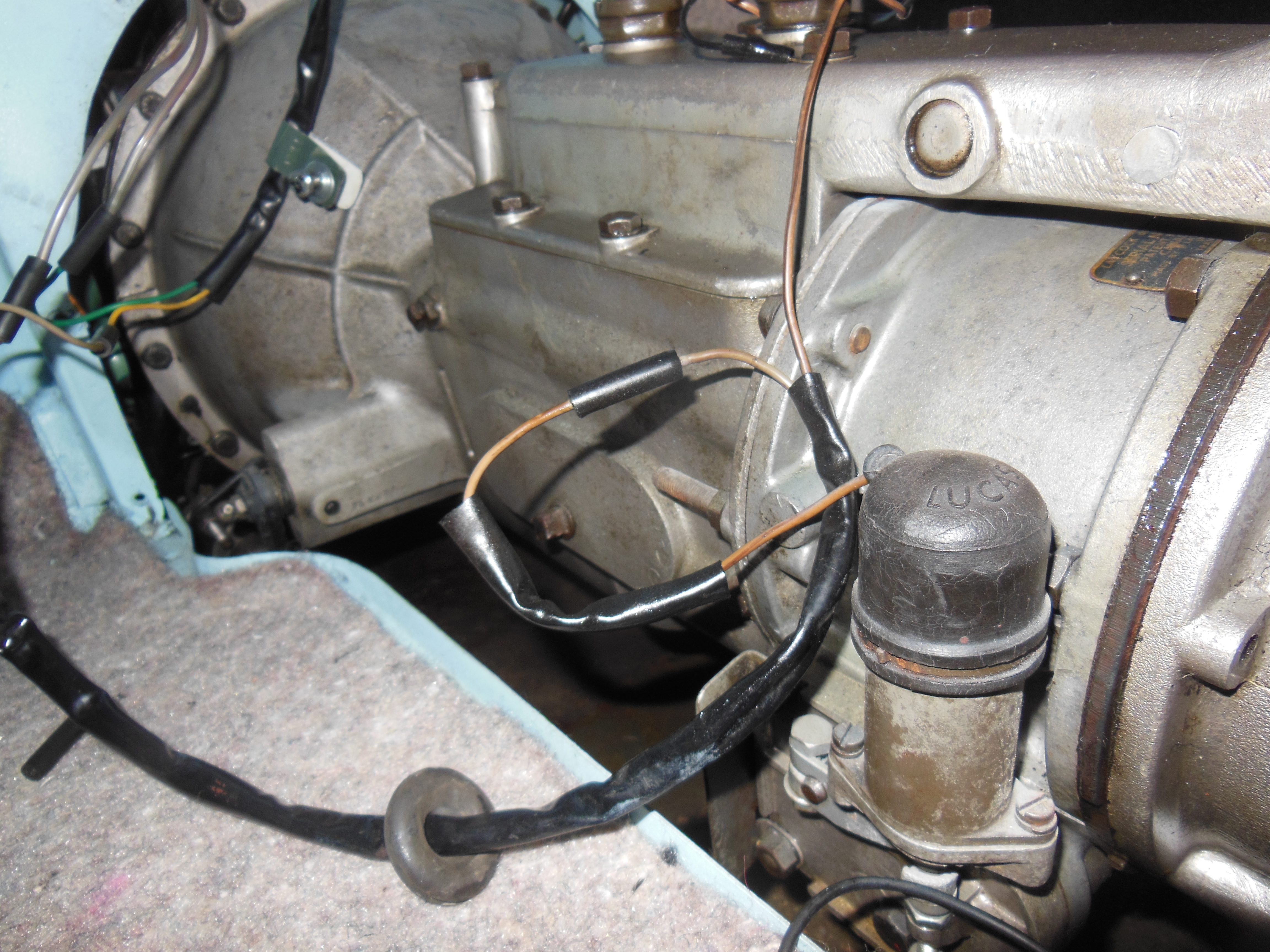

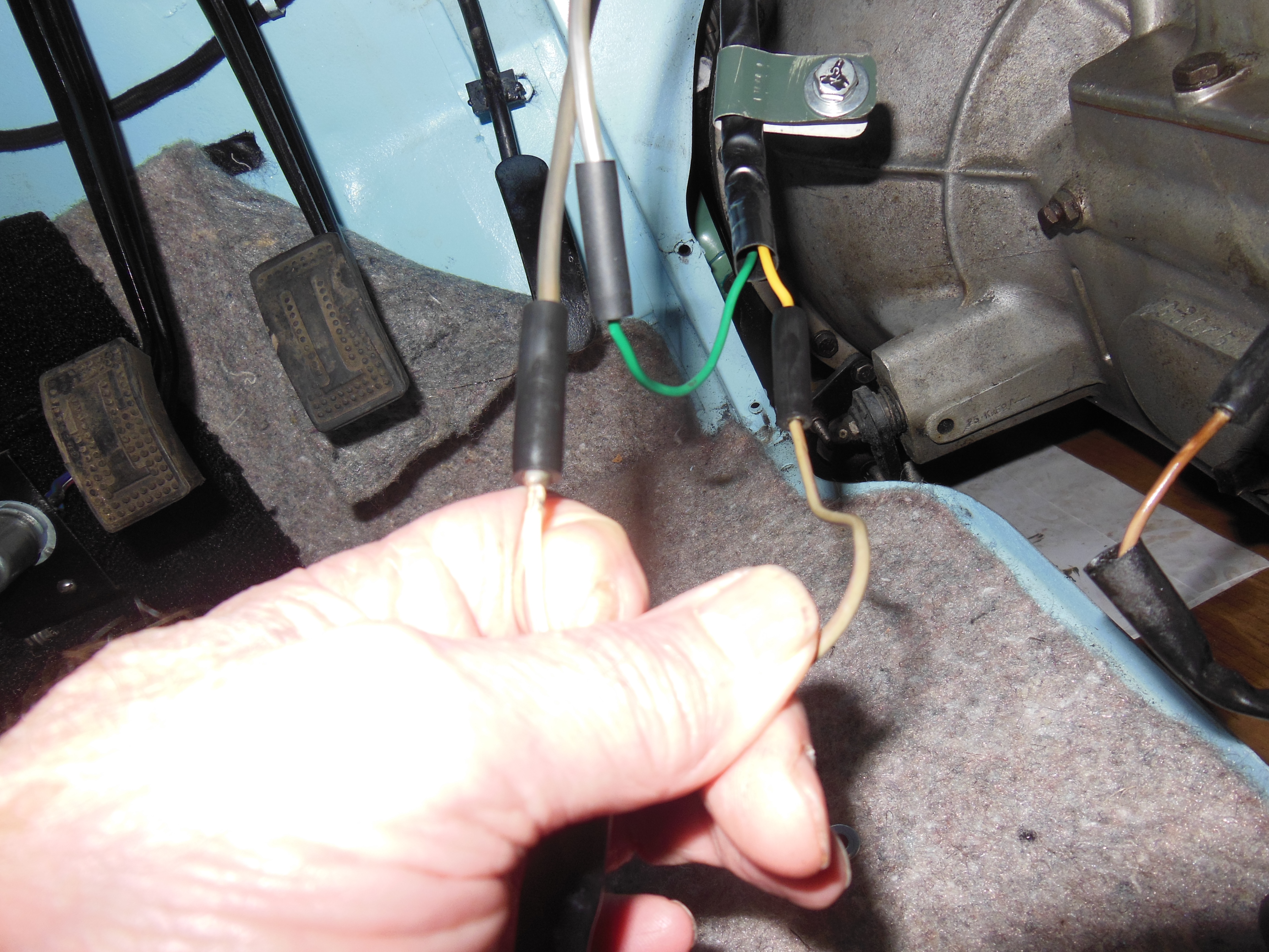

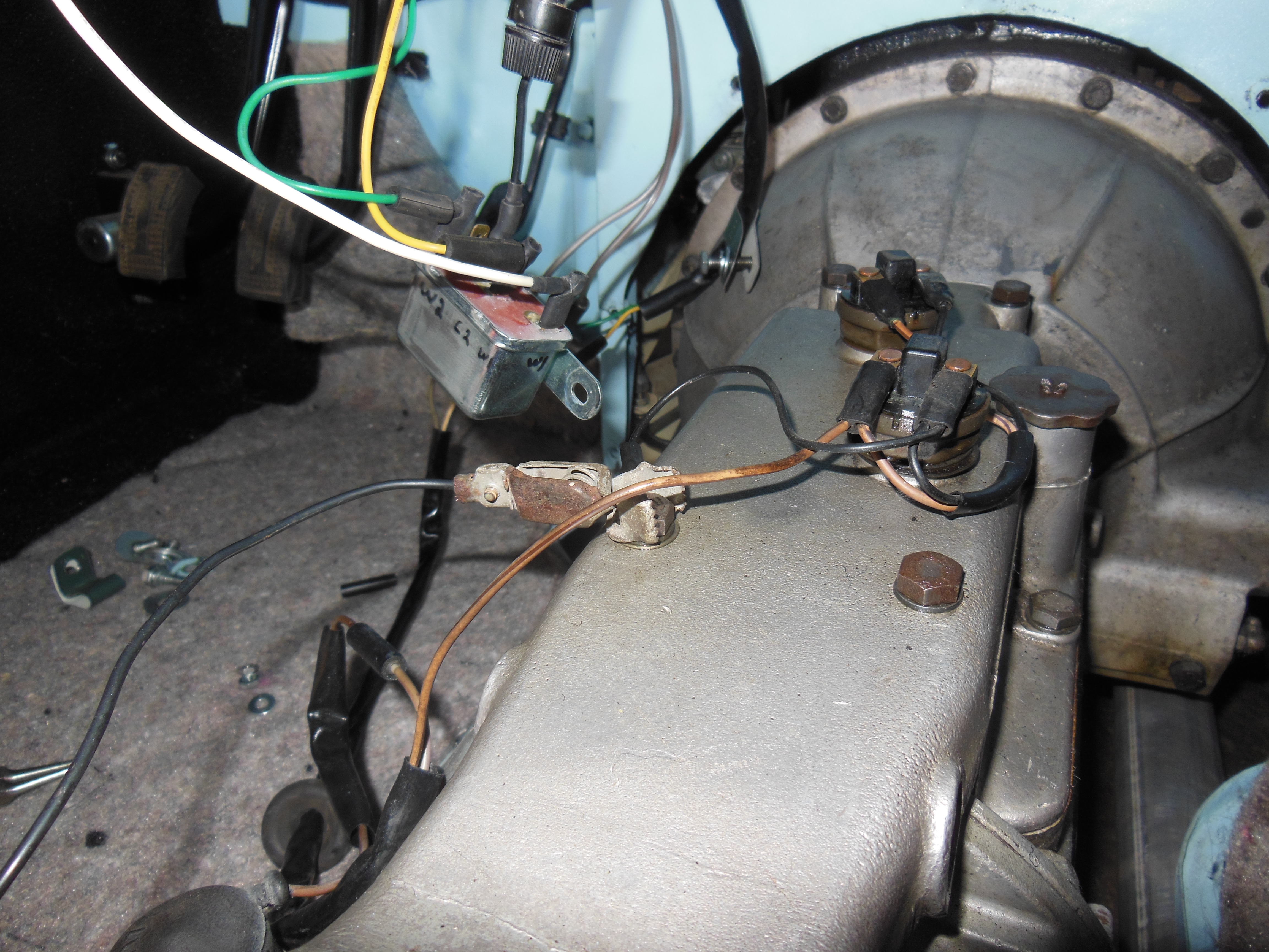

I took the tunnel out and did some testing. First I had no power at C1, and then I remembered Geo had me put a fuse in and the fuse was blown. I was kinda happy but thought heck just took the seats out! I replaced the fuse and pulled the over drive out with a new switch on the dash (one I found in a box), but it did not click. I was almost happy it did not work because that meant I did not take the seats for nothing. Perhaps I blew the fuse a second time-- I just thought of that; I need to check.
I put an OHM meter on the trans switches on the black side of the switch with the other end on the ground bolt for the switches, and there was continuity between all of the black wires. I moved the probe to white side of the trans switches and they were an open circuit.
I kinda do not know where to go from here so please guide other than buy a new solenoid and just put that in and see what happens. However, I see it needs adjustment, and I do not want to buy one. I want to clean and fix this one if possible. Somebody here said they cleaned one up and it worked; anybody have experience

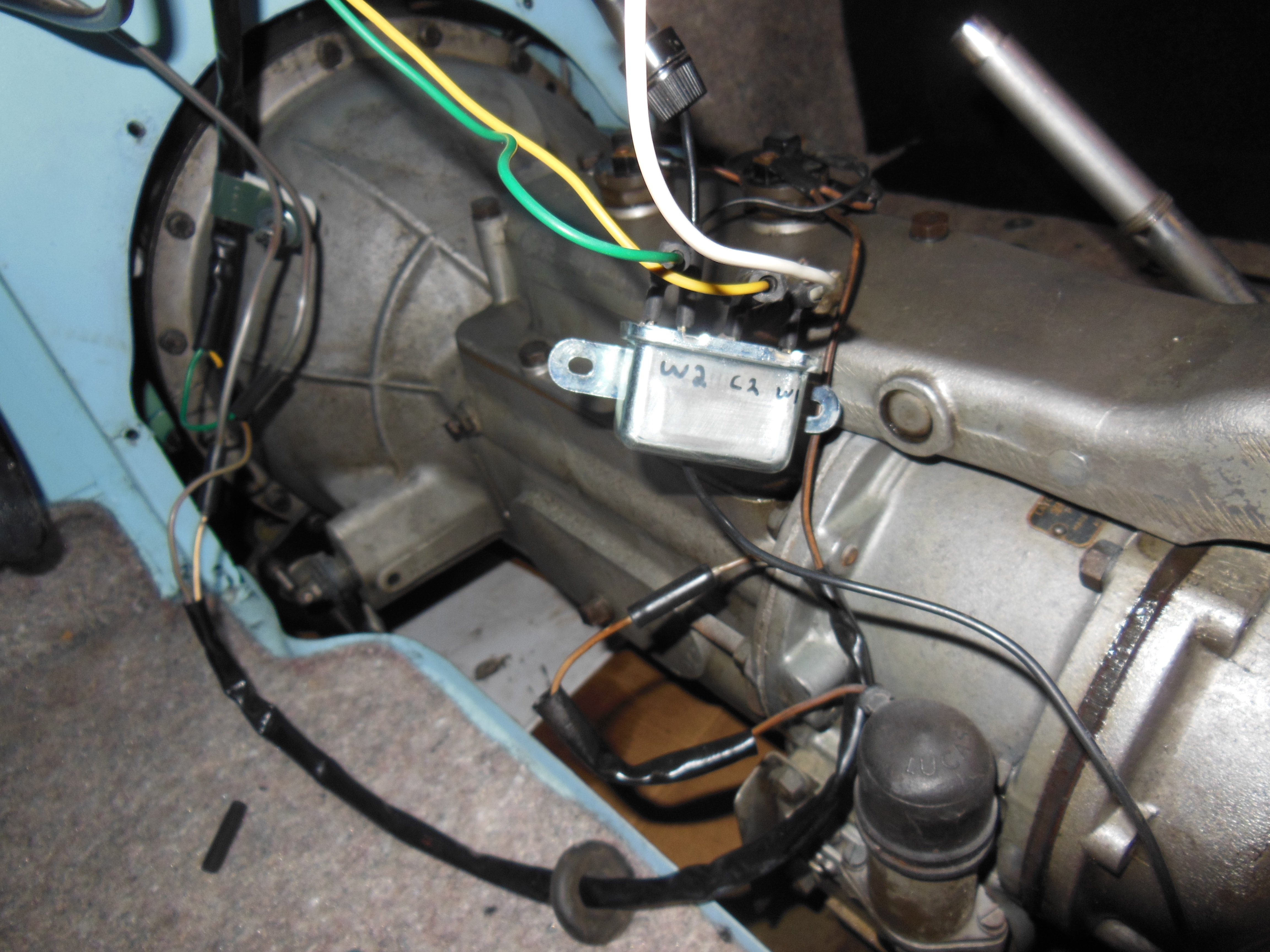

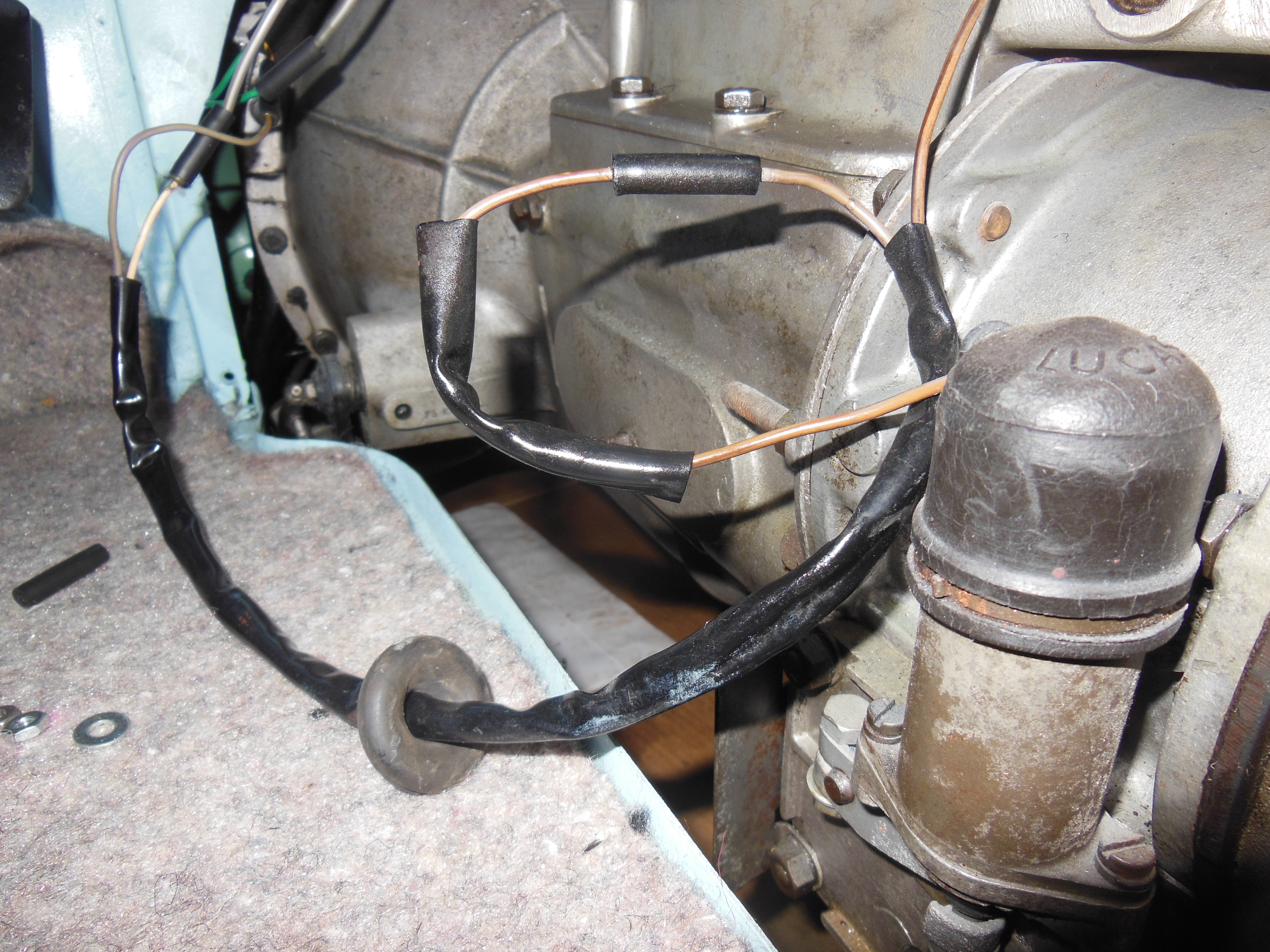

When you replaced the fuse, power returned to C-1? Better pics of your relay and connecting wires would help.
You said: "The other 2 wires coming out the side of the trans cover I ran the lockout switch wire through the dash- on off -switch and to the relay W2 then put solenoid wire on C2."
Are you saying your on-off switch wires go: one to W-2 and the other to both lockout switches shown in your pics?
You also said: "On the 2 hot wires C1 and W1, I used white wire and the W2 and C2 I used green for one and yellow for the other. . ."
I'm only seeing one white wire in your pic. I'm also not seeing a yellow wire on C-2.
The wire to your solenoid doesn't appear to be yellow. It appears to be yellow with a purple stripe. Further, your wires to the lockout switches are yellow with a purple stripe, and those wires (regardless of color code irregularity) do not go to your solenoid. I'm confused seeing the same wiring color coding to those three points of contact in your pics.
I think you'll get this thing working soon. You're on it. Hopefully, something simple.
OK, going from your pictures...
The double shift switches indicate that you have the later OD, and the wires look correct. With an ohm meter on the light colored wire, on either shift switch, the circuit should go to ground whenever you shift to 2,3, or 4th gear. At all other times it should not be grounded.
The light colored wire on the shift switches is the one that should go to the switch, and then to C2 on the relay.
Remember, the relay solenoid should only click with the ignition on, the dash switch on AND the shifter in 2/3/4.
If you want to test the solenoid, just run a jumper from the solenoid wire to a hot wire. It should "click". The top rubber cover comes off, and you can clean the inside of the solenoid. It has 2 coils. The main coil only energizes initially, but a short rod trips a contact that cuts out the main coil after the solenoid rod pulls in. The secondary coil is always connected to the wire. This means the initial trip of the solenoid energizes BOTH coils to pull the the rod with a lot of force. But, as soon as the rod moves, it trips a contact to de-power the main coil. That is why tripping the OD initially pulls 10 amps, but that immediately drops to 1 amp.
On my relay C2 is yellow then goes to the brown wire on the solenoid
On my relay C1 has the fuse which is black because of the fuse holder--- then changes to white out of the fuse and goes to amp meter.
On my relay W1 is white and goes to the ignition
On my relay W2 is green and goes to the switches
Sorry for the confusion the original wires are faded and difficult to follow. They are brown for the solenoid and white and brown for the switches. Where I went wrong is I kept the shifter in neutral. I am glad you told me about having to be in gear because I totally missed that.
John I think you might be incorrect about C2 because what I am seeing is C2 goes to the solenoid coils.
After I get some coffee I will hook up the shifter and check things out; oh I still could be wrong my brain was in high school in the sixties, so please advise. Thanks you guys. I love this forum.

"John I think you might be incorrect about C2 because what I am seeing is C2 goes to the solenoid coils."
Yes, I think John meant the lighter colored wires go to 'W-2' on the relay.
Gnawing question I have is this: What is the relay really doing, and why is it needed if we have both ignition and column switches to activate in any event? Is it somehow related to the need for higher power at the relay winding to operate the solenoid? I guess a refresher lesson would help. John?
Yes good question I do not know. Johns has been one of my best teachers so if he was mistaken earlier, it is totally coo. Hopefully he knows question.
Update, I put the car in second gear and turned the key on and everything seems to work. The relay clicks and the Solenoid has something moving inside of it. I presume from the relay clicking it when making contact for the circuits.
I am thinking I should put the tunnel on loose and go for a drive. However, is there some mystical thing I should know about Over Drives. I did hear to make sure the OD is turned off when you go into reverse. One thing I thought of was the gap on solenoid at the bottom with that screw. I guess it seem fine; it works and it seems solid.
Steve
You're correct, Steve, I was wrong. Old eyes?!?
Your wiring sounds correct, so long as the dash switch in in the wire between W2 and the tranny switches. Just read your last post...so wiring is good!
The relay is there because the solenoid takes at least 10 amps to activate. It reduces the amperage through the other switches, presumably so they will last longer.
