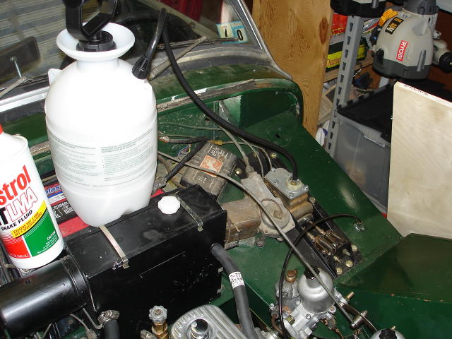

Here is the rig I am going to try out tonight. I'll put a quart of brake fluid inside the sprayer tank so that it not only pressurizes the MC, but keeps it full no matter how much I waste getting the bubbles out of the lines. I'll let you know how it works later!

Put lots of paper towels arounc the MC. You know it will leak a bit from under the cap if the o ring is not good and around the top if the seal is not good.
My thought at this point was to just use air pressure on the MC and check its fill from time to time.
Can't do this till I get another cap though. Be a bit.

Jack that is the way that I have done it.
I have seen it also done with the bottle, or rather I have done it with the bottle when working in garages.
Jack - I believe that is smoke overflow collector :devilgrin:
TexasSprite,
I made one of those rigs 3 years ago and have not had a problem with it. I use it every spring to completely flush my brake and clutch systems. I added a thick rubber washer inside the plastic M/C cap and it seals with no leakage.
Yep, I added a thick washer in side the cap as well as sanding the top of the entrance hole to get a good seal.
Also smoothed and leveled the bottom of the flat top plate so it was very level and smooth as well.
No leaks now.
