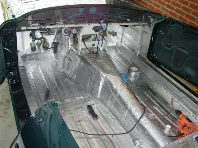

OK,..so it's time to install the interior. Is there anything special I should know about installation.?
I have a carpet and panel kit from Proper Mg,..seems pretty straight-forward, but in my year as an LBC owner I've come to appreciate that things aren't always as they seem! LOL
They've sent chrome screws to install some of the panels with. Do I really want to use them, or can I use a contact adhesive or something of the like? (not for the doors,..I have the clips for them, I mean the footwell and rear panels)
I was getting a ton of heat from the footwells and tranny tunnel, so I got some good foil-backed insulation. Do I install that along with the sound-deadening kit,..or cut pieces for the footwell and tranny tunnel from the heat insulation, and leave out those parts of the sound deadener?
Any thoughts would be greatly appreciated!

When I restored the interior on my 78 B I left out the factory insulation and instead covered the entire inside of the car with Fatmat (which is probebly simular to what you have- 1/4 inch rubber on one side with head reflecting foil on the other side) I put down 3 layers on the floors and trans tunnel and it is well worth the trouble, as the heat and noise are drastically reduced. I also used the VB interior catalog to help with the carpet ,seats and panel installation. This is the best part of the restoration as it is all comming together. I have attached a picture of the insulation before carpeting.

Good advice from PS I would add, Use the screws around the door openings on the rear panals and the outer side footwells. that will prevent anything from pulling them out by accident. Also, make sure to do the "lift-a-dot" studs for the top around the rear panal and the cockpit edging BEFORE you put any of the rear interior in, as the interior covers access to many of those fasteners.
This is the fun part of your resto(at least it is for me), waching it start to look like a car again, enjoy!

Paul, thanks,..I will go without the factory insulation, and go with a few layers of the heat insulation all over. It makes alot of sense!
Banjo, thanks for the tips about the panels, they'll be put to good use!
