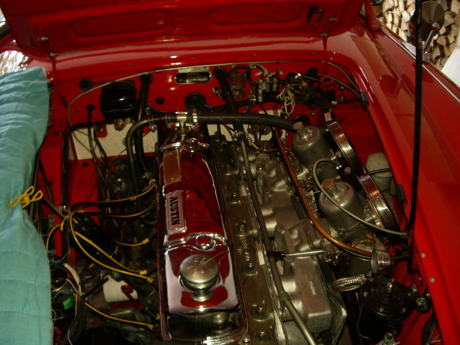

During my firsts road tests of the car, I have find that some oil is sprayed on the hood RX side, This occur when the rev are from 3500-4000rpm, but not when engine are stationary and hood open.I have siliconed also the two plates on the head cover.
I have changed

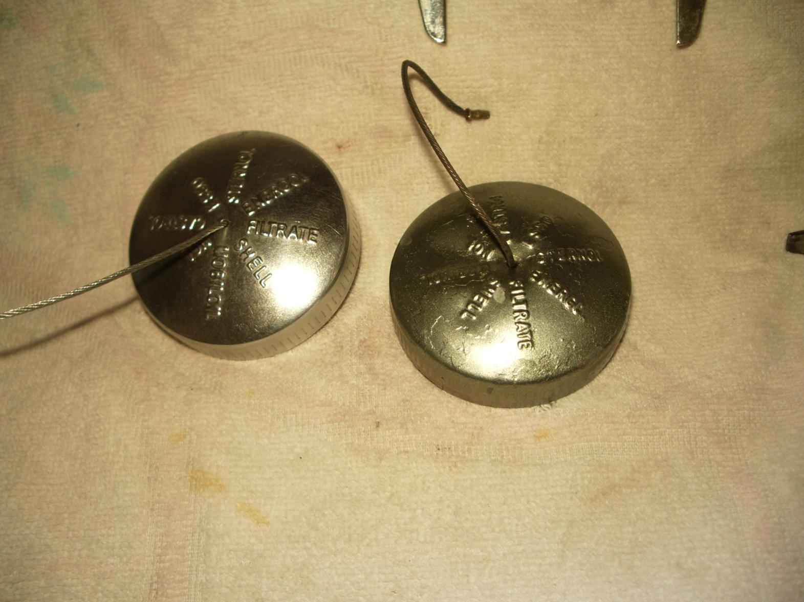

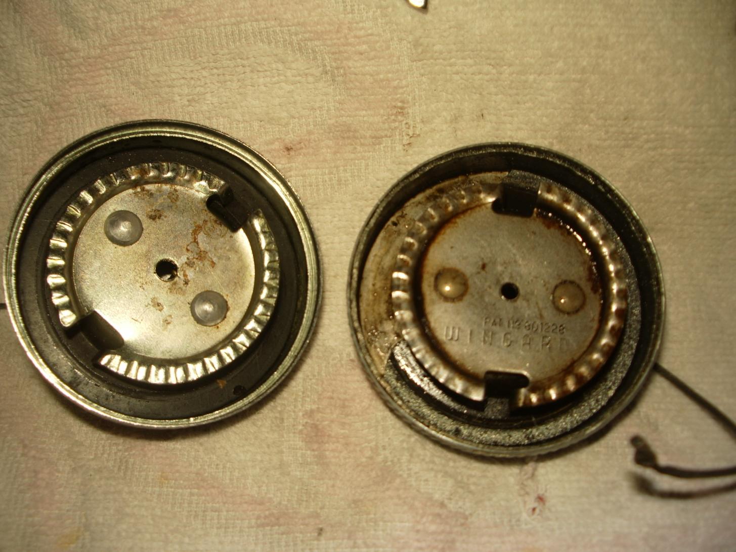

the engine oil sump exhaust gas configuration,from filter IMGP2151.jpg to the classic pipeIMGP2171.jpg The TOP oil filler is NEW, and I revert to the OLD in very bad condition (rubber is broken)
IMGP2174.jpgIMGP2175.jpgmeasurement are the same, and all appear correct.
I have changed
the engine oil sump exhaust gas configuration,from filterView attachment 28899 to the classic pipeView attachment 28900 The TOP oil filler is NEW, and I revert to the OLD in very bad condition (rubber is broken)
View attachment 28901View attachment 28902measurement are the same, and all appear correct.

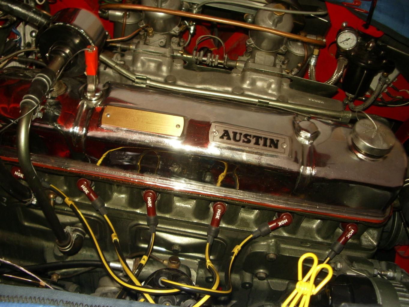

NOW,after more than one liter of good oil loss, and a lot of paper used to cleaning the under part of the hood i have finally find the cause of my nightmare
On my valve cover -recently chromed- there are a micro fracture (probably due to a dent repair before the chrome process) very hard to find, I have siliconed it with a little amount of silicon
and the loss of oil disappeared- my engine bay is now perfectly clean

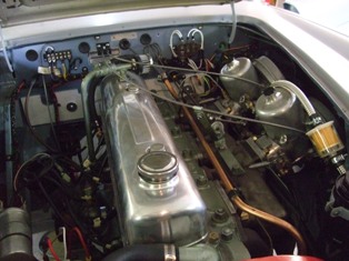

I've attached a pic of the small air filter that I have put on the 'T' fitting at the rear of my valve cover. I have driven the car about 500 miles with this arrangement and I am very happy with the results. There has been no oil appearing on the filter element as yet and surprisingly I also have no oil dripping from my rear main seal anymore as well. It is not marking it's territory anymore. I have a cast aluminum valve cover that has no baffles. Dave.
