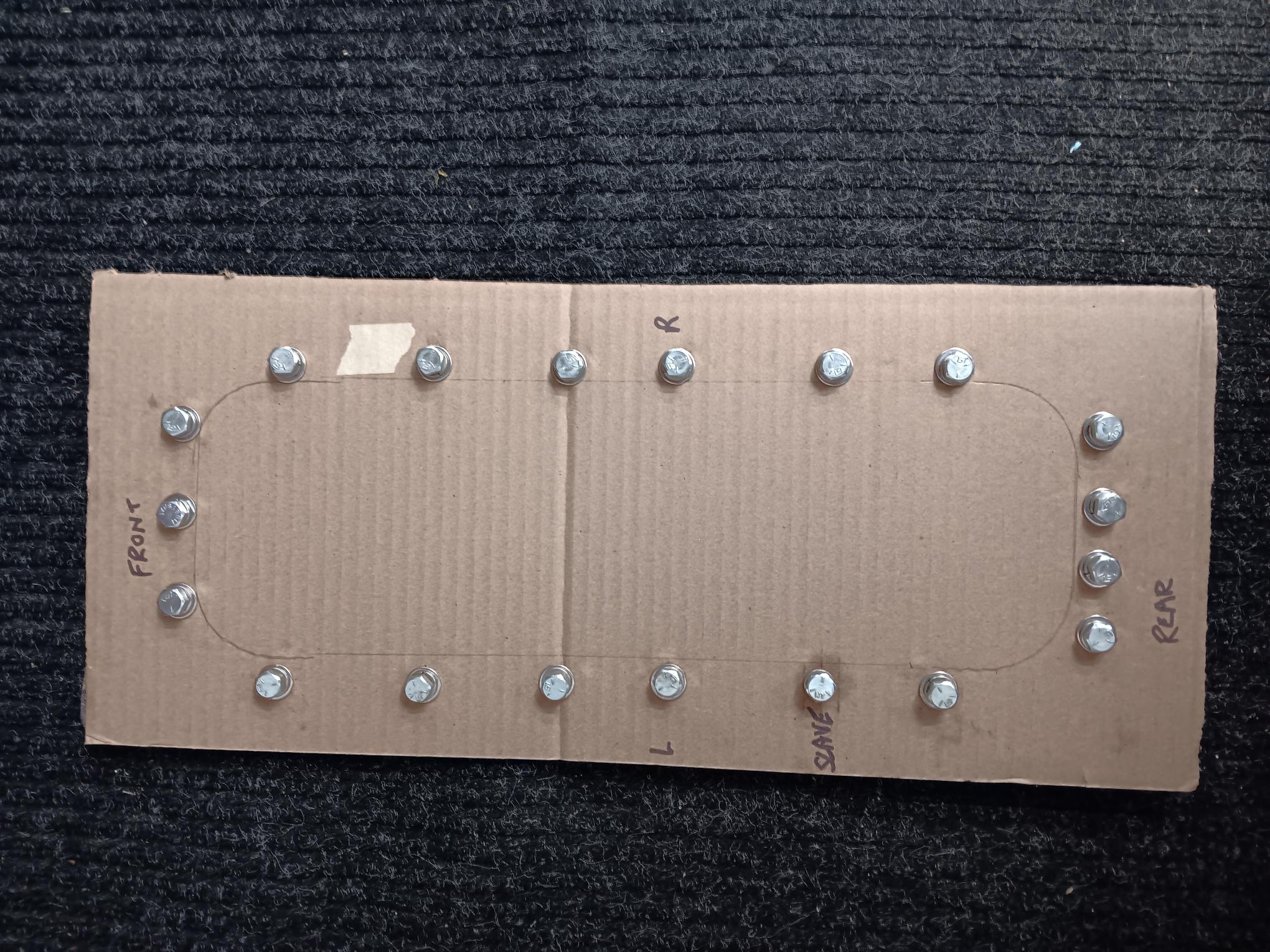

This is what I did with my OEM oil pan. I bought a sheet of gasket material and got a pro to cut it for me:
I like them Hamish, I can imagine how well they will work with 3/32 paper gasket and some non-hardening permatex, that I will try it soon.

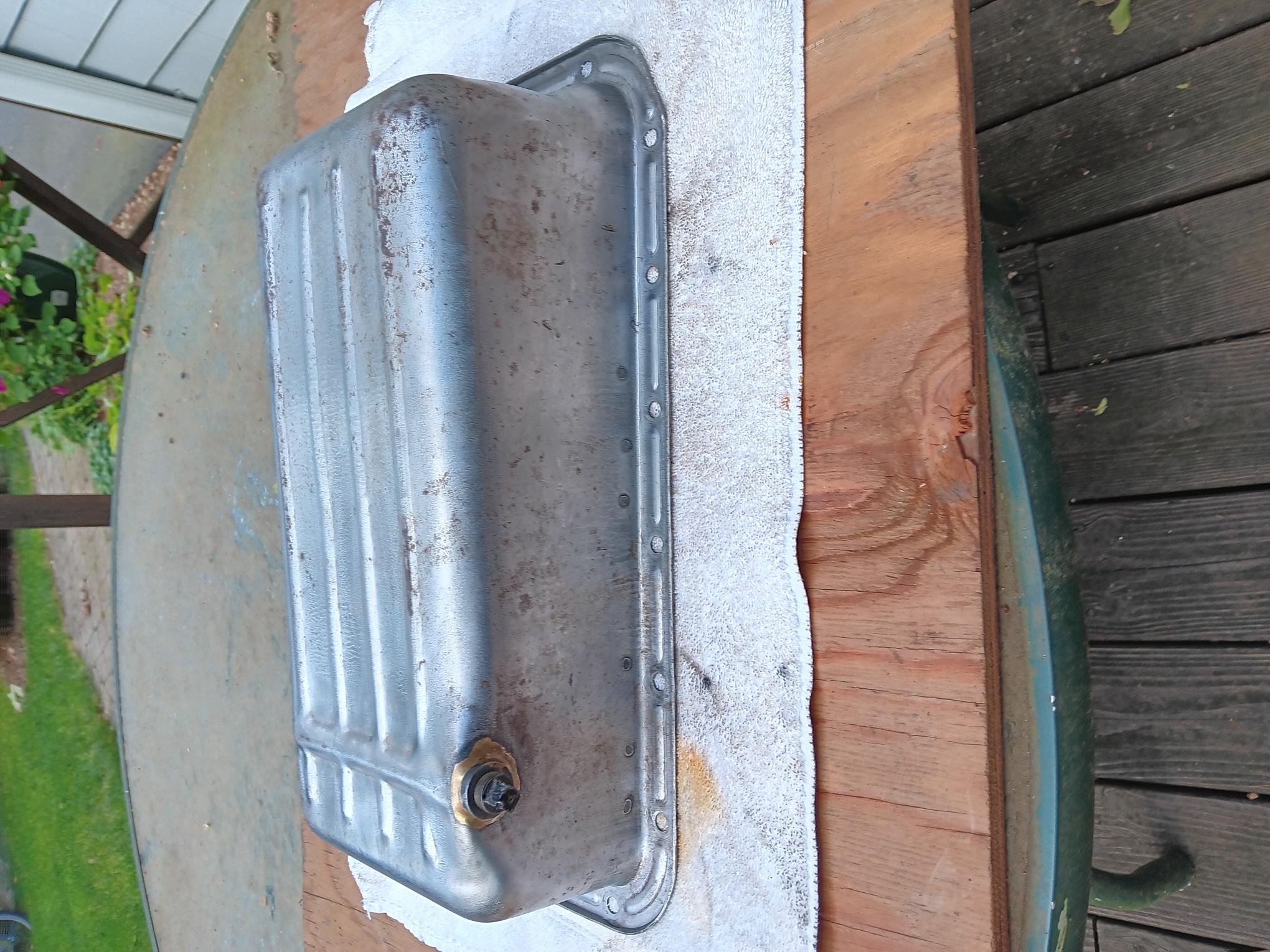

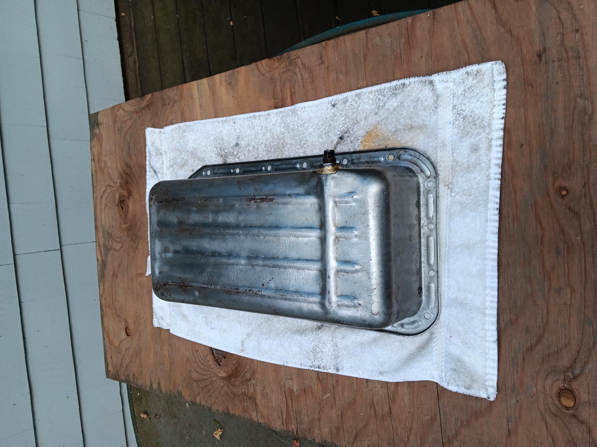

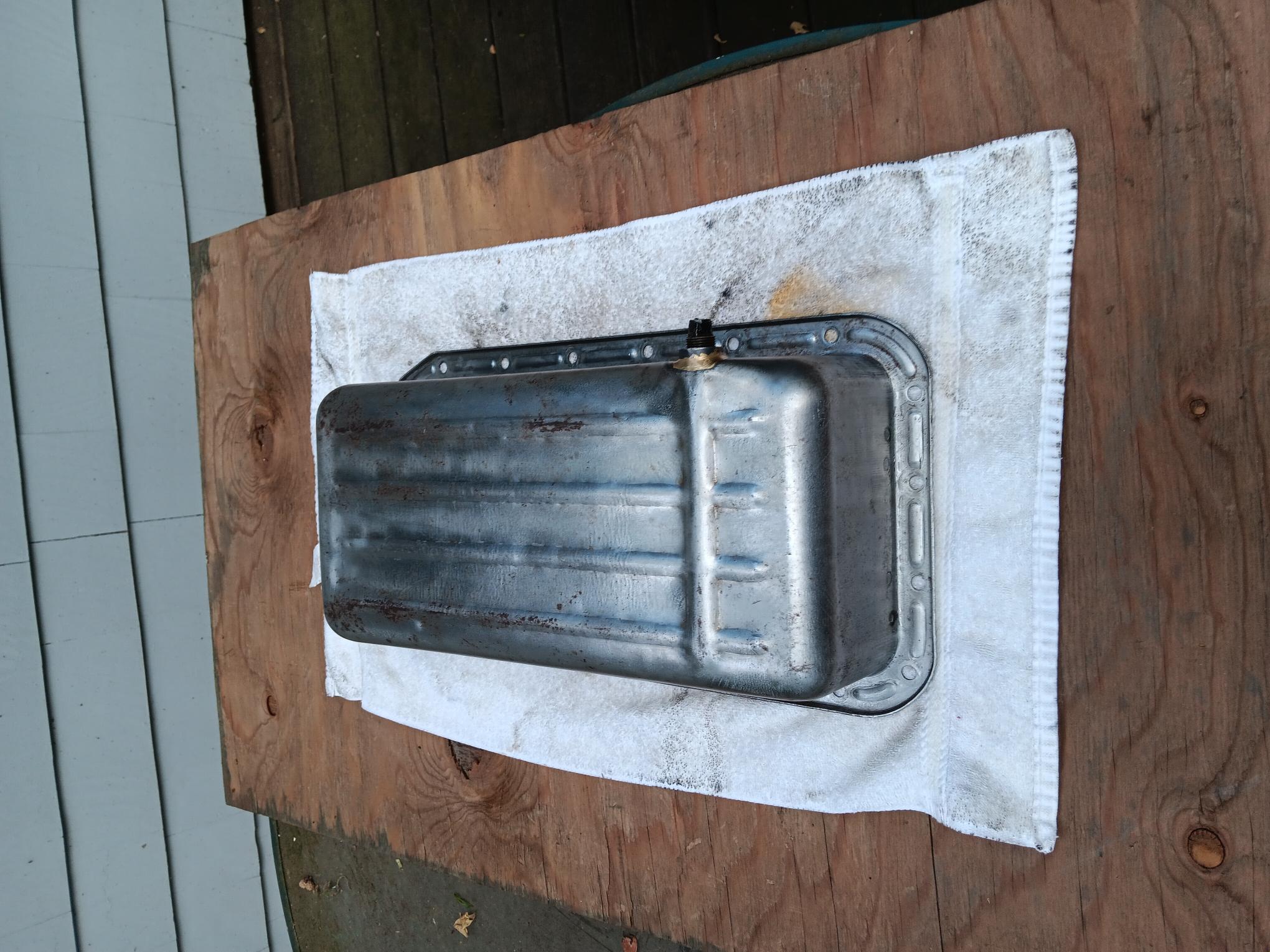

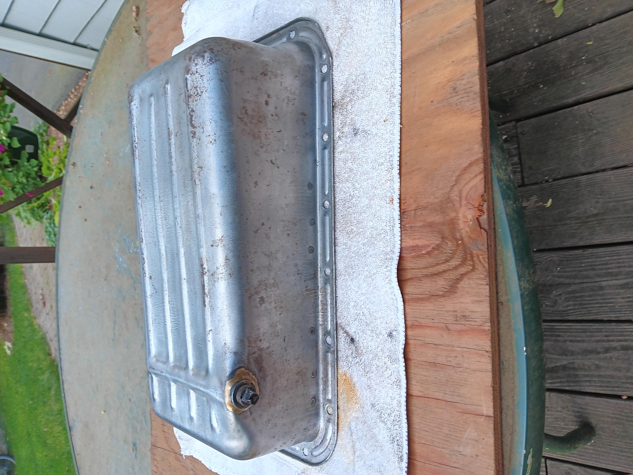

OK, not sure it shows in these pictures but, a lot of work went into cleaning up the oil pan. Removed all the oil RTV Black Max. Used acetone to soften it, a razor to scrape most and then finally a wire wheel to lightly/carefully remove the last bits. Then removed remainder of old paint. Then spent most of yesterday on the work bench straightening the pan. When I did this 8 years ago, the pan was straight. Simply shocking how bent it got when I remounted with the cork gasket which is 3/16" thick (mistake #1), used RTV (mistake #2) and then torqued to spec at 18 lbs-ft (mistake #3). I will not be repeating those.
Flattening the pan took several hours with various tools (straight edges, large ball peen hammer, small ball peen hammer, 15mm socket, wood dowels I made). But, checking with a long straight edge, I was able to get it flat to under 0.008" in all places, and less than 0.006" in most. The corners were by far the hardest (it is nearly impossible to get it flat to satisfy the long edge of the pan and the short edge of the pan at the same time - if that makes any sense). Then finally cleaned it up by lightly sanding with 400 grit and then going over it with a Scotch pad.
When I re-mount, I plan to go with a paper gasket, torque to only 10 lbs-ft and only dress the front sealing block (likely with Permatex #2 80015) and the the corners (for reasons noted above) (likely with Permatex #3 80019 (equivalent to Wellseal) or Permatex Permashield 85420 (equivalent to Hylomar). The rest of the gasket will go on "dry". If that doesn't work, at least it will be easy to pull down again next time.
Now I just need a day where the humidity isn't 100% so I can shoot the paint. I plan on using Eastwood 2K Hi Temp Ceramic Engine paint. Oh, and I still need to clean the block - that should be a good few hours of fun under the car...
Pictures attached of pan and fasteners. Those are grade 5 bolts with flat washers and lock washers.

Sounds like an excellent plan to me. The oil pan is beautiful plus you have an excellent assistant.
I am not sure what to think about the bolt holes. I have been using the old bolts and feared the oil was going down the treads of the bolts and weeping out. I for one am waiting to see what happens, good luck and I think you have done about all you can to prevent a leak.
steve

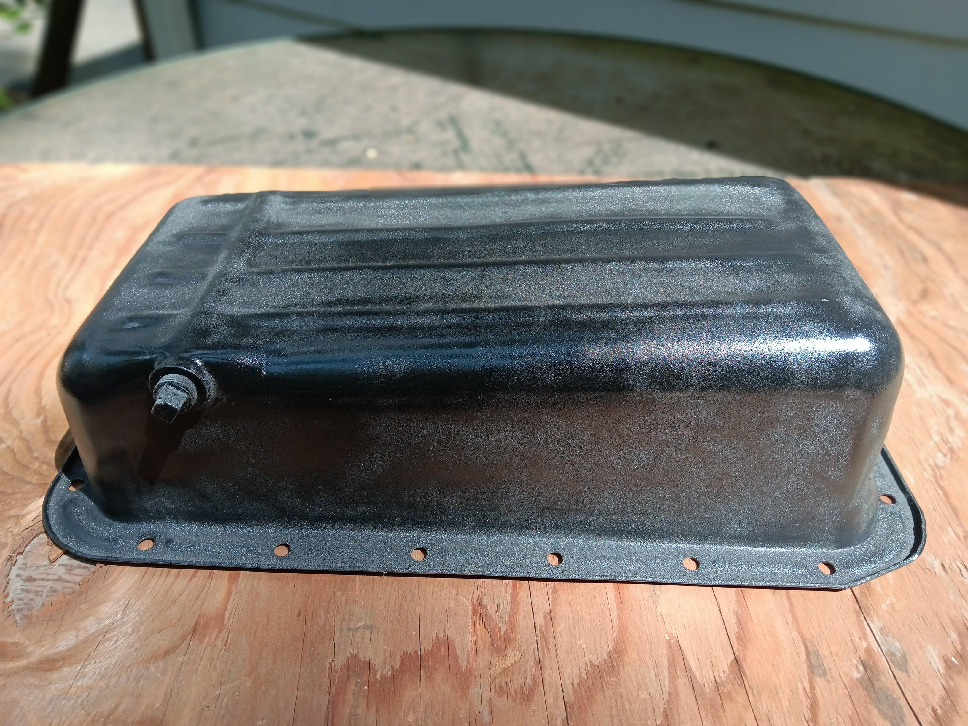

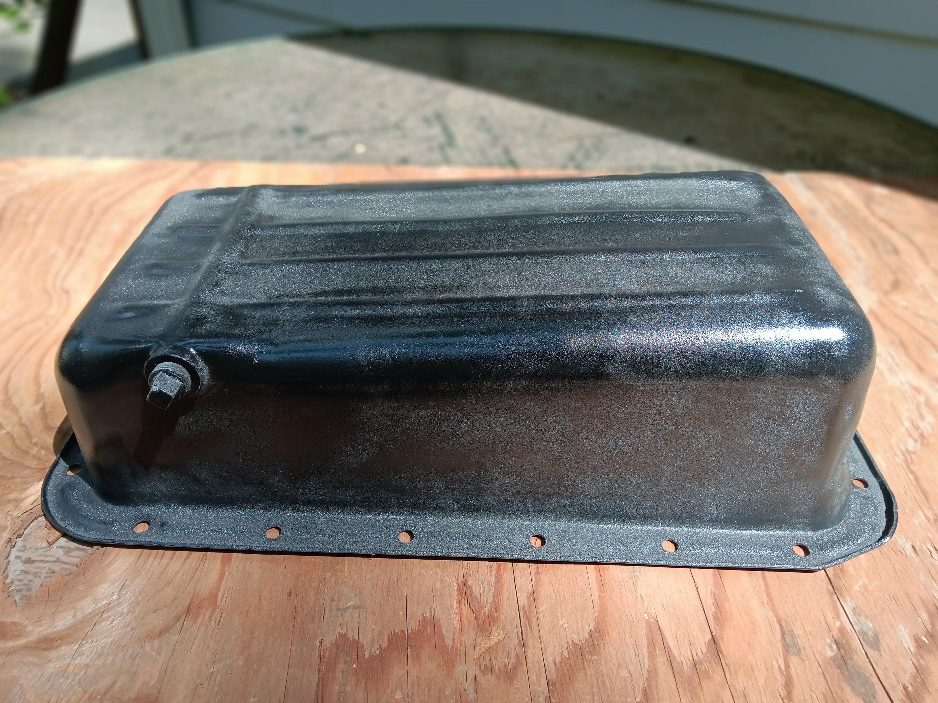

OK, been way too long...my last post was over a month ago. A confluence of items got in the way and limited my time under the hood (including summer vacation which took me out of town for two weekends). So frustrating because I missed some prime driving season.
I finally got the pan painted with Eastwood 2K high temp epoxy primer (2 coats) and 2K epoxy engine paint (see photo). Decided not to touch the sealing block. Decided to use the Payen oil pan gasket. Payen part no. HC016. Moss Motors part no. 692-000. The face of the gasket was also marked with "Interface Performance Materials N-8092".
Applied a thin film of Permatex 85420 Permashield Fuel Resistant Gasket Dressing & Sealant (equivalent to Hylomar Blue) on the pan, the block and both sides of gasket. Torqued oil pan bolts to 5 lbs-ft, 10 mins later to 7.5 lbs-ft. 24 hours later to 10 lbs-ft. Installed oil pan drain plug – used Permatex 80631 (14A) Thread Sealant with PTFE. Torqued firmly snug but, not overly tight.
Waited 48 hours. Filled her up with 5 qts Valvoline VR1 20W-50. Measured to 1/3rd from bottom line on dipstick. Pulled the spark plugs, spun the motor until I got oil pressure (50psi after 15 seconds spinning on the starter). Installed plugs, fired up instantly. Idled for 15 mins and pulled back in garage. Will take for a longer drive tonight and report back

Just to report back, I've driven about 80 miles with the new oil pan gasket. There was a tad bit of oil on the pan but, no drips/drops. I re-torqued the bolts at 10 lbs-ft just to be sure. I will say, all the bolts tightened a bit more (maybe having been through a couple of heat cycles). It was not obvious the oil was coming from the pan. There was a decent coating of oil on bottom of the oil filter housing. I checked the torque on those (22-24 lbs-ft). The bottom-most bolt definitely was not to spec and took about another 90 degrees with the torque wrench. I also suspect I need to renew the o-ring on the spin-on oil filter adapter. There was evidence of oil leaking there too (another project...). Last, my timing chain cover gasket and crank seal were renewed in 2017. I think those are still good but, it is possible I have a small leak on the front engine plate (which I have no idea how to re-new other than pulling the engine).
All in all, much less oil than before and I view this as positive progress. On positive note, there was zero evidence of any leaking from the rear main seal (scroll seal).
Will continue to report through the rest of the driving season here in CT
Bob
