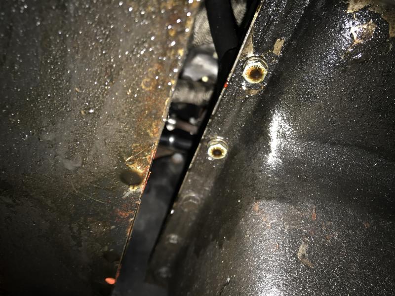

Oil pan leak?
tgsanford79
Have not crawled up close close yet but curious as to what others think based on the pic. ‘79 1500.

Mine continues (i think) to leak - something does. Over tightening the bolts warps the pan and, I have stripped both bolts on the aluminum piece at the front seal. Keep us posted.
7 lbs. max torque Pull Pan, place edge over flat steel. hammer dimples flat, new Gasket, sealer, reinstall.

According to two different sources I checked, 1500 engine sump to block is 20 ft lbs. A-series sump to block is 6 ft lbs.
That's not a leak. That's the chassis self-lubrication system.
If I didn't know better, I'd think you crawled under my car and took a picture. I go through oil at a fairly prodigious rate, but I'm definitely dropping more than I'm burning. At some point, I'll yank the motor and fix it.
