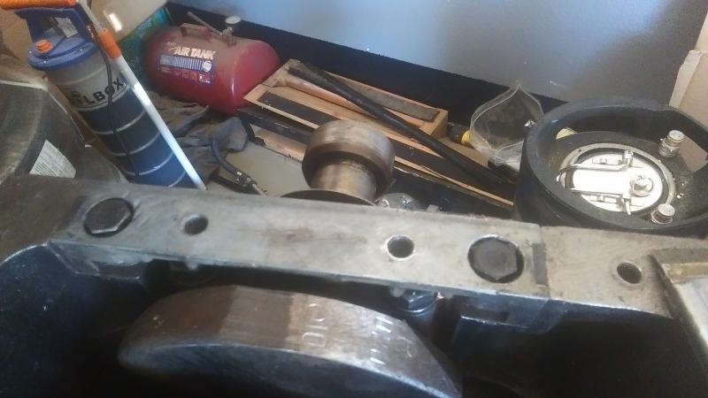

This may have been covered before if I could think of the right name for it, but at one end of the engine there's a sort of bridge that goes over one of the crank journals, with a recessed hole for the bolts to fit in - once they're in to a certain point, it's not possible to get a wrench or socket on them. They won't be able to come out because of the pan, and the other side of it is the timing covers, so probably intended for oil to find its way there, but it still makes me nervous.
I can find videos online showing that Spitfires at least have the same piece, but none seem to actually show it being installed or mention it.
What's the right way to install those?
That was my first thought...flat head screws that fit inside the recess completely.
For the end seal, I goober (highly technical term for saturate completely) a strip of felt with gasket sealant and stuff it in until it pops out the opposite end. Once it starts to harden you can trim the felt flush and install the oil pan.
Properly too late now, but it was a wood wedge at one time, even came in the kit for bottom end.
Wayne
The kits do still come with the wooden wedges. You can also carve your own from paint stir sticks. Regardless, they both have to be shaved to fit and tapped into place with a bit of sealant.
Richter, if you have not installed the sealing block yet... hold off for a few days. Either find a 5/16-24 HeliCoil kit or someone who has one. The sealing blocks are notorious for having their screws strip out resulting in a nasty front engine oil leak. The HeliCoils make the part much stronger. At one time there was a guy on eBay selling billet blocks he made from steel. (Footnote on the HeliCoils... two of the holes are very shallow. This makes them trickier to install and you may find you need to shorten the HeliCoils by cutting off a winding or two).

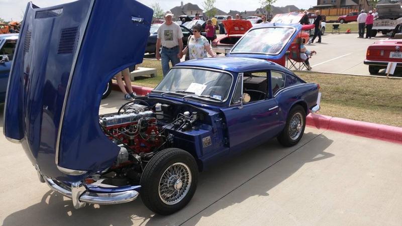

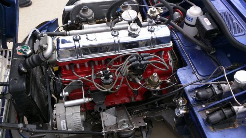

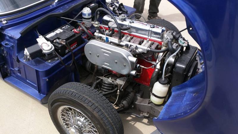

Drove her down for a car show on Saturday. (Conveniently right next to the same Kwik Kar that was at the limits of overheating.) Didn't win, but the ones that did win all definitely deserved it, lots of neat cars there, although we may have been the only Brit.
