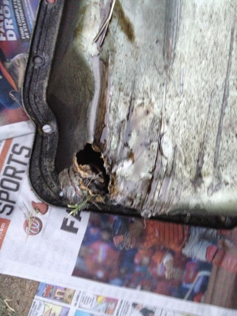

While driving to Eureka Springs for this years Tri-Healey Meet we were driving on a nice twisty MO two lane. As we came around to slight downhill left hand curve I saw something in the road. I couldn’t go right, no shoulder, and made a snap decision to go over – Wrong Move!!
After a very loud clunk/crunching sound my wife looked back and said I think you are leaking something. The engine was still running OK so I started watching the oil pressure gauge. When it headed to zero pressure I turned the engine off and looked for a place to pull off. Found a gravel driveway to a church youth center and coasted in.

When many of us drive, one ear is always listening for strange noises emanating from the car and, immediately, we begin to analyze a response to a potential problem that caused the noise we heard. It is obvious that, from the picture, your engine got a good shot, however, I would suggest you not over analyze because, in the Healey, you will always find something.

I can't help you with your problem Bob, but I do know that the sports page you ruined will be a valuable Collectible Item when the Cardinals take it all again this year.
Ouch! Bob, sorry to hear you had a problem, but glad you made it home alright. It could be that when you continued on with a hole in the oil pan, and losing oil, the engine severly overheated and created a vacumn in the sump thus "sucking" water into the engine.

Tom - unfortunately the collectible sports page is probably in a Springfield landfill by now.
Johnny - kept my eye on the oil/temp gauge and the temp didn't suddenly go up when the oil pressure started to drop. As soon as it started to move towards 0 lbs I turned the engine off and coasted.
