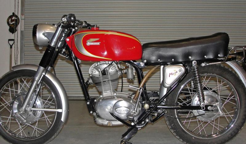

The Ducati Diana has a built-in recycling road draft tube - reaching from the engine to the tail light. This allows vapor to condense and run back into the engine.
steveg; The Ducati Diana has a built-in recycling road draft tube - reaching from the engine to the tail light. This allows vapor to condense and run back into the engine. [ATTACH=CONFIG said:
59040[/ATTACH]
Hi Steve
Long time ago I have one similar to this 175 cc model DUCATI "CALIFORNIA" because have the seat fringed as Western and a knees protection with two chromed clack sons a poor imitation of Americans Motorcycles- but a strong and reliable motorbike
