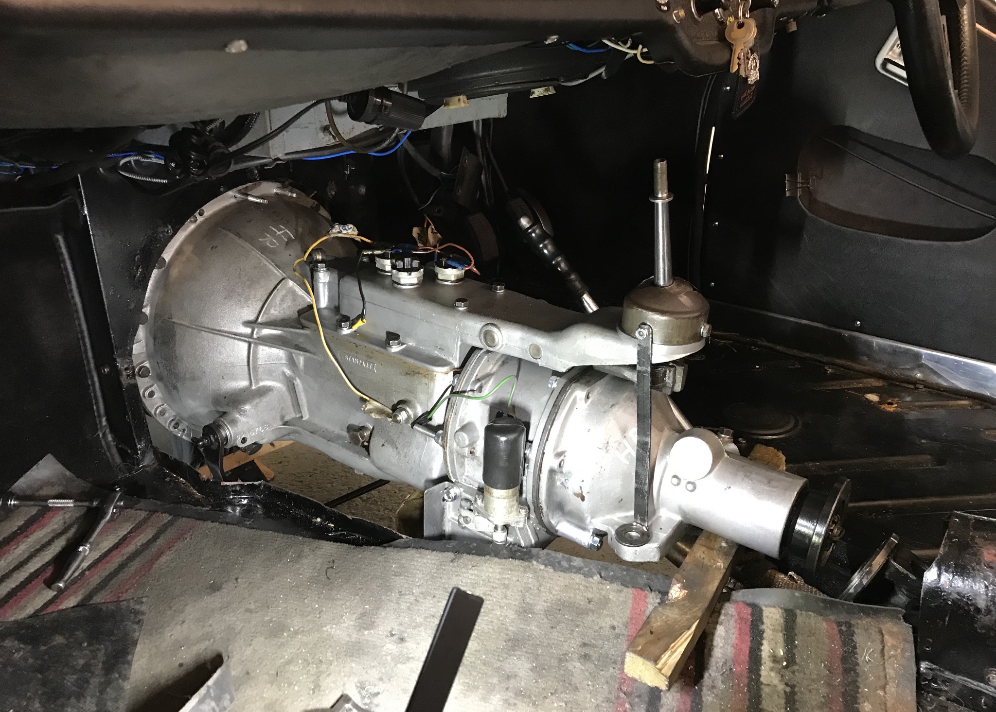

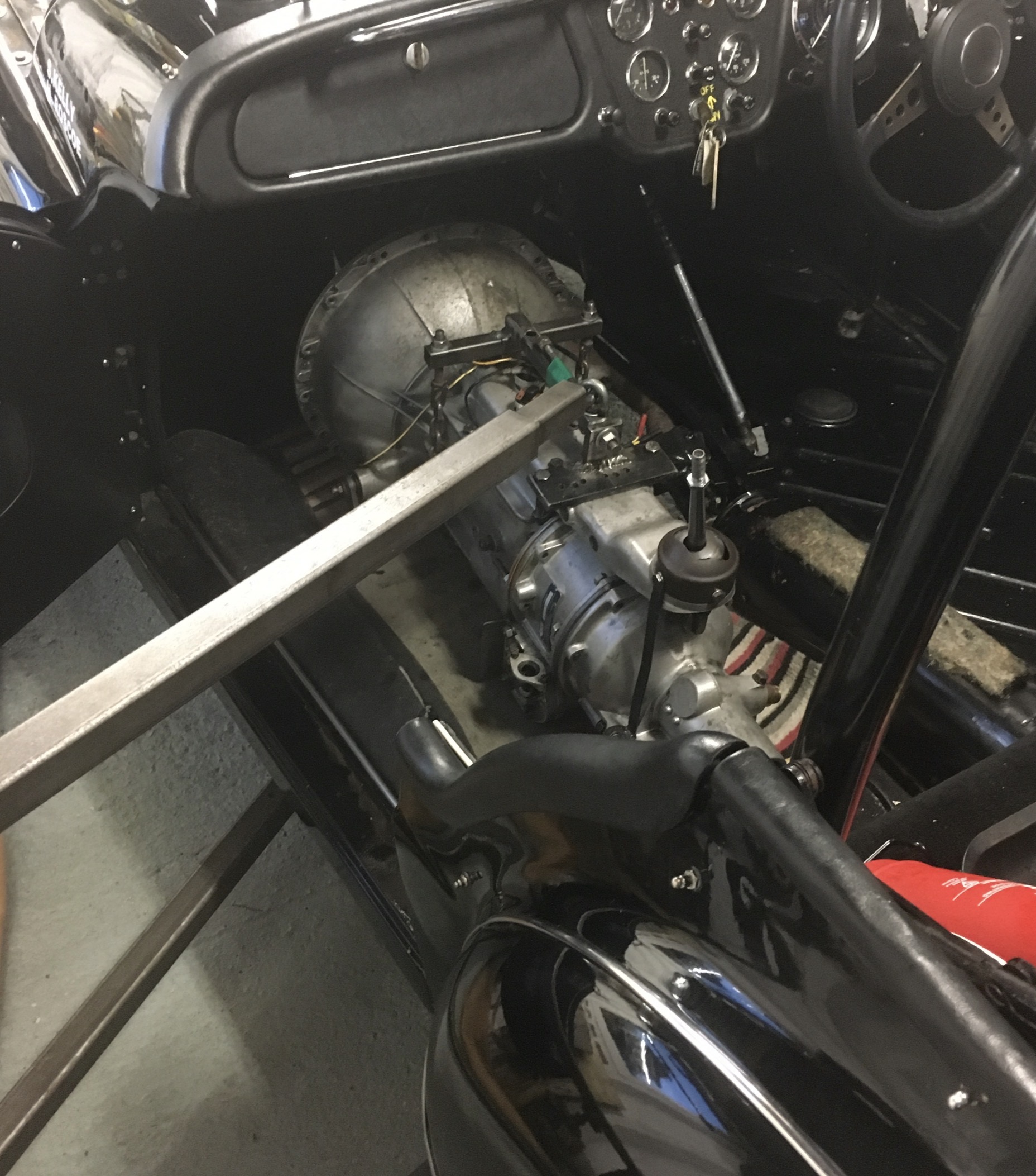

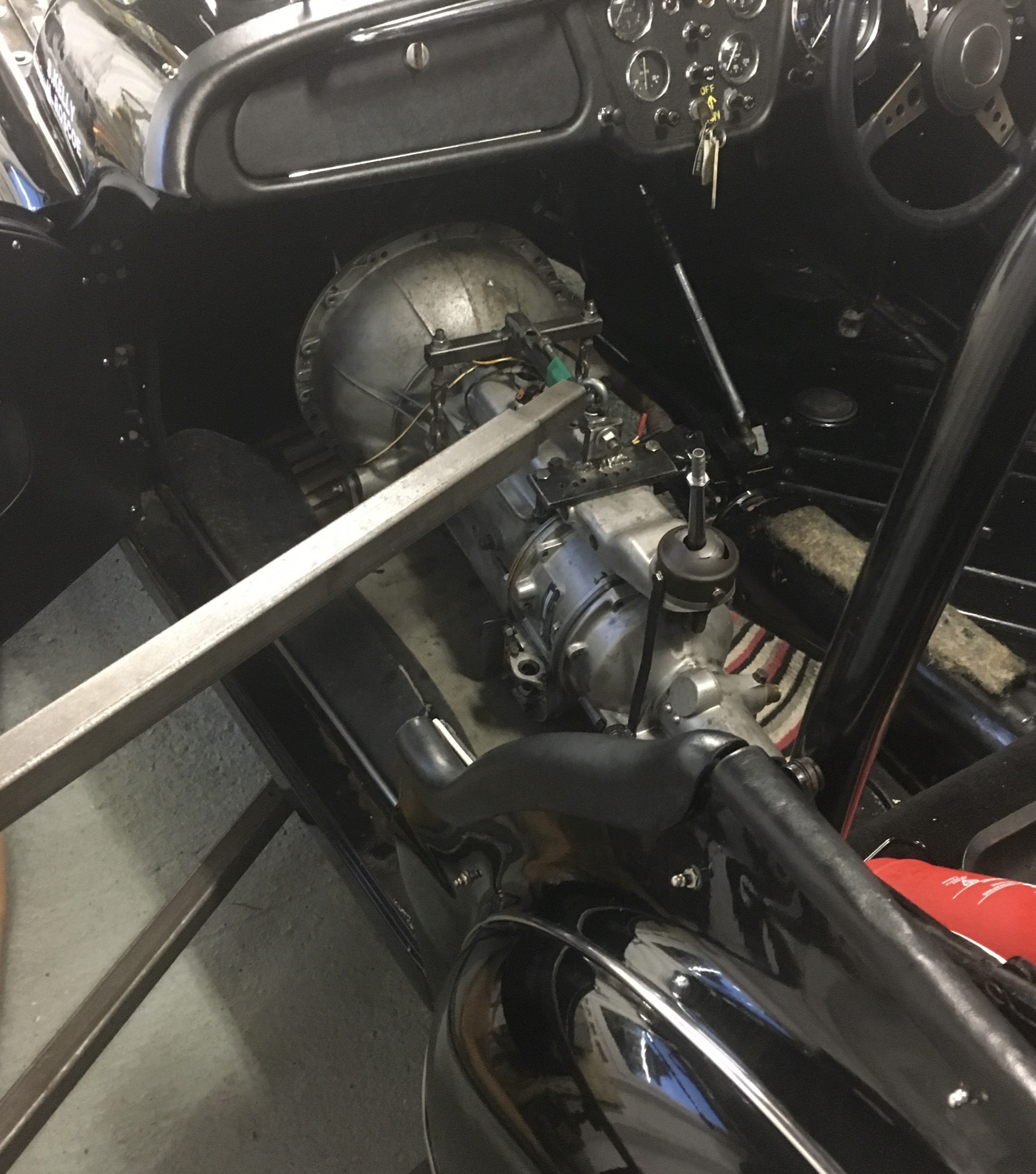

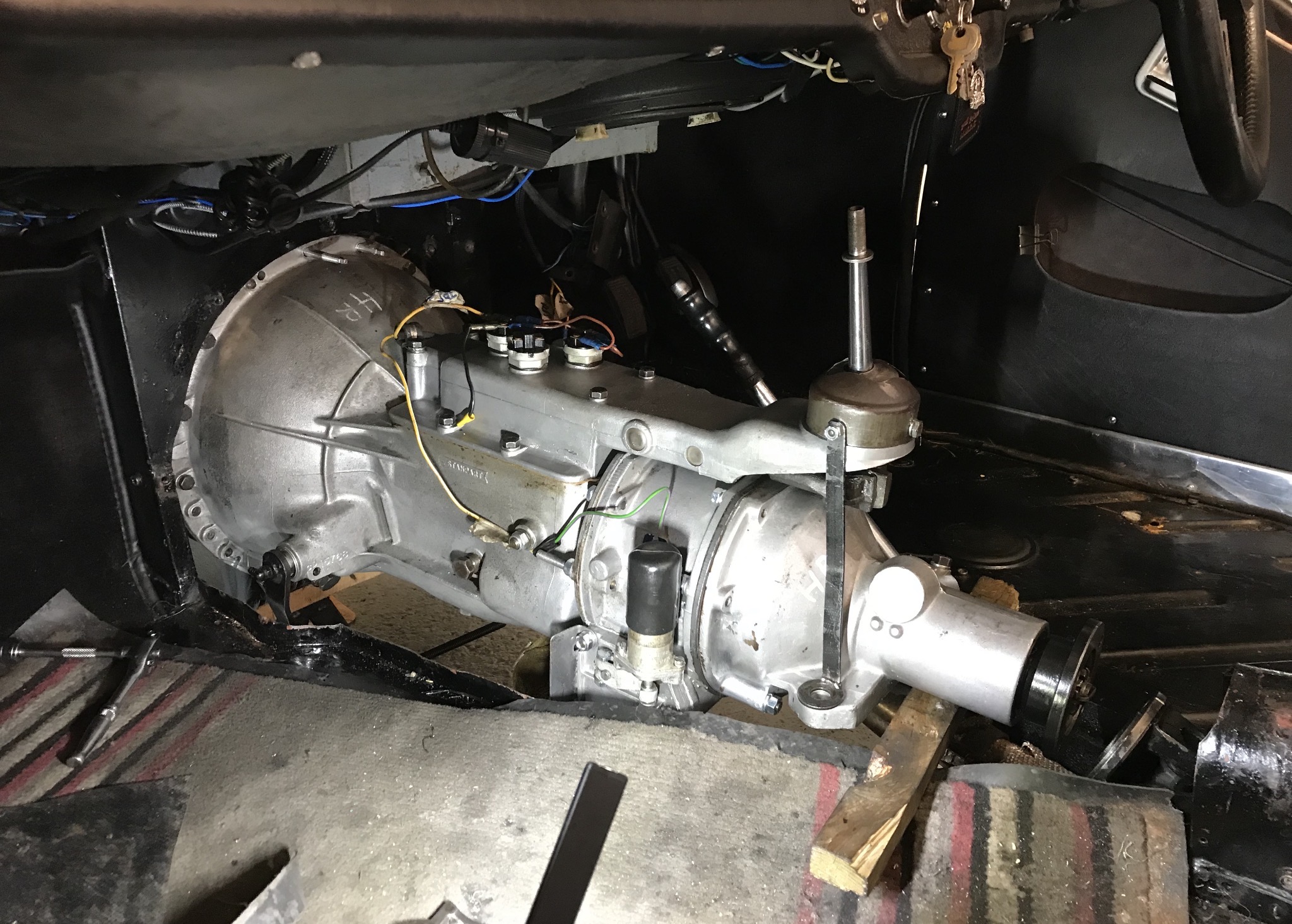

I have had the gearbox out and in my 3a a few times before a complete professional rebuild and I borrowed a crane that a uk TRR member devised. The crane is the best diy tool ever for this job single handed.
Once by myself and I struggled - harder to get it aligned to put it back. And an OD BOX IS BLOODY HEAVY
But I have got the by myself removal down to couple hours.
One with 2 people and it’s so much easier than struggling by yourself

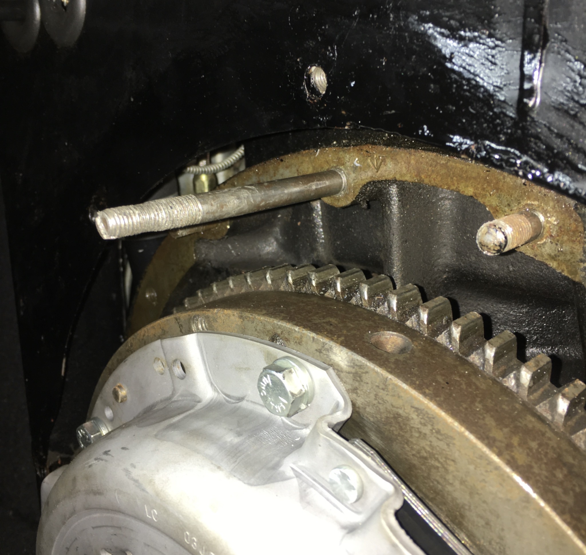

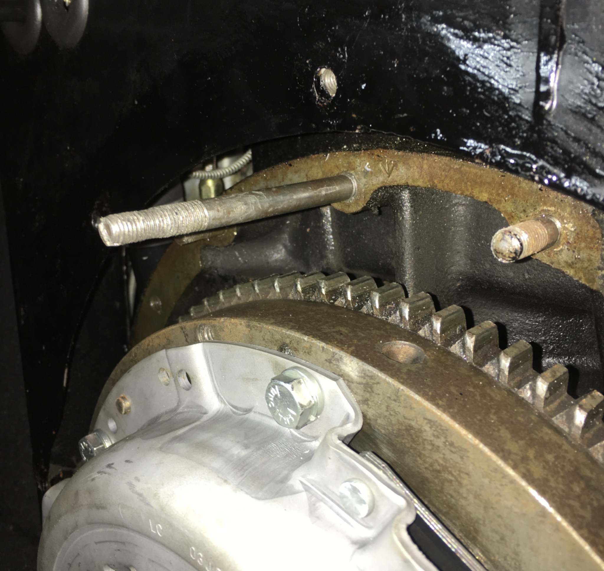

Essential tip is to make a long stud 2-3” to hang the box on (yes the stud and block will take it) to help the refitting guiding back in. Just a bolt with the head cut off and a slot or square end cut to screwing it in and out.
Make sure the clutch plate is centred if you have messed with that.
With the 3a you can chock the engine with a suitably size block of wood between the engine and the bulk head but I use a little trolley jack on the sump again with a wooden board weight spreader.
Also when refitting tie/wire with clutch slide bearing side lever forward towards the bell housing as this keeps the clutch bearing secure in the fork in the bell housing. As there will be some box turning jiggling to get the lever past the floor lip into the void and your really don’t want to get it all fitted to find the bearing has come out of the fork !
And a little wooden block to support the gearbox tail helps too
Note that the block has some dowel pins in set positions. These correspond to tight fitting holes in the gearbox flange. Note where they are and keep then there or replace in the same place these help to locate the box and take the rotational force when driving and the bolts only clamp.

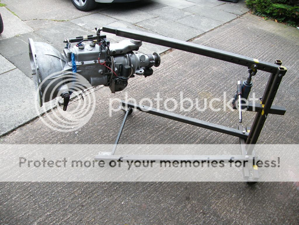

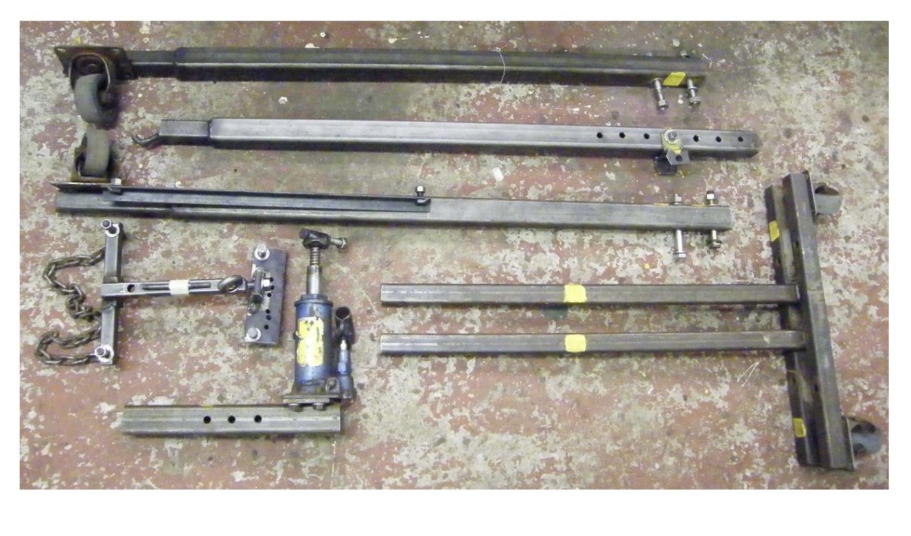

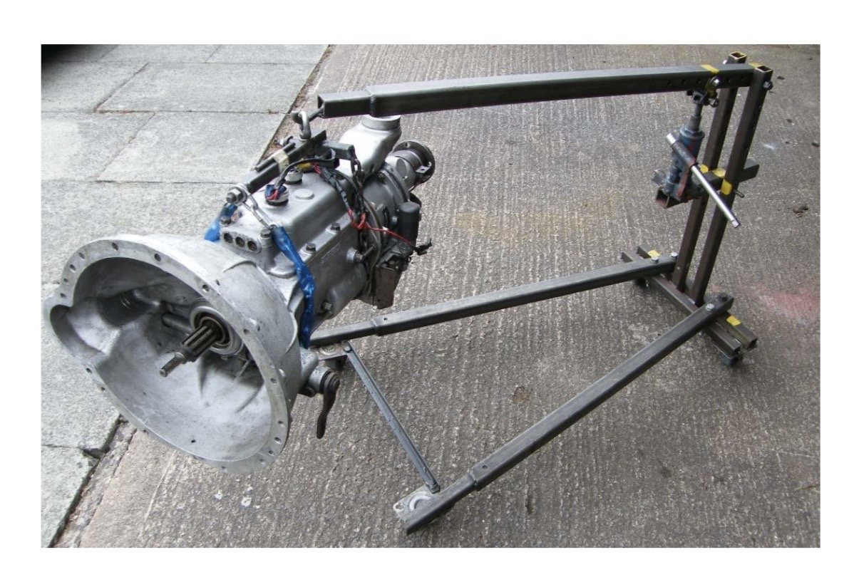

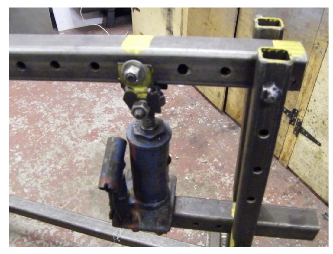

I wish I'd seen this thread before pulling my transmission a few months ago. As a connoisseur of home-made tools, I really admire that transmission jack.
I did it myself, so it's possible, but some help would have been more than welcome. I used a couple of hydraulic jacks, including one transmission jack from Harbor Fright. The biggest problem was to get the box lined up straight with the engine; when I finally got it aligned, it slid in and out easily. I used Hamish's technique of threading a long stud into the engine block to support the transmission as it was removed and installed.

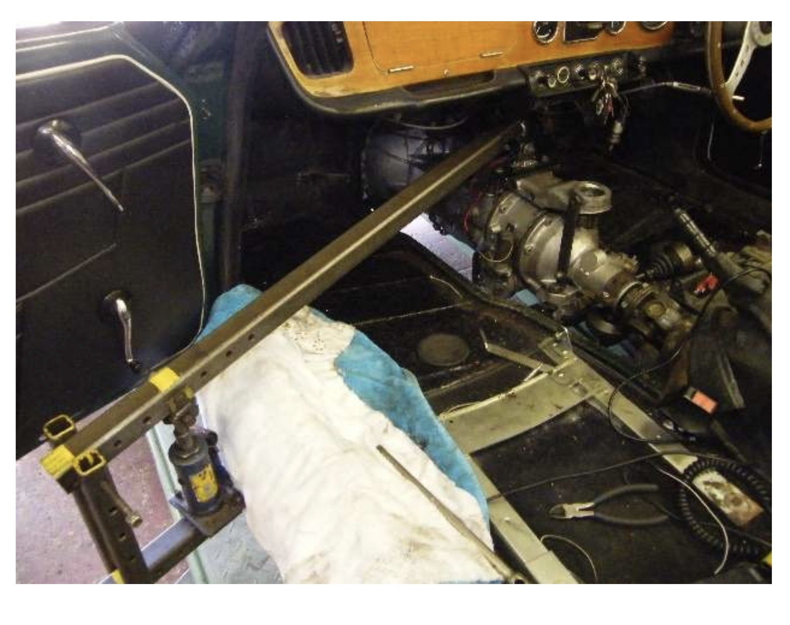

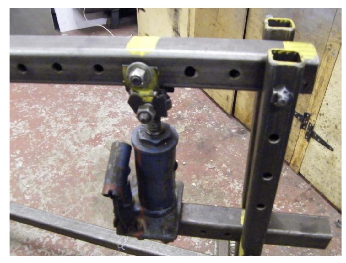

I helped a friend remove his 4 speed gearbox and replace it with the rebuilt 4 speed with OD. It’s really a 2 person job, working on all the fiddly bits, handing tools back and forth, etc. The hardest part was twisting the gearbox down and out from the cockpit; the clutch arm on the left fouled on the floorpan. Lots of humping and heaving. The Dr. Doolin kit really was helpful.

Hamish, I love your lift!

And yes, making a set of 10 (or so) studs to hang the gearbox on as you're guiding it into place is a great tip. You'll need several studs, because if you use too few, the studs will bend. Aligning the gearbox and getting it into the car is awkward the first time you do it. Kind of learning to ride a bicycle or having sex.

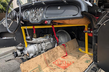

We used thick cardboard to cover the carpet, easy to trim to match contours. His car had a replacement floorpan which didn’t have the cage nuts; made reinstall of the trans tunnel harder for sure. Have fun!

X2 on the long headless bolts, don’t know how I managed before figuring out that trick. I have a custom made set for every vehicle I own (I have a lot of old junk)

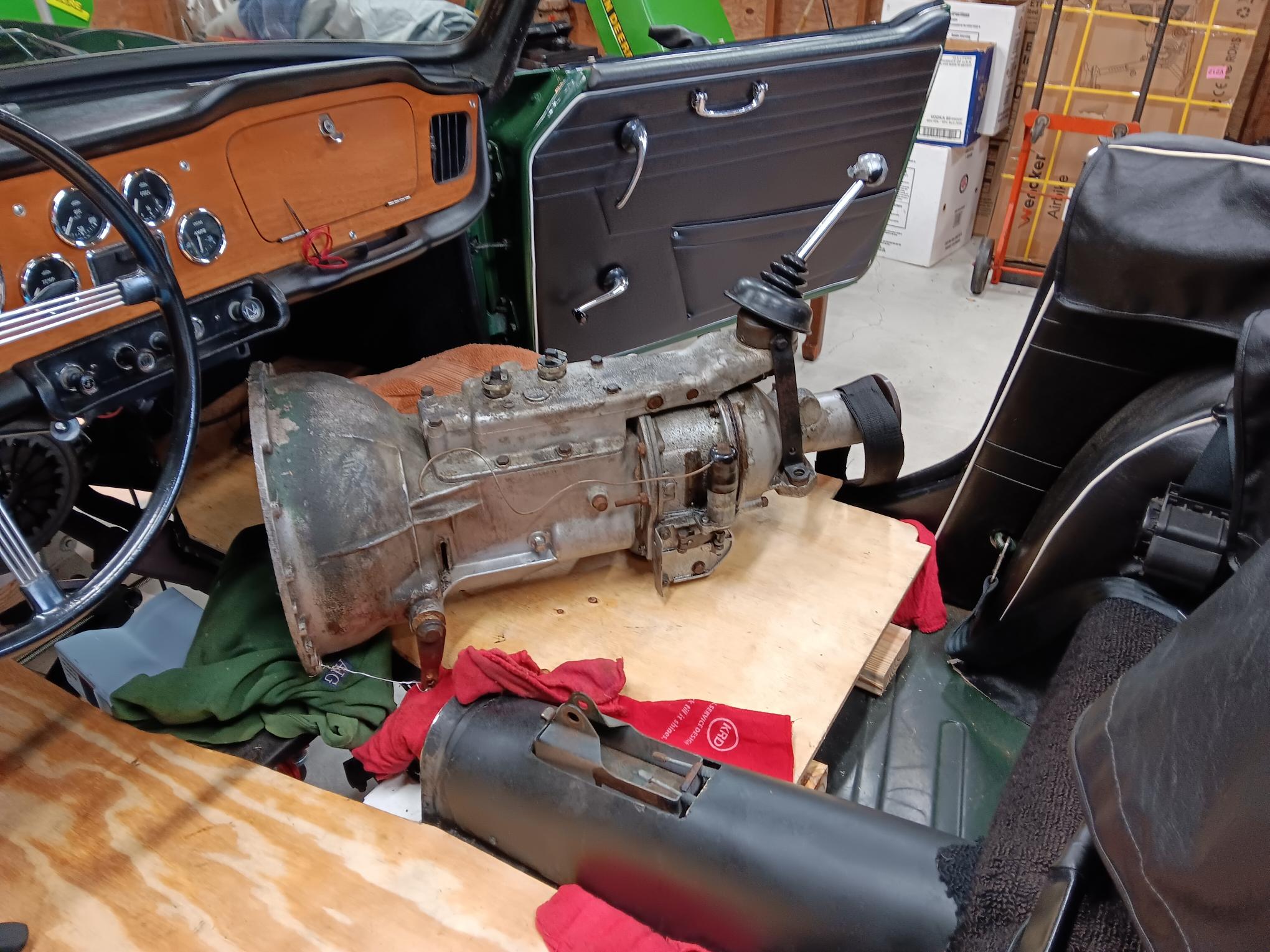

Hi All,

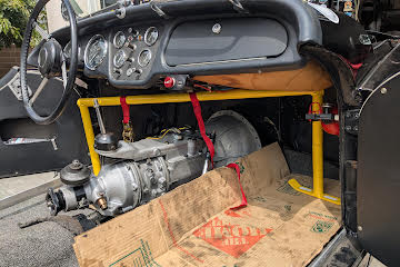

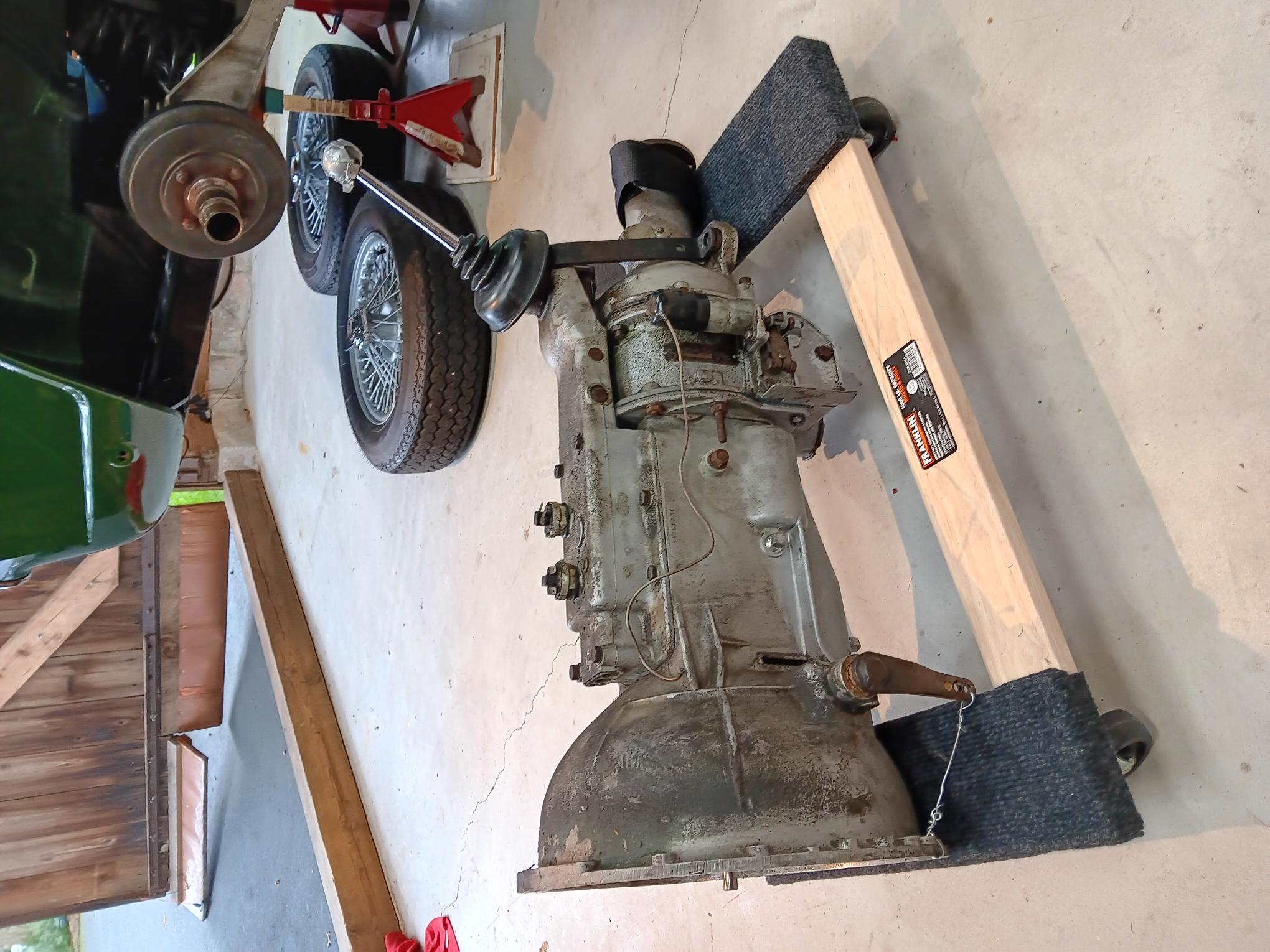

Update - the gearbox is finally out! Kinda a big undertaking for me and had the help of my 26 year old son for the final removal operation. Photos attached. This week she goes to Quantum Mechanics for a rebuild (25 miles from me).
I started hearing a "chattering" sound in 1st, 2nd and 3rd gears end of last season - sure sign the layshaft bearing is failing. Then, beginning of this season I tried to convince myself the sound was "normal vehicle operation" - until I got wise. Then summer got in the way (work, vacation, wife activities, John Deere tractor engine blew head gasket...). Anyway, here we are.
The removal went uneventfully. I drew up step-by-step instructions for myself. Picked up a big scissors jack to support the engine (see post here > TR4/4A - Transmission Removal - Engine Support < ) and a trans jack for the gearbox. Those worked great as I could iteratively adjust the height of both units up & down to finesse the removal. I also used plywood boards (cut to perfectly fit floor boards) for protection. 90% of the job was stripping the interior and setting everything up. Once I removed the fasteners from the bell housing, the actual removal was less than 10% overall time. I found I did not need to remove driveshaft or any exhaust pieces.
Hopefully, you'll be hearing back from me in about 6 weeks when install happens
