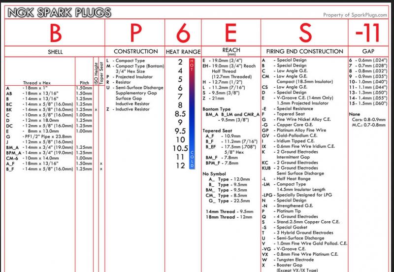

Okay, I'm confused about NGK plugs. I've run BP6ES for years with no problem. I ordered NGK BPR6ES on line thinking they were the same. (R for resister) again no problem. MarkP mentioned BP6ES in his post. What is the difference? What should I be using.
By the way, the BPR6ES box says assembled in Thailand.
What gives?
MarkP
I use BP5ES's which are a little hotter. I'm at 6300' altitude. BP6ES's are a little cooler. Resistor plugs help reduce EMI / radio noise.
