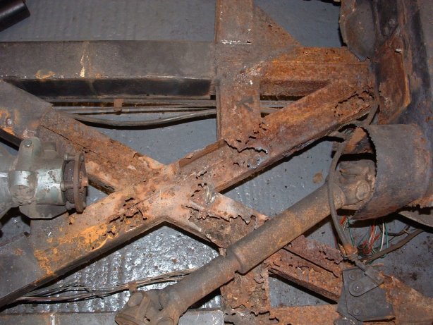

I've found the rust to be too great:
All four ouriggers were rotten and two all but gone.
The front crossmember was split from jacking, the rear had a hole rusted through.
With other odd holes and the PO's brazed patches covering unknown ills. About the only chassis component that seemed sound was the central "X" and buying a whole chassis seemed far better than building around so little of the old.
I count myself fortunate too in acquiring a second-hand new chassis. Someone had bought it for a project, then decided to fix their old one instead. Still not cheap but half what it would have cost new. Taking forever on the project allows some economies to be found, I tell myself....
I estimate that the car will be 90% new- I'm replacing all but for the two shrouds and the bonnet, the front and rear bulkheads, a few other patchable inner body bits and the drivetrain.

Looking at the pictures - new frame for sure.

[ QUOTE ]
Well looking at those pics does mine count as being worse?
I am convinced i need a new frame.
[/ QUOTE ]
Interesting rust pattern - looks like soaking floors and carpets over many years and rusting downwards. Was this a re-import back into the UK ?
