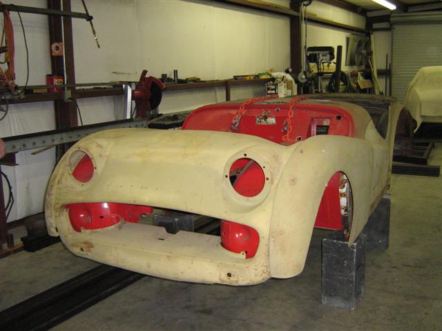

Fenders and panels being pre fitted before media blast and final body work. Then the paint goes on.
This project is taking so long I've forgotten how to post pictures. Chech out the link to the blog. Paint is going on and assembly is happening. It will likely be complete just in time to park it for the winter
