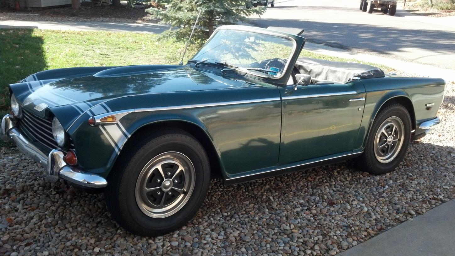

Here is CD8138C - all stock - I purchased out of Wyoming last year from the 2nd owner who had it for 37 years:
This is still in Colorado - have not yet brought any of my Triumphs to Alabama to keep me busy when not slaving away.
