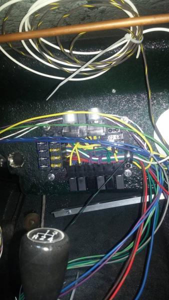

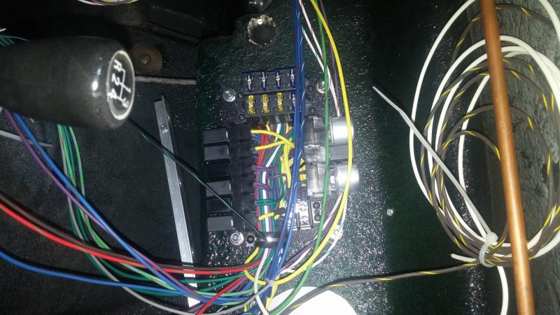

Well, I had things pretty well sorted out (I thought), and actually had the gauges registering properly after we got the engine running. But then for some reason (maybe the bulk connector...) the gauges froze and could not be reactivated. Even though I had previously sorted and run all the wires, including those going to the headlights, tail lights, horns, etc., and tested all to be sure each was in its place, I decided to pull all of it and start over - this time with a proper wiring system. A friend had a complete, unused Advance Auto Wire setup that he didn't need, so I bought it from him. If you're not familiar with this, it is a very high quality item designed by a friend over in Maryville whom some of you may know of - Dan Masters. And some of you may remember his son, who was once a member of this forum, Mike Masters, who died several years back.
Anyway, the Advance Auto Wire is a very nice package which includes relays, modern fuses, a complete "PowerBlock" panel, and all wiring following proper MGB color coding. More here, if you want to know more: https://www.advanceautowire.com/ It's mostly installed as of today, though not hooked up; hope to get at least the dash components hooked up in the next day or so, and then can move on to getting to the rest. And will have several holes in the firewall to fill, including the two-inch one for the bulk connector which will be trashed.

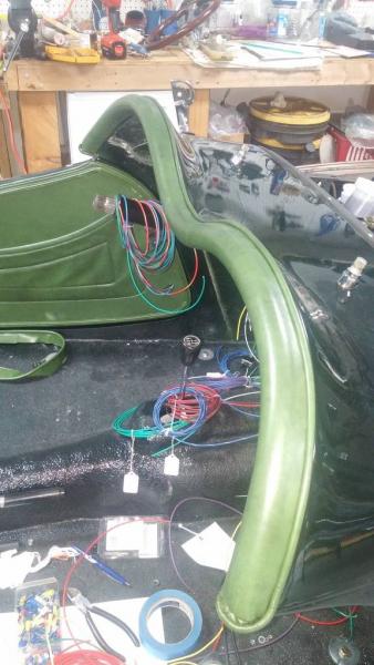

Speaking of the dash, I did get the crash rail completed and installed. This is a curved plywood structure that has a rubber core that you glue in place. I managed to get the rubber part glued on, but covering that thing with the green leather proved to be too daunting a task for me. I tried a couple of times, and rather than ruin a good piece of expensive leather, I decided to take it to a professional; glad I did, because it turned out fantastic!

How the heck you could figure all that out is beyond me. I'd have ripped it all out and started over about an hour after I got a car with wiring like you inherited. I remember my first old Mercedes, where any wiring changes were done with black wire (or green wire, or ...) regardless of the original. You must be so psyched about getting the car closer to roadworthy. Yeehaa!

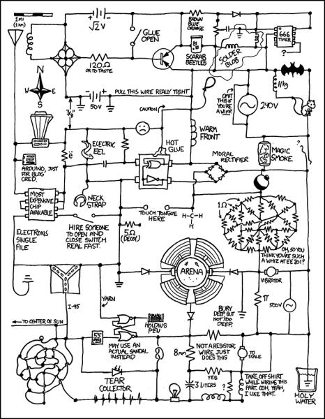

Next time you have wiring problems, here's a diagram which may be helpful.

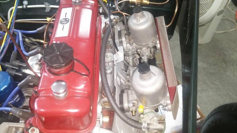

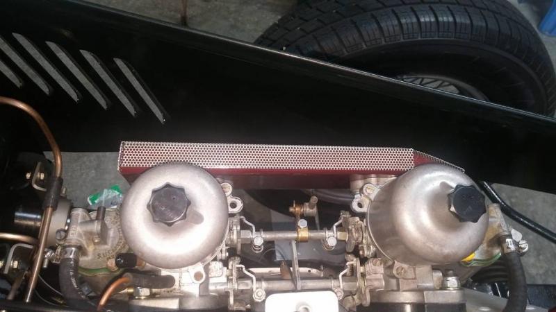

Oh yeah - forgot. Also think the air cleaner problem is solved. We made a housing out of sheet stock and wrapped it with perforated steel. Will fill it with aluminum mesh from a filter for a kitchen exhaust fan. Not the most elegant solution, or the best filter media, but given the clearance restriction due to the side panel, I think it's the best I'm going to come up with.

Mickey: Your wiring woes are very familiar; don't know what I'll do with the "new" project as I hate to put too much money into it and knowing I have some big expenditures coming up down the line such as paint, seats, interior, top and side curtains, etc. At least the wiring is exposed at this point. Like your air filter solution; is the gap at the forward edge really as great as it looks in the picture? What are the dimensions and is it perforated on all sides except the base sitting on the carbs? Did the crash rail myself and it was a pita. Keep up the good work! J.D.
The picture is misleading, as the side panel is unsupported. Once it's attached to the other half of the panel, it is pulled in closer to the carbs than the picture shows. That's why this was such a problem. And the perforation is on the back of the housing and fully across the face, if that makes sense.
Mickey: Not sure I follow you; it appears the top (as mounted) and the leading edge are perforated; is the flat side facing the side panel, bottom and rear edge also perforated? J.D.
Mickey.....I'll bet you can find a flat automotive air filter of the appropriate size at your local parts store. So many new cars use a flat, pleated filter they come in many, many sizes.
The housing is u-shaped. Back, top and bottom are solid; leading (front, slanted) and trailing (rear) edges are open. So the open area faces the side panel. The perforated metal is wrapped around the housing, which is why it appears to be open; if you look closely, you can see the burgundy metal behind the perforation on top.
