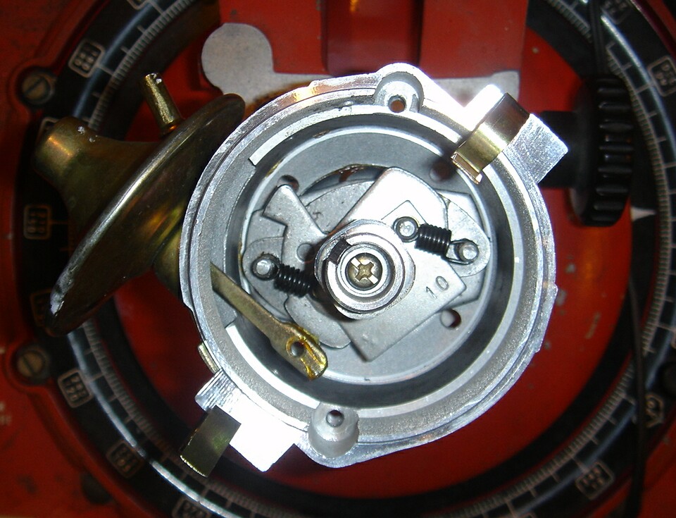

I just wanted to post some new info on the Pertronix Flame Thrower distributors. I bought 2 of them last week - both came off of the same shelf with the same part numbers. One had 12 degrees of advance, and the other had 10 degrees of advance. They were both supposed to have the same advance curve, and they were both very different, but there's good news! The one that had a 10 degrees of advance was using a tremendous performance advance curve - the same one that I discussed with Carl Heidemann a few months ago and the same curve I put in my performance B distributors.
It seems that Pertronix is repairing the problems with the standard Moss distributor - to a point where I would be comfortable running it in my own car. They don't short out my testers like the unit from Moss used to!
I attached a photo of pertronix's modified advance mechanism. Note the new "stop" installed along with a few brass bushings and better springs.

Tony, pop the advance plate out of it - the new timing stop that Pertronix installed has the amount of advance stamped into it. Or just drive it! Most people aren't going to feel the difference 2 degrees makes anyway, unless its a daily driver.

"""""""both came off of the same shelf with the same part numbers. One had 12 degrees of advance, and the other had 10 degrees of advance""""""""
So did both units have an advance plate marked 10* ?
If so, that tells u something right there......there should be more consistency. A diffrent curve? Then different springs/weights?

I just took it apart - the plate is stamped "12" and the springs look the same as the springs in every Lucas distributor I have taken apart. IMHO - it is at least as good as a Lucas unit, and no wear - yet!
