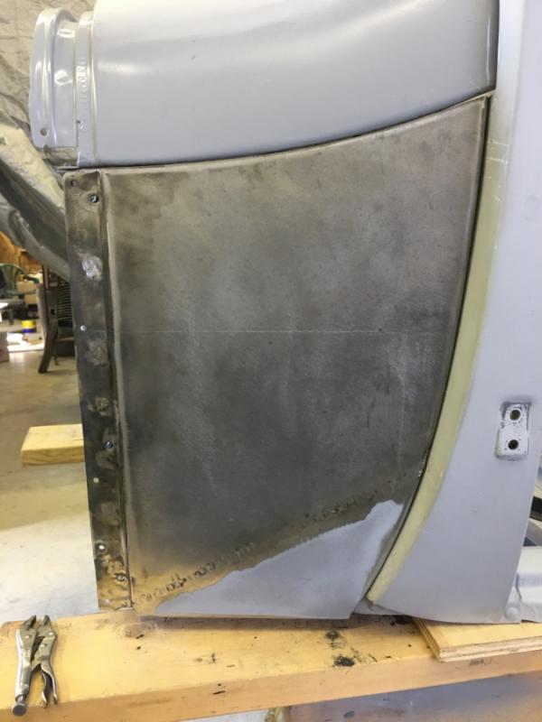

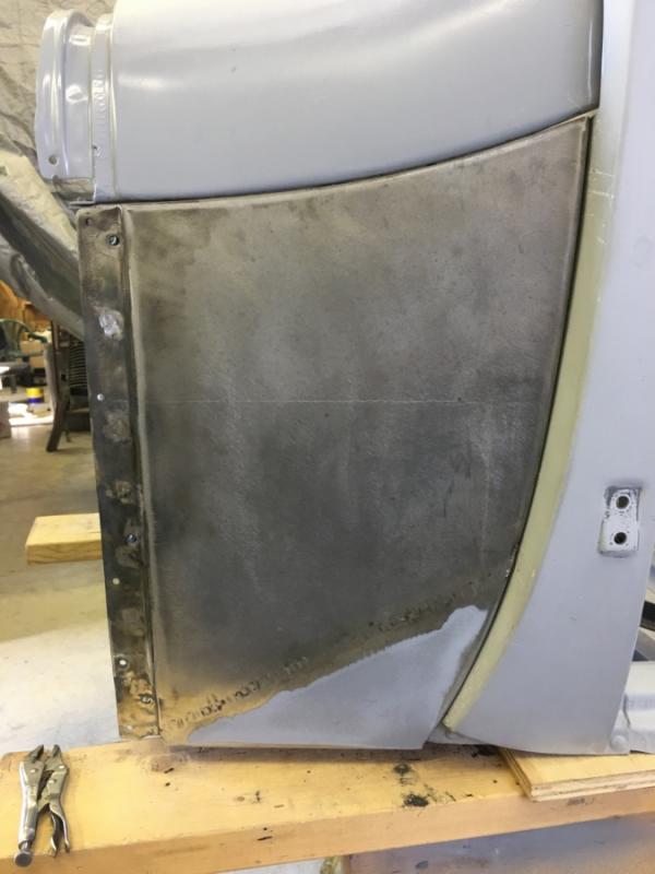

There has been a lot of work over the last few weeks and the body with all its bits is now ready for top coat. that is all but the side cowl pieces below the gas tank. The bottoms of both pieces were badly rusted and we bought new replacement panels. When it came time to fit them up, they did not fit very well. I decided the best plan was to cut the rusty bottoms off the original parts and replace with the bottoms of the new ones. Fortunately the shop now has access to a MIG welder but yours truly has never used one. Over the next week or so I had to teach myself how to do it. I learned that grinding that stuff takes a whole lot more time than welding it. Anyway, this is how the left side looks, now ready for some epoxy primer. The other side is similar but I did show the better of the two.
I tacked it in place while on the car then finished the weld from the back side. LeftCowl.jpg

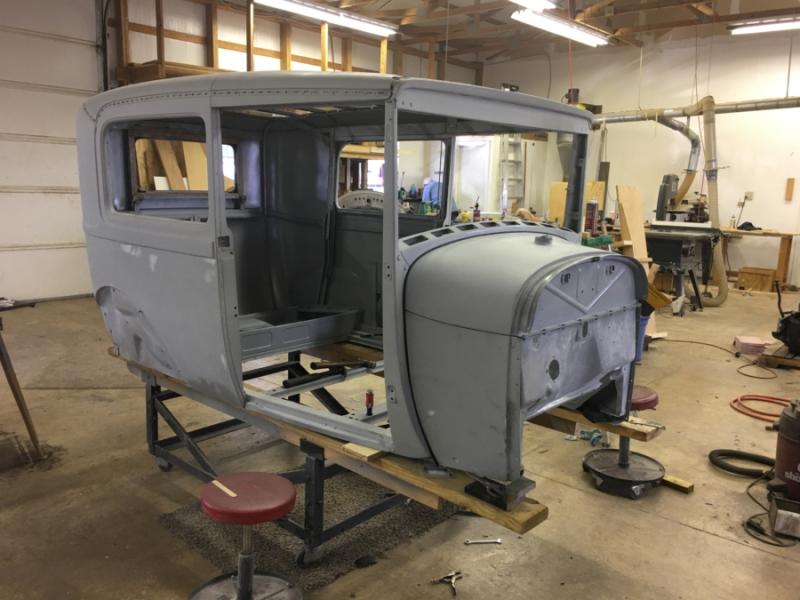

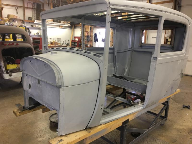

We finally got the firewall/gas tank/cowl sides assembled and attached to the body. This was necessary because the welting where it meats the body is supposed to be painted body color. I like it black but I understand. Assembling that thing after it is all painted would very likely result in some scratched paint. It was a fair challenge for two of us to get it together. With that done, the whole thing is now ready for final painting. Now if we can just get some proper single stage paint, mixed to the original color.
CowlLeft.jpgCowlRight.jpg That's my Prefect with the missing boot lid on the left of the second photo.

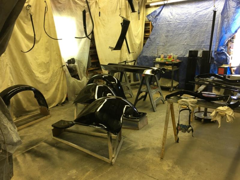

Over the last few weeks we got the engine and transmission reinstalled on the chassis and got the brakes all installed and semi-adjusted. I say semi adjusted because all the rods for the mechanical brakes are individually adjusted; there are no equalizers in the system. Dick wanted to convert from the original steel brake drums to cast iron. That required the services of a machine shop. We now have a full set of tires and the wheels are a week overdue from the powder coating shop. Meanwhile, I did get all the black parts painted today. this includes the fenders, the splash aprons and a whole bunch of miscellaneous parts. Here is everything in the paint booth.

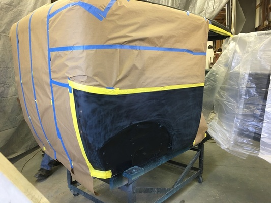

It turns out I had too much in the paint booth and some pieces too close to the floor as a result. Bottom line was, I got to do those fenders all over again due to orange peel or thin paint. With them all polished up and looking good, we got the body and hood and all the other parts painted and polished. All except for one more flaw, that is. When polishing, we found another thin spot about the size of a fist on the lower right side just before it starts to turn to the rear. The photo shows the body all masked and ready to respray that section although you probably can't see the flaw now that it is scuffed to 600 again. The other photo is the panel above that one, now covered in masking, with yours truly's selfie. I was trying to show off the paint, not my own ugly mug.
