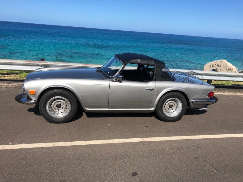

Hi All, In 1993 I towed this 1973 Triumph TR6 home. It sadly sat rusting away until 2010 when I retired and decided to restore it with my limited skill and knowledge of British cars. Today all body work has been completed, a new coat of paint, and new soft top; interior needs lot of work. My goal now is to work on getting the engine to run smoothly. It is, however, road worthy. I will be reaching out for your assistance with your years of experience and knowledge. Regards, WJKB-TR6

Hi WJKB-TR6 and welcome to the British Car Forum. You will find plenty of friendly help with your TR6 whenever you need it. Post your questions in the "Triumph" section of the forum anytime you need help.
Your car looks great.... I also have a '73 TR6. I noticed that you have the bumper overriders; I didn't think they were introduced until 1974?
Hi Gliderman8, Thanks for the Welcome note. I will be adding Posts in the "Triumph" section (appreciate this!) once I get the hang of how things work here. Yes, mine do have the bumpers and it was manufactured late May 1973. I am not certain, but think it was manufactured with the bumpers so they could be sold in US starting Year January 1974????? Need to check history on that. I surely have questions on how to make my engine purr like a kitten.
