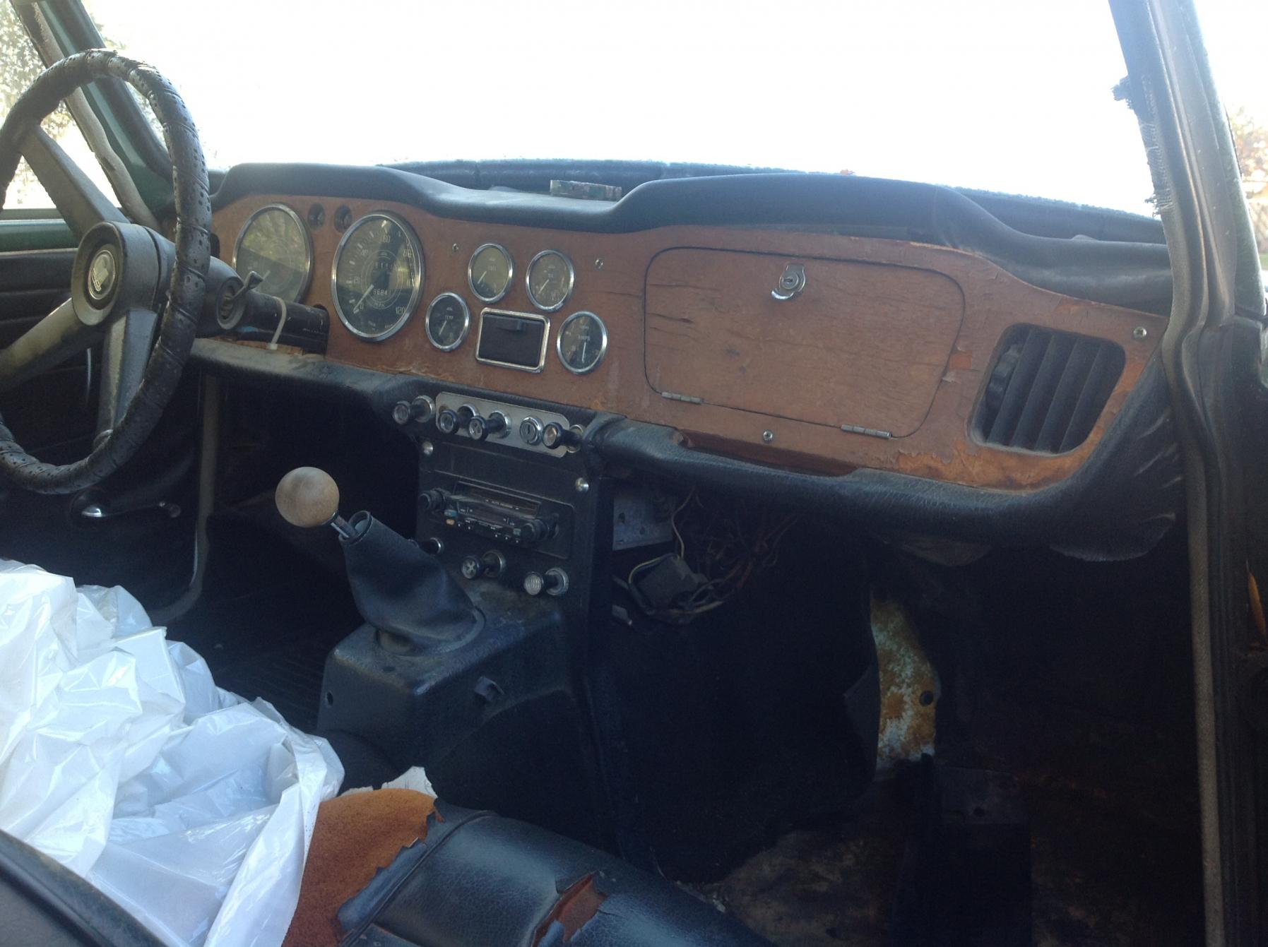

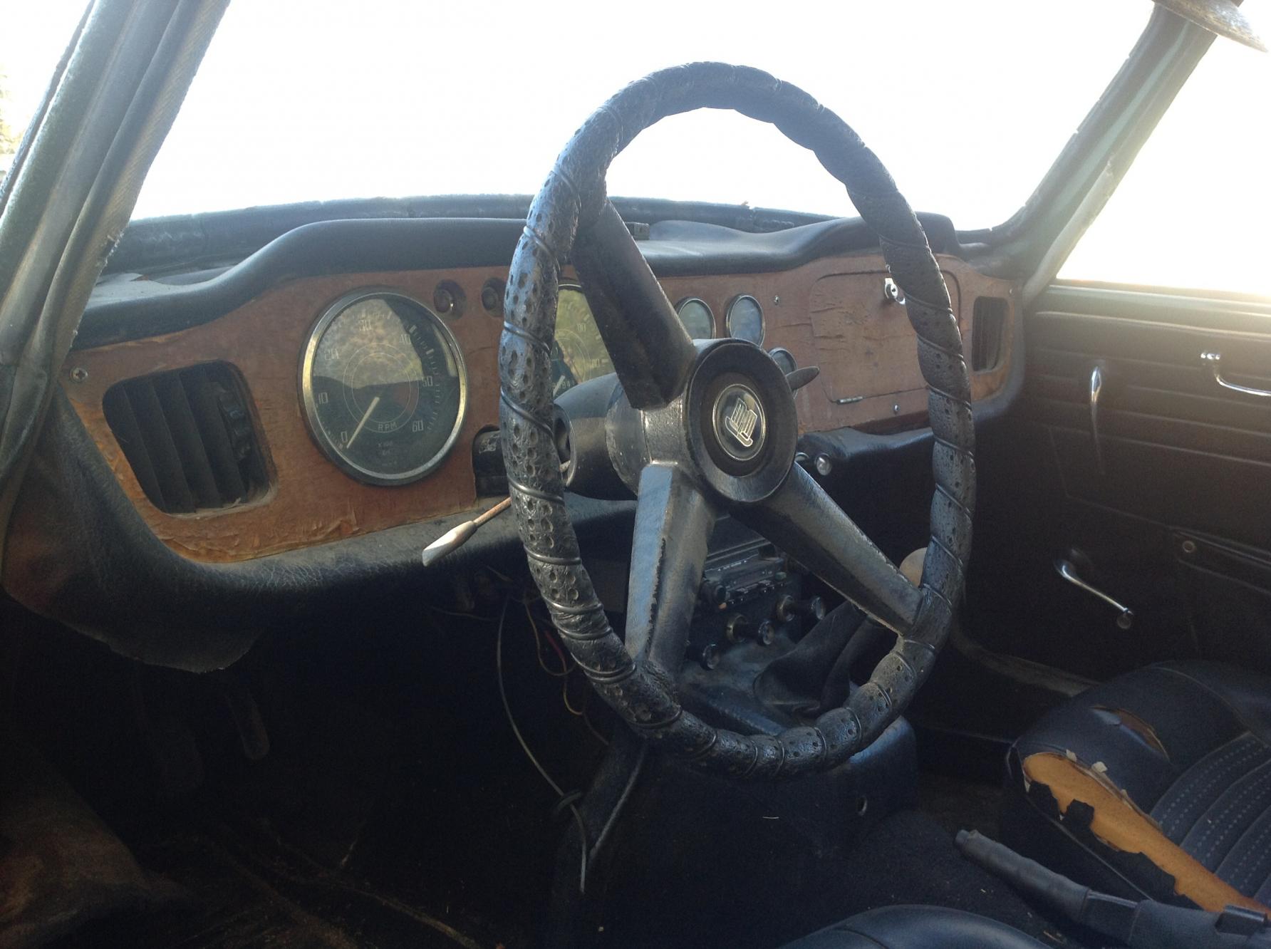

So here are a couple of pics of the interior. Don't mind the opacity of the windshield. It's just frost from this morning. 24* F. Brrrrr

Looks like 4A with the center dash support surrounding the shift lever and knob configuration. I think plate behind key area was added. Looks like no padded window sills but NBD. Steering wheel obviously changed. Thats what I see right off.
Looks like a TR4 since the headlight switch is on the plinth and not the steering column. That column switch on the left is the OD switch. I believe the owner said it had OD and that's where the OD switch is located on a TR4. This car was built from 2 and taged as a 4A is my belief.
Nope. No OD on this one. BTW, what is a plinth?
Jerry,
Why do you think that's overdrive on the column and not the normal TR4A lights and turn signal? The TR4 light switch is normally on the dash to the left of the column and not on the plinth. Looks like a TR4A setup to me.
Scott
Jerry,
Scott
I thought the owner said it was an Overdrive car. If it was an OD car the OD switch on a TR4 would be on the left side of the column. Turns out it's not an OD car so I was wrong. That switch did not look like a TR4A light switch to me. Looking at it now and counting the switches across the plinth it looks like a TR4A dash setup without the correct center plinth. Really a mixed up car.

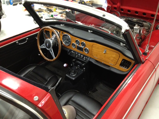

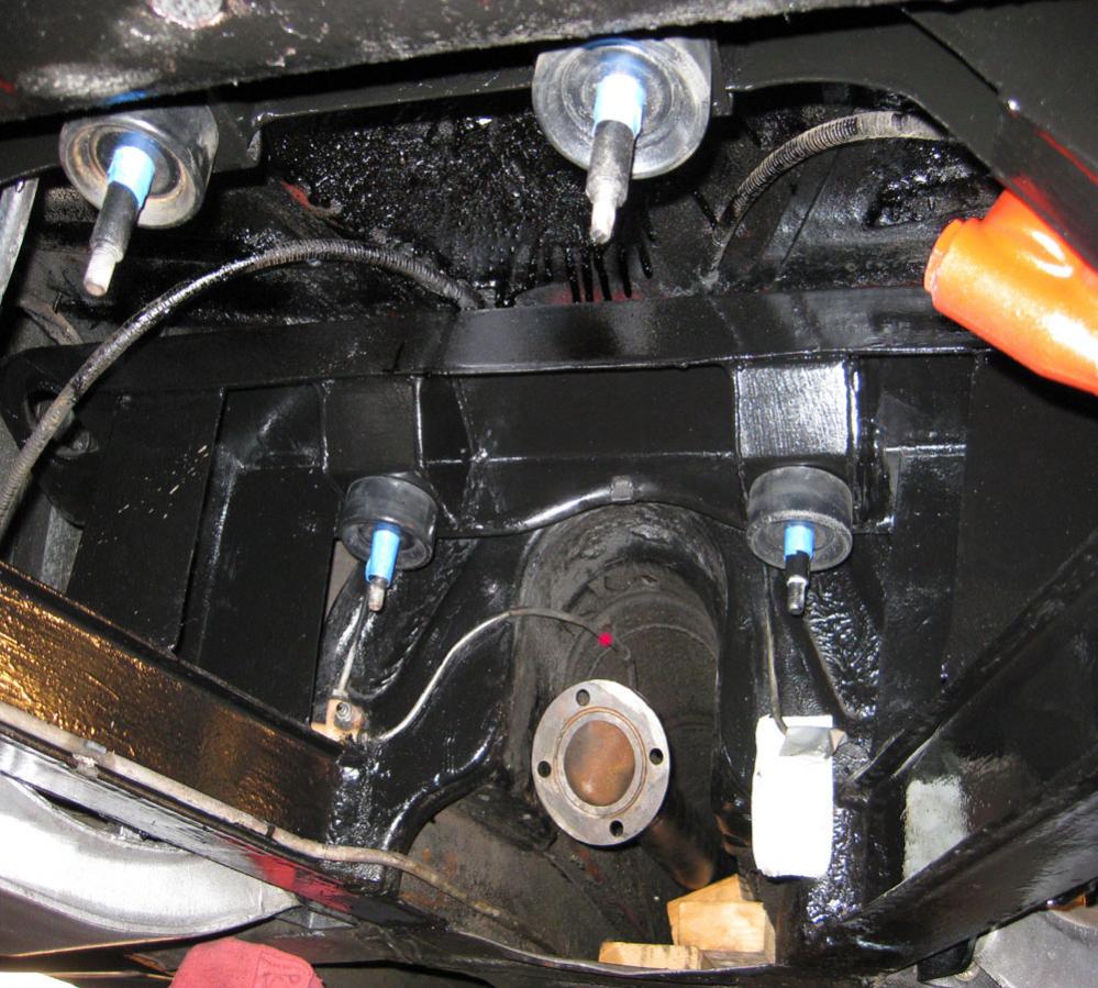

My little Moss book would say it's a 1966, not 1967, if I'm reading it correctly. If you go slowly you could get it back in line, closer to its original heritage. On EBAY you can get the correct steering wheel and Moss has the dash parts. You could do miracles to that interior cosmetically, but it may cost you $1500 or so, depending on whether you replace the seats and carpeting. My concerns would be the frame and the rear differential bridges. Look for rust. My 4A looked immaculate underneath, but had hairline cracks in the differential mounting plates, and the story is that many old IRS models need welding work on the rear bridges, particularly the front one where the pins go through. I've attached a pic of mine just for reference. Just a guess, but I'd say it either got hit or had fender damage and someone found a pair and didn't bother with the 4A fenders. Your emergency brake is also 4A. Did you post any engine pics? Just another thought: My first TR4 went to Flagstaff. I'll always remember the young guy who bought it telling me it's a tough town to own a British Sports Car in the winter if everything isn't sealed and perfect. I'm also enclosing pic of what I did to my interior (it didn't take all that much time; just patience and care not to make anything worse).
