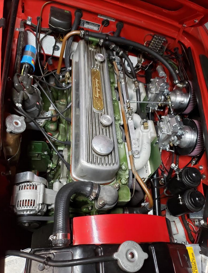

Gallery of my installation: https://www.pbase.com/stevegerow/dmd2inch
I have the twin DMD intake manifold using 2" HD'S on the race car. I got the float bowls and the newer style of floats from Burlen in the UK. Joe Curto rebuilt the carbs with the new bowls. He had done one other set up with a customer/friend of his using the DMD intake. Everything works well.

If you're referring to the DMD, I've been running it for years. Am in the process of converting to Mikuni HSR 45s.

Did a dyno run with a friend who has an identical engine, except his has stock exhaust, intake and HD6 carbs. Mine also has Kirk headers. His was 110 rwhp, mine 130.
I did it just to have a different unique setup.
Besides the manifold (available from the Healey Factory in OZ), you need vertical float bowls. The engine mounts need to be shimmed up about 1/4" for the rear carb to clear the steering column. I also banged a dent in the spot of contact on the column., but 1/4" ought to do it. I built a rail for the throttle linkage mounts.
Rear air cleaner needs an extender to clear the slanted frame rail.
See: > DMD Air Filter Mods by Stephen Gerow <
I installed the manifold & headers at the same time, originally with the HD6 carbs. Pretty sure HD8s are unnecessary but the manifold is designed for them. Got a pretty good seat-of-the-pants improvment.
