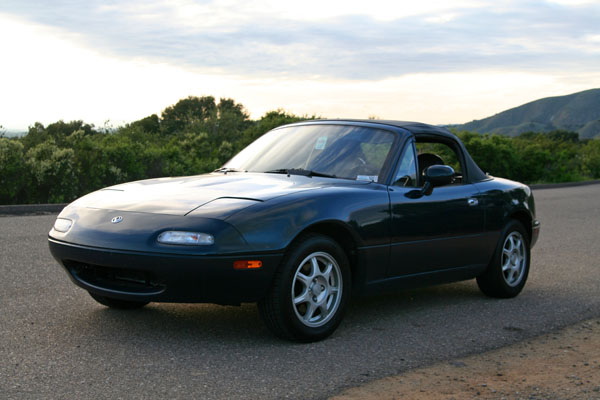

The Miata is truly a wonderful little car. I'm not about to pull the transmission out of mine to do a fit check, though! The 6-speed manual was not available until the NB (1999 I believe).
