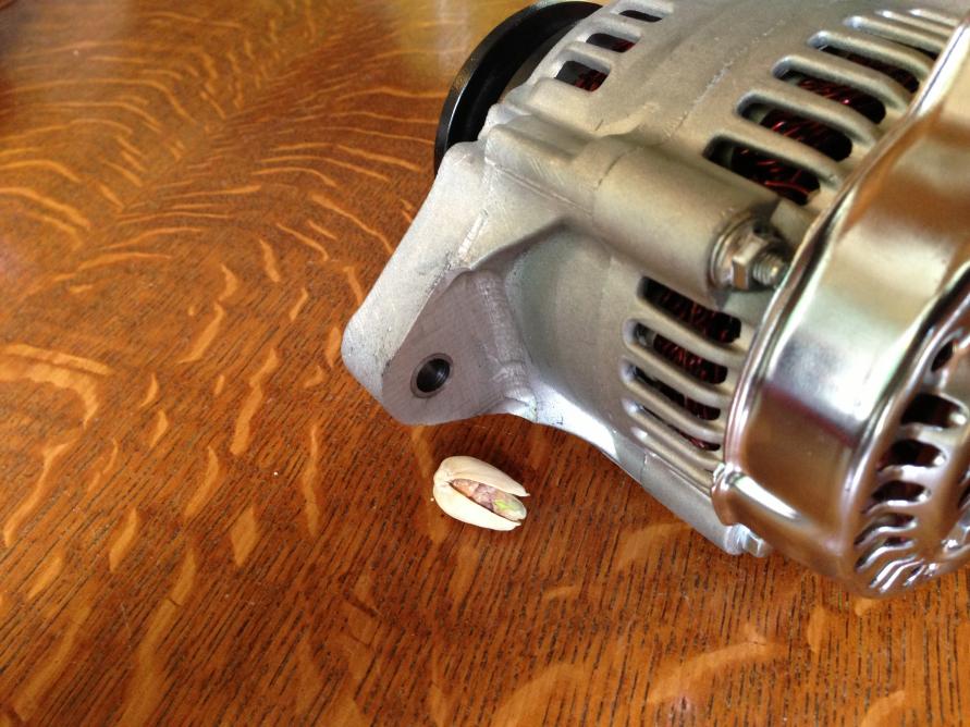

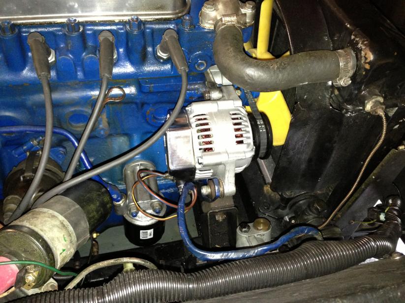

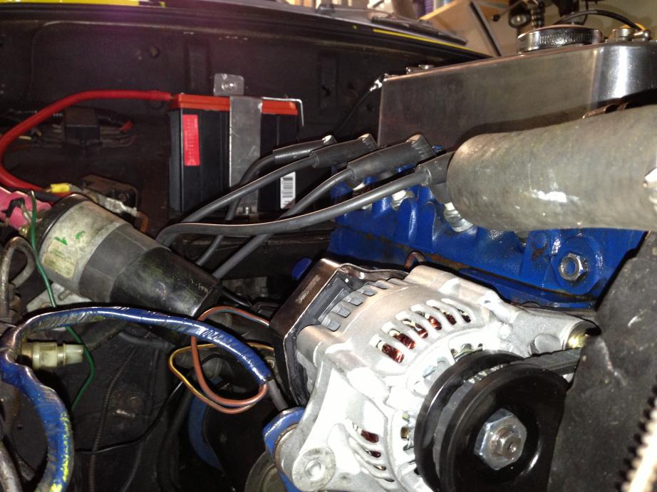

Just got the mini alternator. It needed some modifications to fit. Again, I had to mill down (this time the appropriate) pivoting lug by a few mm. Also had to machine a bushing to reduce the 10mm hole to 8mm to fit the 5/16ths bolt hole on the engine side. Threw a pistachio in there for scale. The last pic shows the miniaturized electrical system together.
Is that alternator internally regulated? If so 1 wire or 3 wire hookup?
