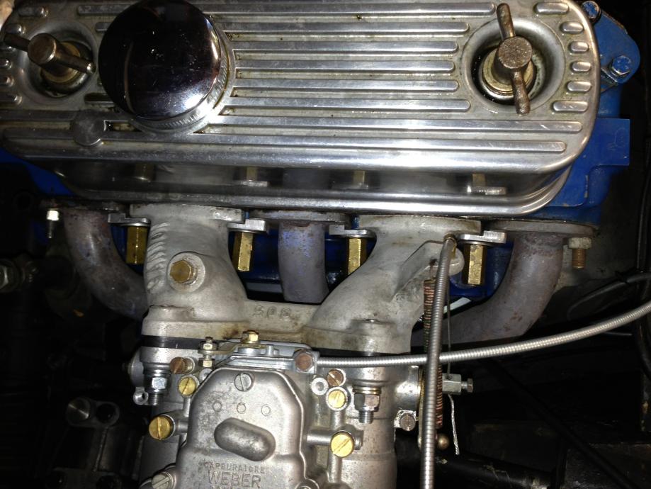

Got a 45 Weber (thanks bug sixty!) and found the intake manifold flanges to be thicker than the header flanges.

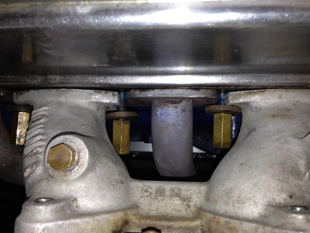

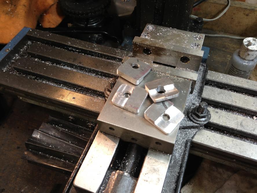

So I milled some aluminum stepped washers to compensate for the 3.3 mm difference in flange thicknesses. Added stainless washers to spread the pressure from the manifold nuts. Hope the Al doesn't crack.

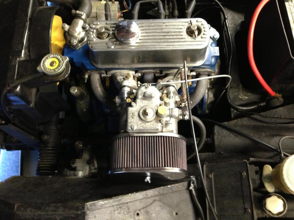

Engine fired right up. Throttle response is instantaneous compared to the SU carbs. I think it was hard on the belt because now I've got a shreaker that needs to be replaced. Tightening it didn't mKe much difference. It cut my carb tuning session short.

Instantaneous throttle response is a DCOE trait. Overall power increase usually a little over SU's. Tuneability not nearly as easy!

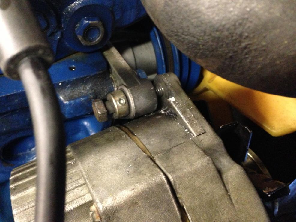

Alternator sat too far forward, so I milled down the mounting lug a few mm. Belt looks okay, so I'm wondering if the mispositioning put additional strain on the alternator bearings, and maybe that's the screeching I hear. I'll find out tomorrow when I replace the belt and button things up.

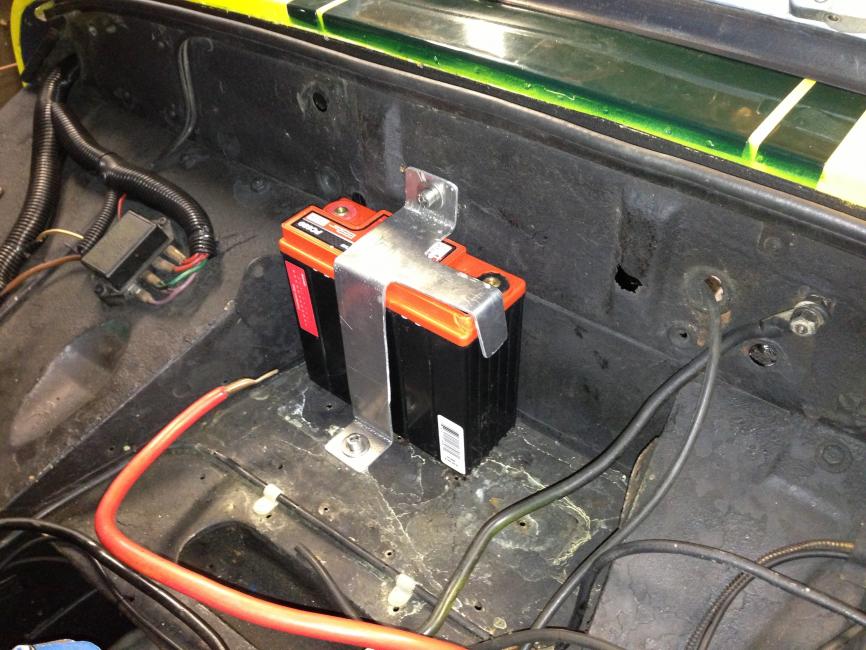

Went from a 50lb. Diehard to a 15lb. Odyssey. Had to make a tie-down bracket. Still need to clean up the wiring.
