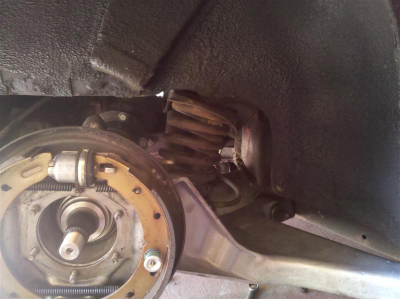

new CV half shafts
All we need now are the pictures of the finished products and those shiny new CV joints.
here is a pic during the reinstall process, all finished now, took the 6 out for a spin last night, no more TR6 Twitch, runs nice, quiet, and its faster, well maybe mentally another project comes together thanks Brosky let me know when your package arrives

I am also waiting on Brosky to do it so I can read his great detailed instructions on How to do it, thats why it only took me by mself, except for my hot girl friend bring me a cold beer, only about 8 hours to do it including smoothing out the trailing arms and soda blasting them

I'd like to know how you decide between the new CVs the uprated sliding axles with the heavy duty U-Joints. I note Goodparts offers both.
Also, I don't understand how smoothing out and polishing the trailing arms could really be doing much to strengthen anything?? I'm curious what physics would be at work there.
I'd sure like to see the pics of the CVs installed.

by smoothing out the casting flash and blending out nicks and sharp corners, you remove stress risers. a stress riser is a local area in a part that if the part is under stress a crack can form at that area and cause the part to fail. so removing stress risers make the part less likely to fail. If you have Roger williams how to improve book look on page 23, those areas at a minimum need to be smoothed out

OKAY, so the original axles were sliding ones which allow considerable play around corners and over bumps in the road.
How much play and give do the CV axles have? Will they be more harsh on the frame and other parts?
I would think the CVs should have the same play and movement, but I'd like to know what others say.
thx
I am not sure if they have the same amount of play or sliding in and out compared to the originals but there are instruction with the CV axles and you do a couple of checks to make sure you have whats call reserve. basically when the trailing arm is at full extension like when you jack the car up that the joint doesnt slide out of its coupling and full compression like when trailing arm hits the upper rubber bumper the sliding joint doesnt bottom out before full compression on the trailing arm, on the CV axles the in and out action happens in the black housing that mounts to the differential see pauls web site. the outboard joint only swivles for lack of correct terminology. hope this helps
Hondo
Both the rzeppa and the tripost bearing design constant velocity joints are improvements on the old design... Lots better as far as friction transfer, not wasting energy and have full movement... Only concern is the sizing of the joint for the application and maintaing the veracity of the boots, so that road detritus does not get in the joint and contaminate it.
