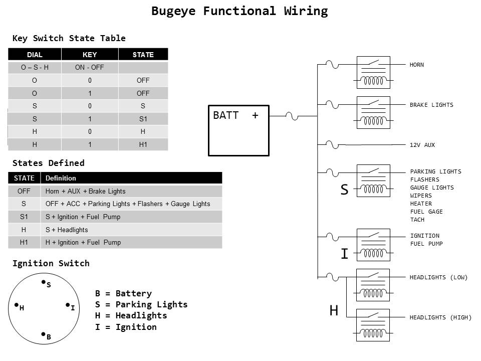

This is I hope not a hijack however, I will likely need a hot rod harness for the Vauxhall as I can't seem to source an original and mine are mostly wrecked. How do you determine how many circuits you need? I presume that you would want more than the original few. But, is there a way to calculate?
"Calculate" is a strong word. I broke mine down by major function and draw. I ended up with 6 circuits as shown in the attached pic. I might split the flashers and parking lights to their own fuse. and if you have a radio it would get its own.
