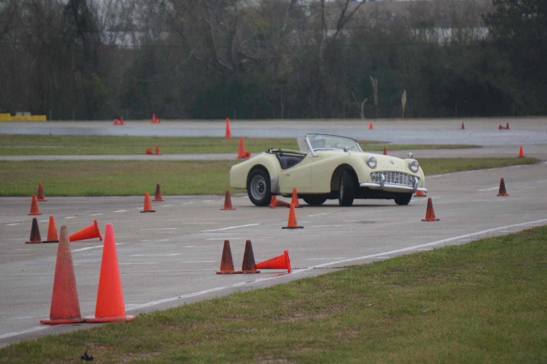

Whats 4 seconds among friends? I did not skip any sections. Also, I'll have you know that I did not knock down any cones all day (that I am aware of), nor do any of the few hundred pictures Bob took show a cone under my car. I think Randy is clear in that regard as well. However, this is my favorite picture. It's slightly out of focus, but it is raining. You can see how close I came to the last hair pin curve gate -the rear end actually slides around the cone. That is a tough act to follow! I am now convinced my TR3 runs as good (or better) than new, but doubt it moves my title up to "Mr". -I'll stop stealing the thread now...
